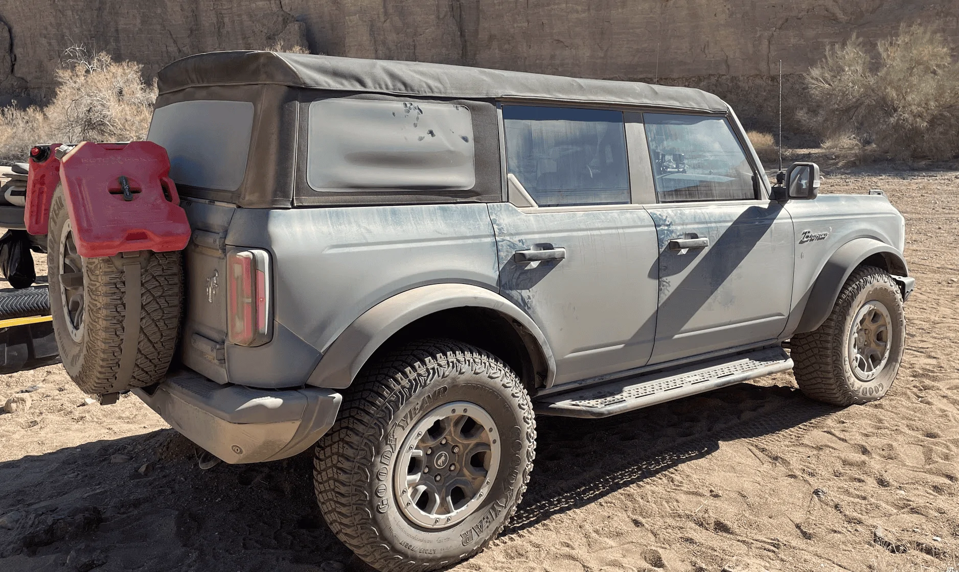

Looking to add side steps to my 4dr SAS Badlands and remove the rock sliders. Will use the rock sliders when necessary but would need the steps to also be sliders. Not opposed to power steps either. Looking for recs and any pics if you've installed any.
IAG Performance has steps that bolt right to your rock rails, easy on and off 🤠

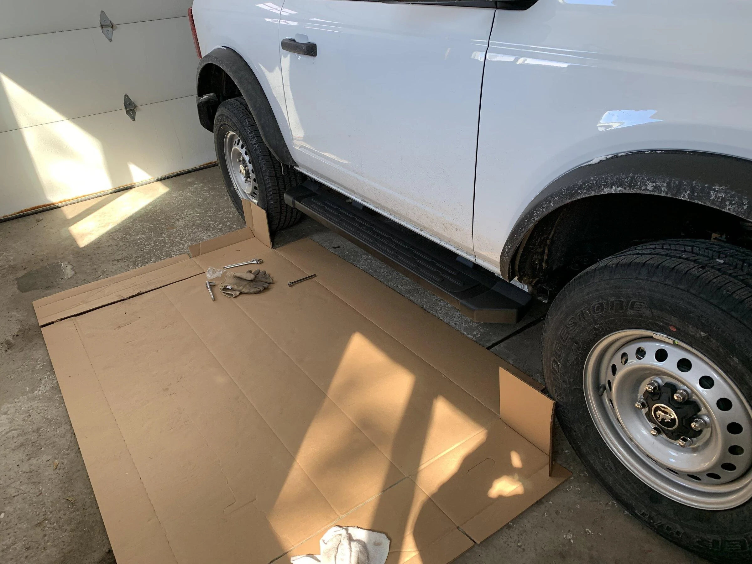

I installed the Ford OEM sidesteps. I used my Ford Pass points to reduce the cost to about $285. I’m happy with they way the look on my 2 door Base.

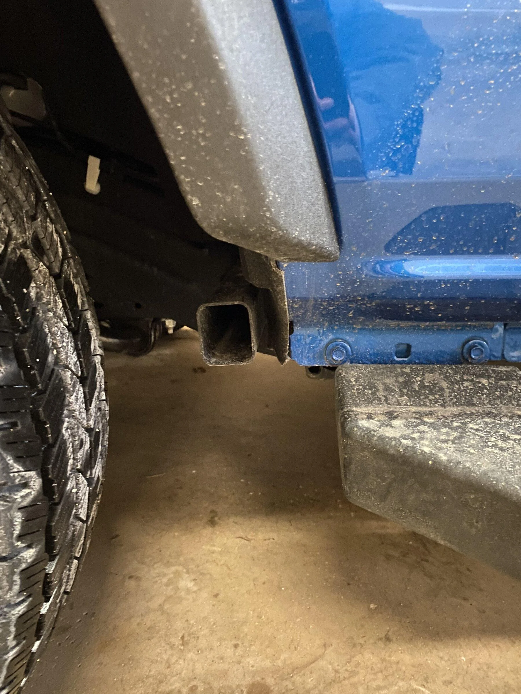

I ordered my Bronco with the side steps for an easier entry/exit and to help from road damage to the rocker panel, and I like the look, too. Unfortunately, I had to reposition them rearward two-plus inches to allow for clearance for OEM mud flaps.

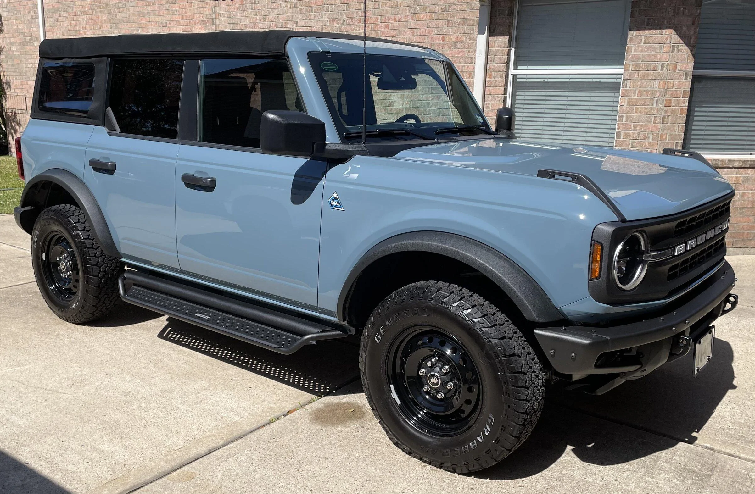

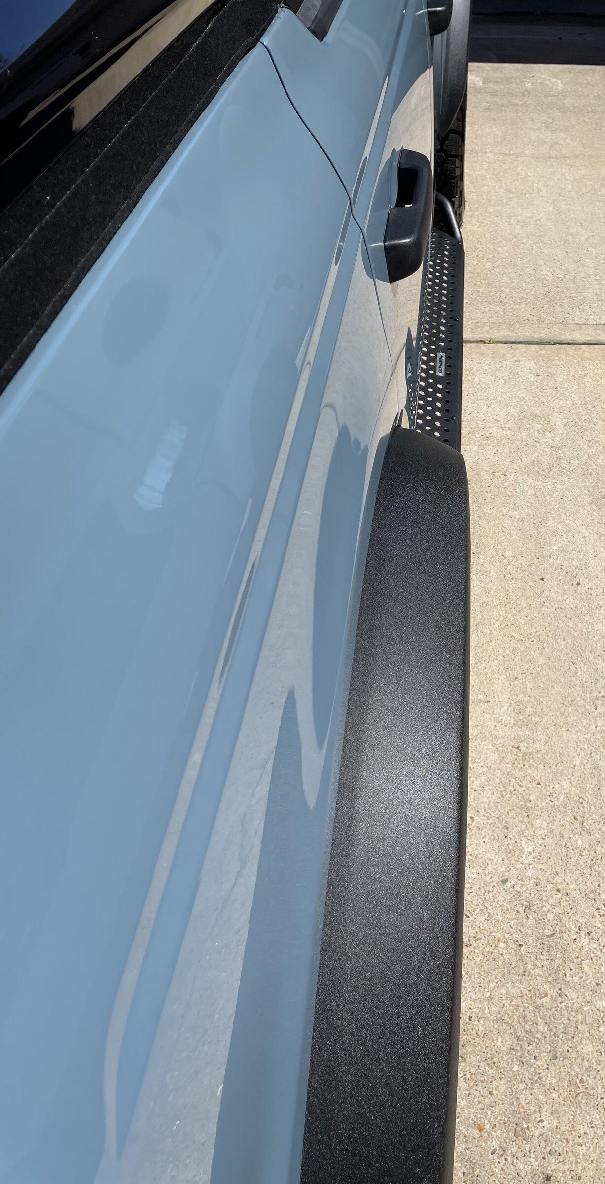

I finally had the time to install my D1 steps. They provided the step-down my wife was looking for and enough "door ding" coverage for my concerns. They almost exactly line up with the edge of the wheels.

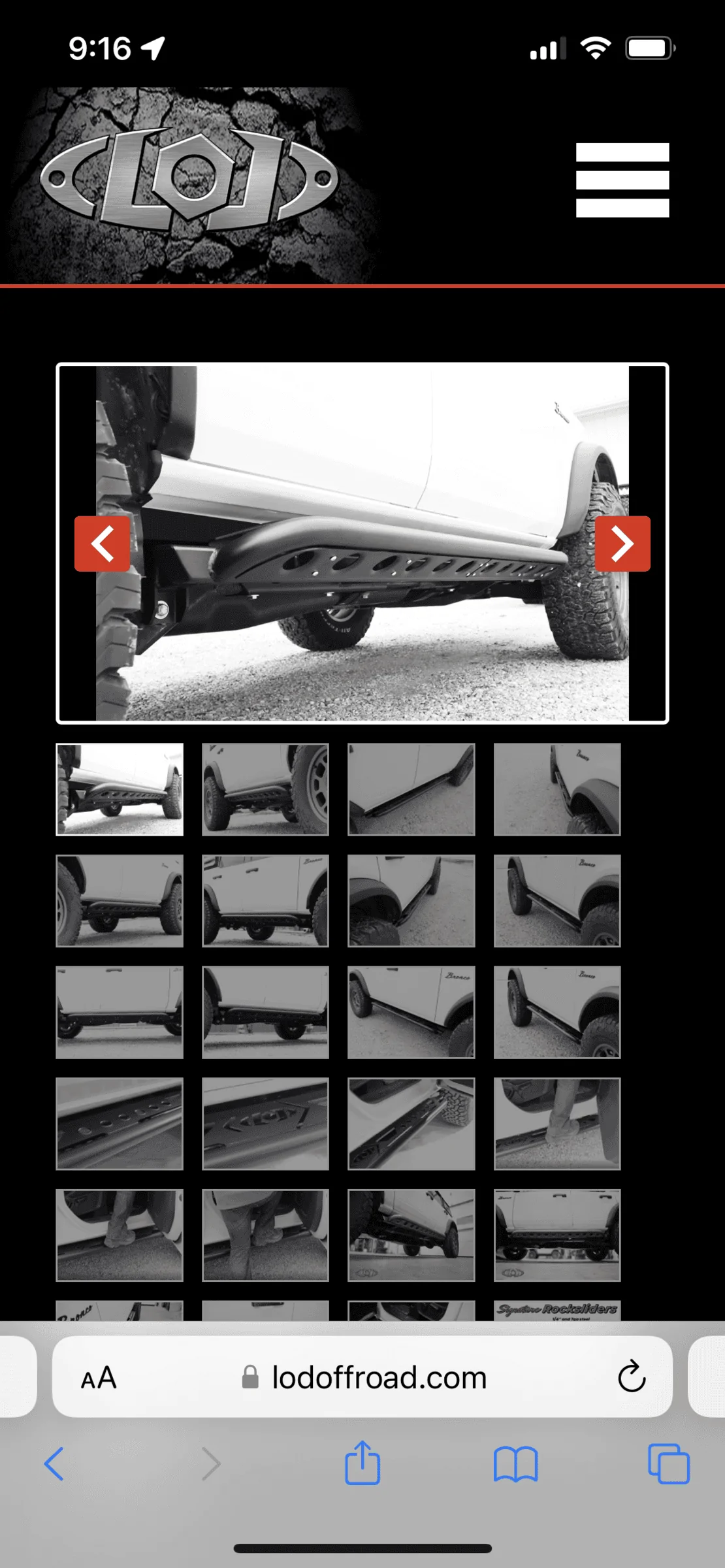

For sure! I'm anxiously waiting to see how they look powder coated and on their test bronco. Those are probably my first choice due to the slightly lower step height, but also being strong. Thanks for the redirect though, I appreciate it.
LOD Offroad site has all three of their frame mounted options available. Free shipping and on sale now. No Bronco tax either!!

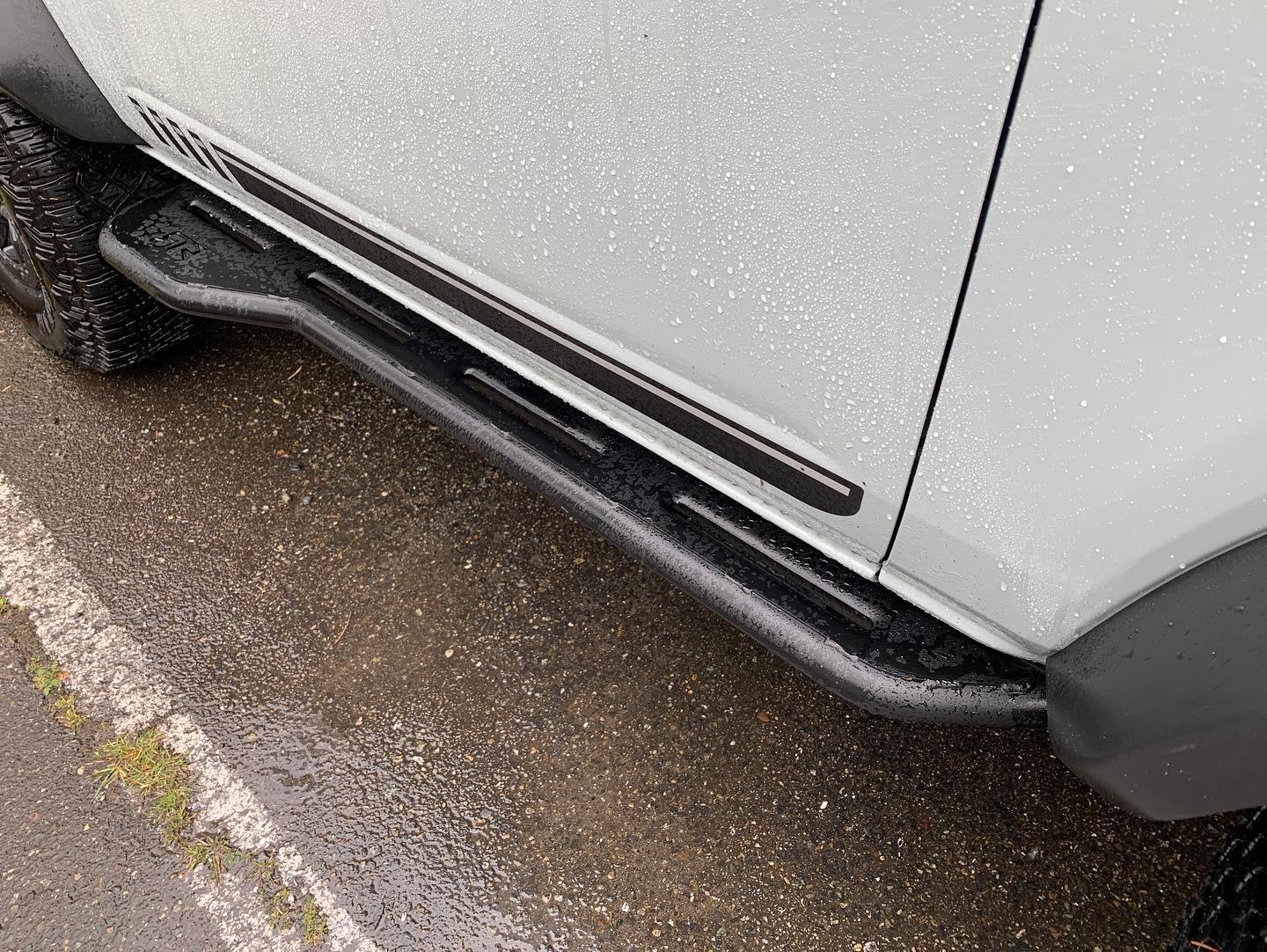

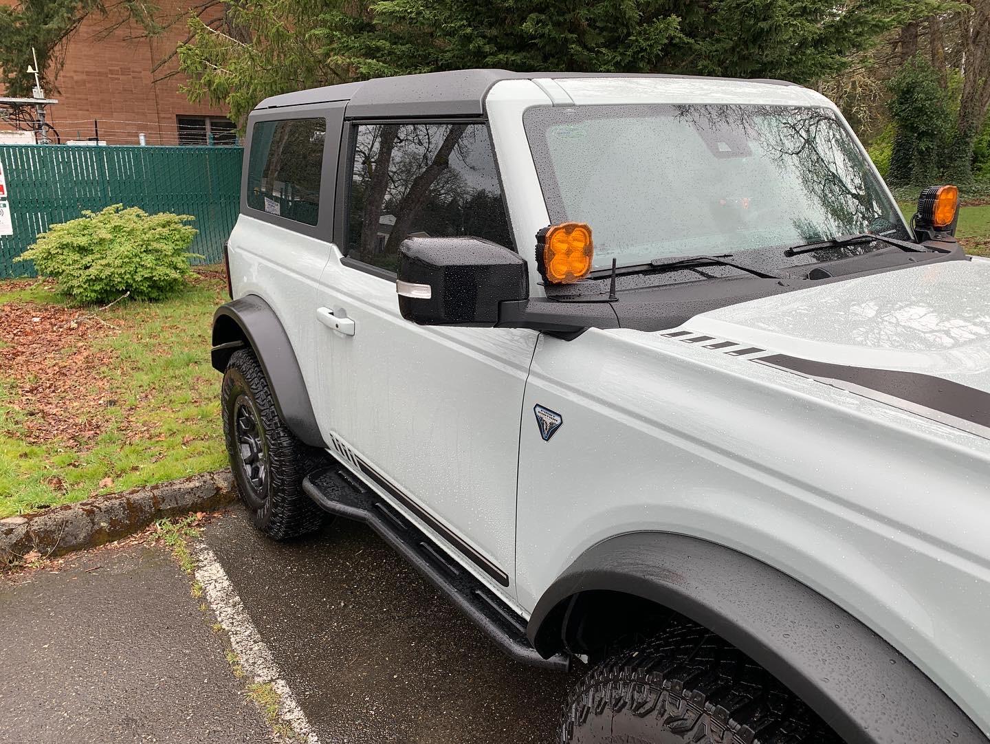

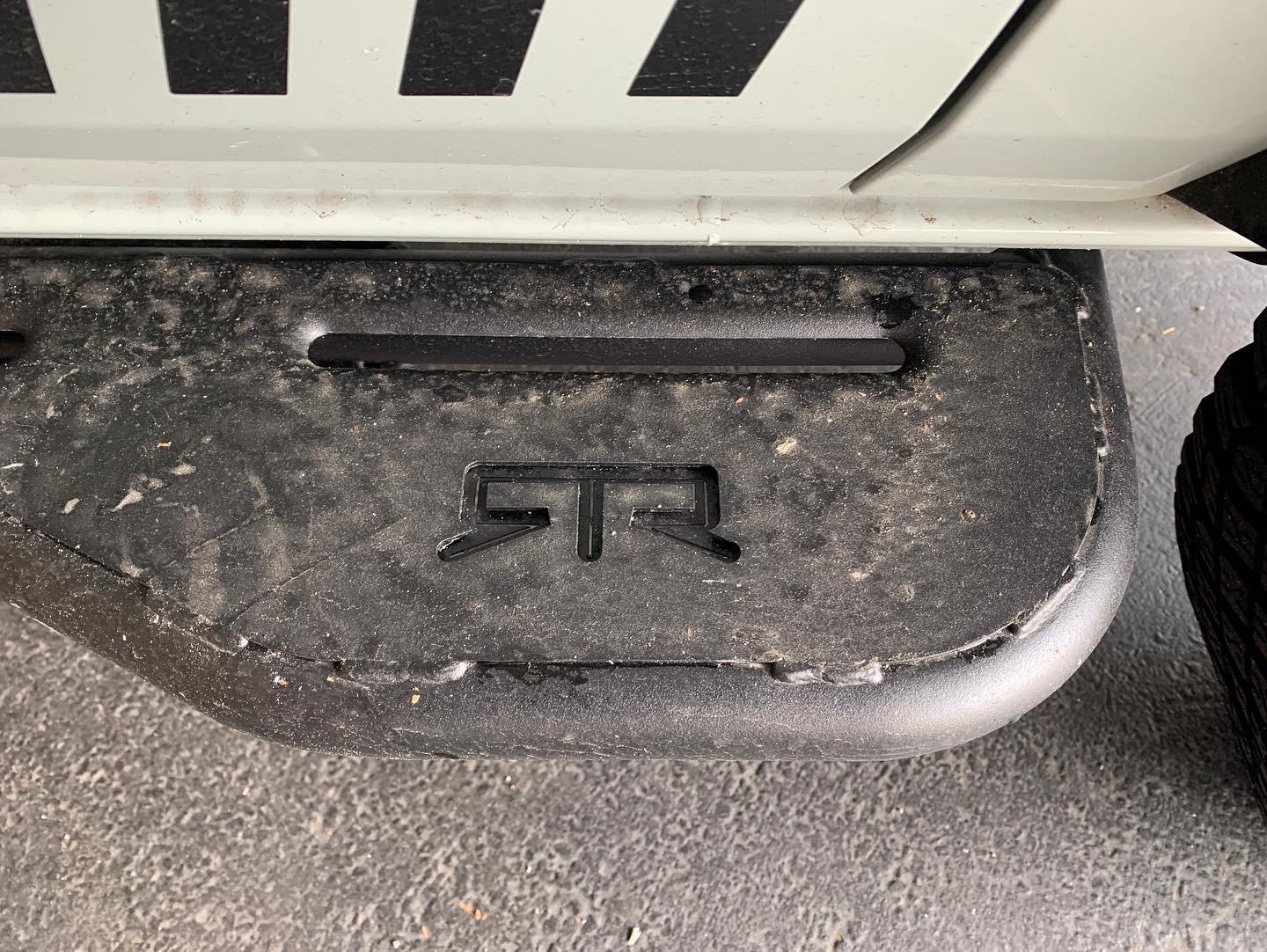

Just installed the RTR rock sliders on my 2dr, top quality, heavy duty, installed like a dream, 4 large bolts (10mm) on each side in the body (torqued 37 lb ft), another 4 small bolts (6mm) on each side through pinch weld (torqued 10.4 lb ft/124 lb in)

Those are nice. Originally had their steps on order but canceled. Went with LOD. These should ship to me next week.

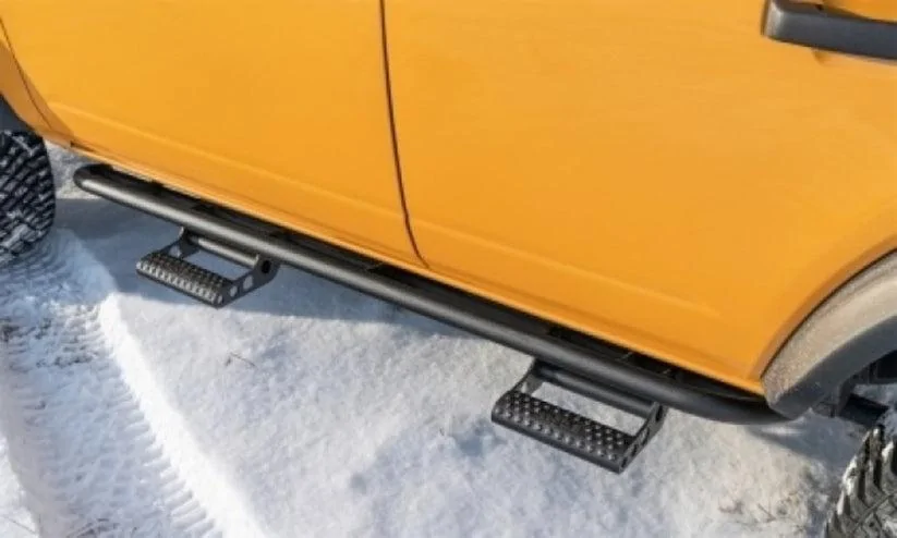

I have the GoRhino D6 steps on mine, very happy here as well. Originally I had planned for the DS or DSS as they don't stick out quite so far, but someone on here talked me into these. If you have sasquatch the outside of the bar lines up pretty close with the outside of your fender flares.
Swapping them back out is a solid 45 minutes worth of work, maybe an hour if you take your time. Its one of those thing you say you're gonna do I think :)
