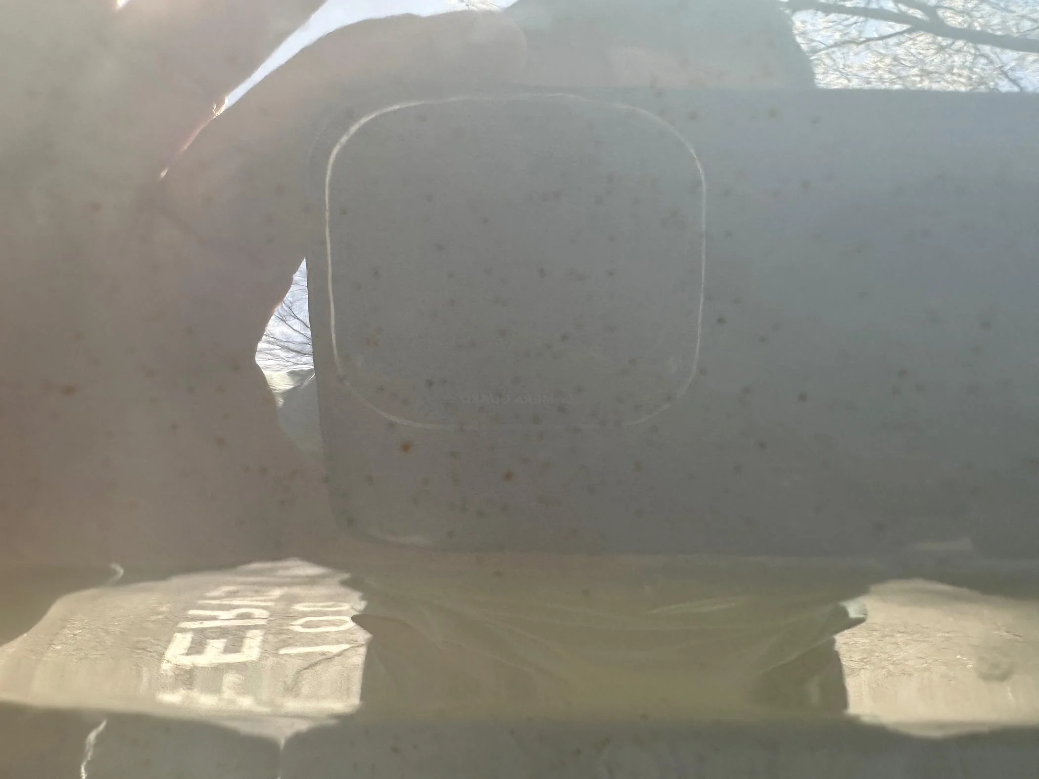

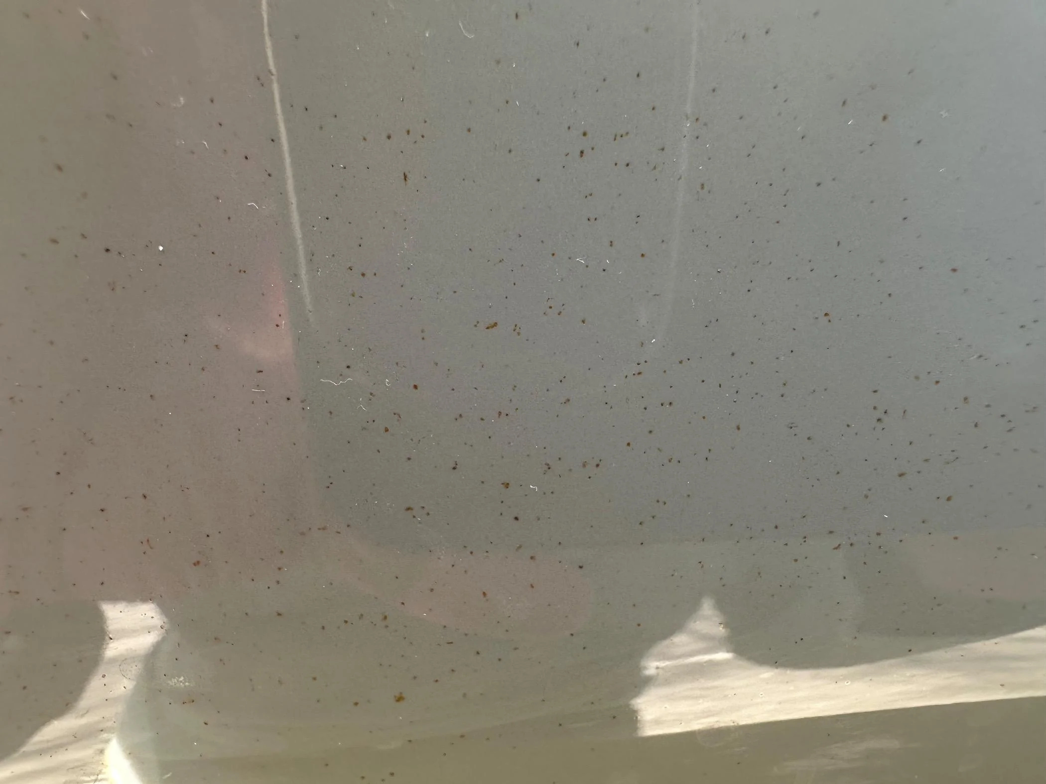

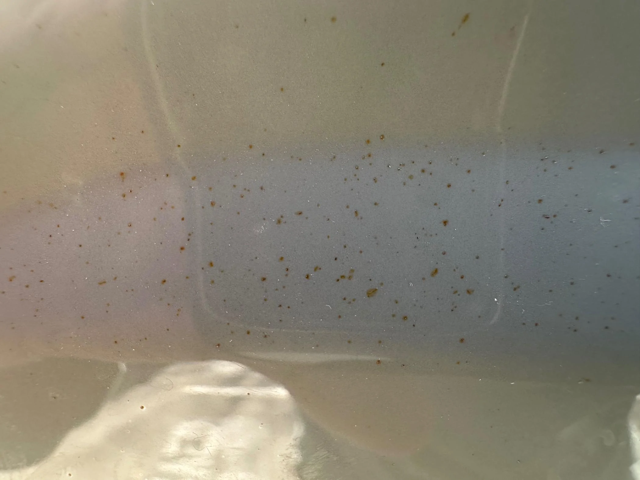

I have a 2023 2 door Badlands and I couldn't hook up my magnetic antenna except the top of the windshield...the whole bronco is aluminum...how did yours rust??? Do you have a picture to show...
I attached the pics it is rail dust. Which rusts on the surface eventually hot iron during transport from rail train attaches to the clear coat. This may be an issue with many of us. Should detail and clay bar your rig after delivery to get rid of it. I have got most of it out but need a lot of iron x seems I had a lot on my rear panels. It has been pretty bad I am sending it to detailer to help me out.
