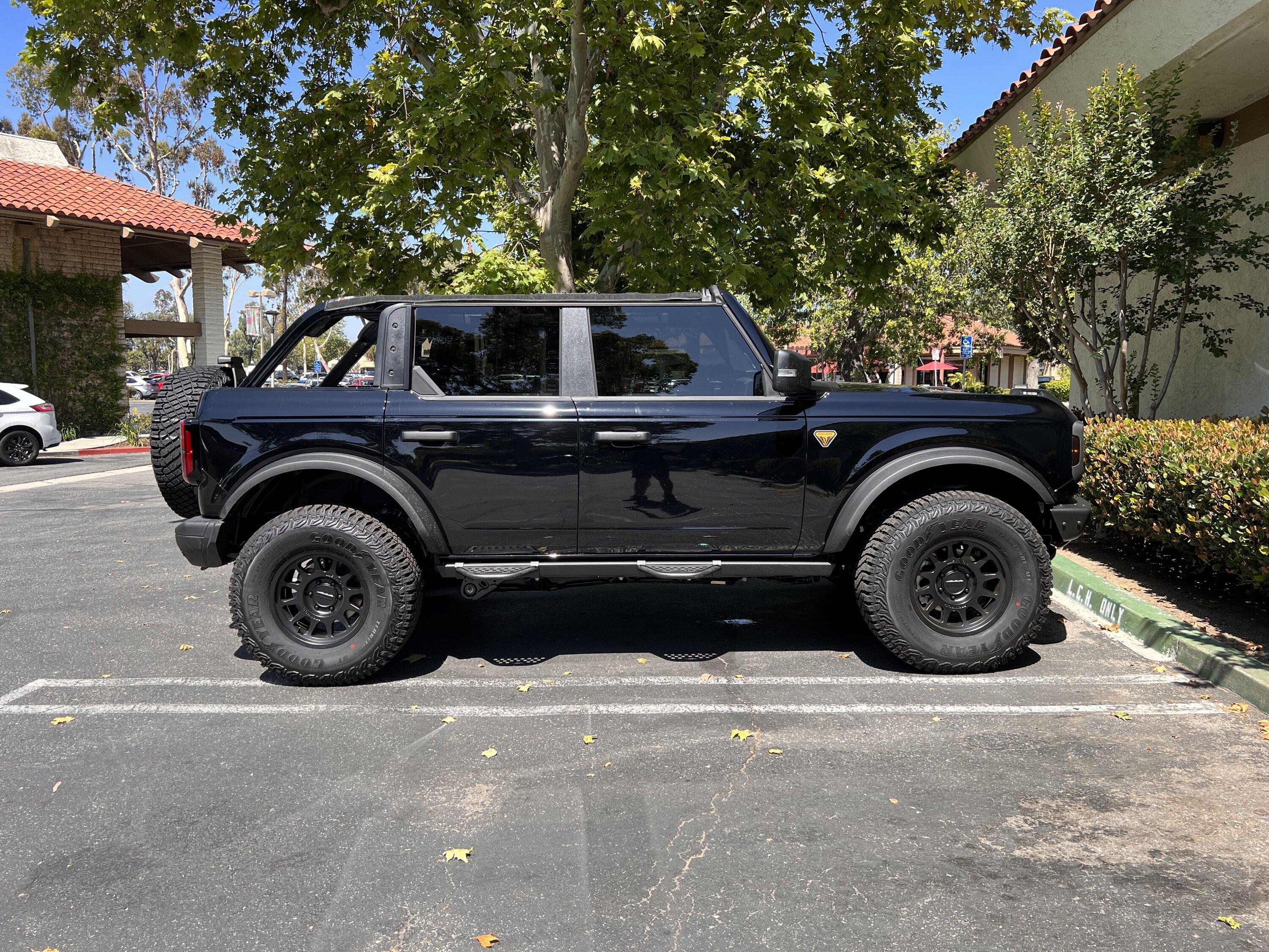

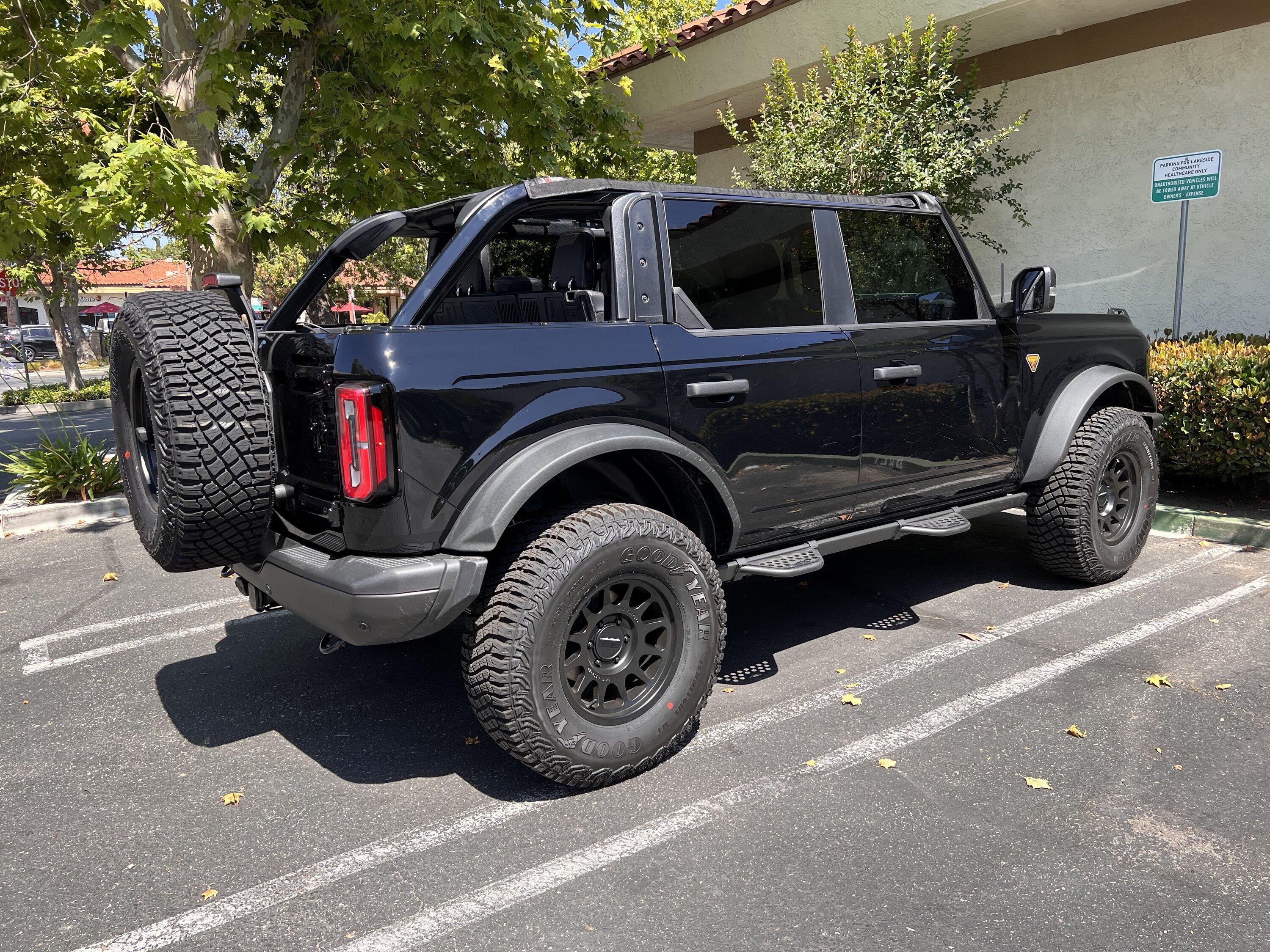

This is what I went with, but I’m already on the SAS setup from factory. I think the small amount of poke looks great.

Here you go. Oddly, the poke looks much more pronounced from these angles than if you look straight down the line
Looks great. Are those the stock squatch tires?

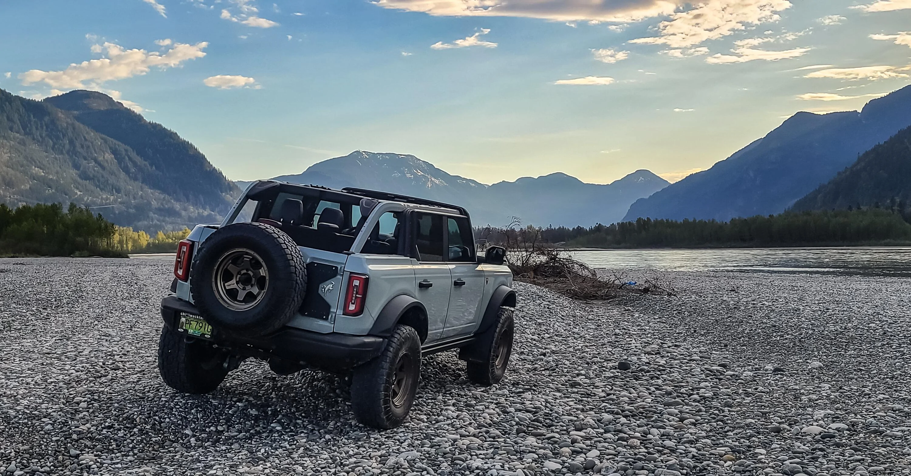

I've had the 6100's on my badlands non sas for a year. They ride way better and give a good lift. Still a slight rake with front and back on the 6th clip. Sitting on 35x12.5x17's.

I assume you are just running the badlands springs? I did read you may need squatch springs or 6112s to get it fully leveled out. I probably won’t go all the way up to 6 tho. I just want sasquatch height or a little higher.

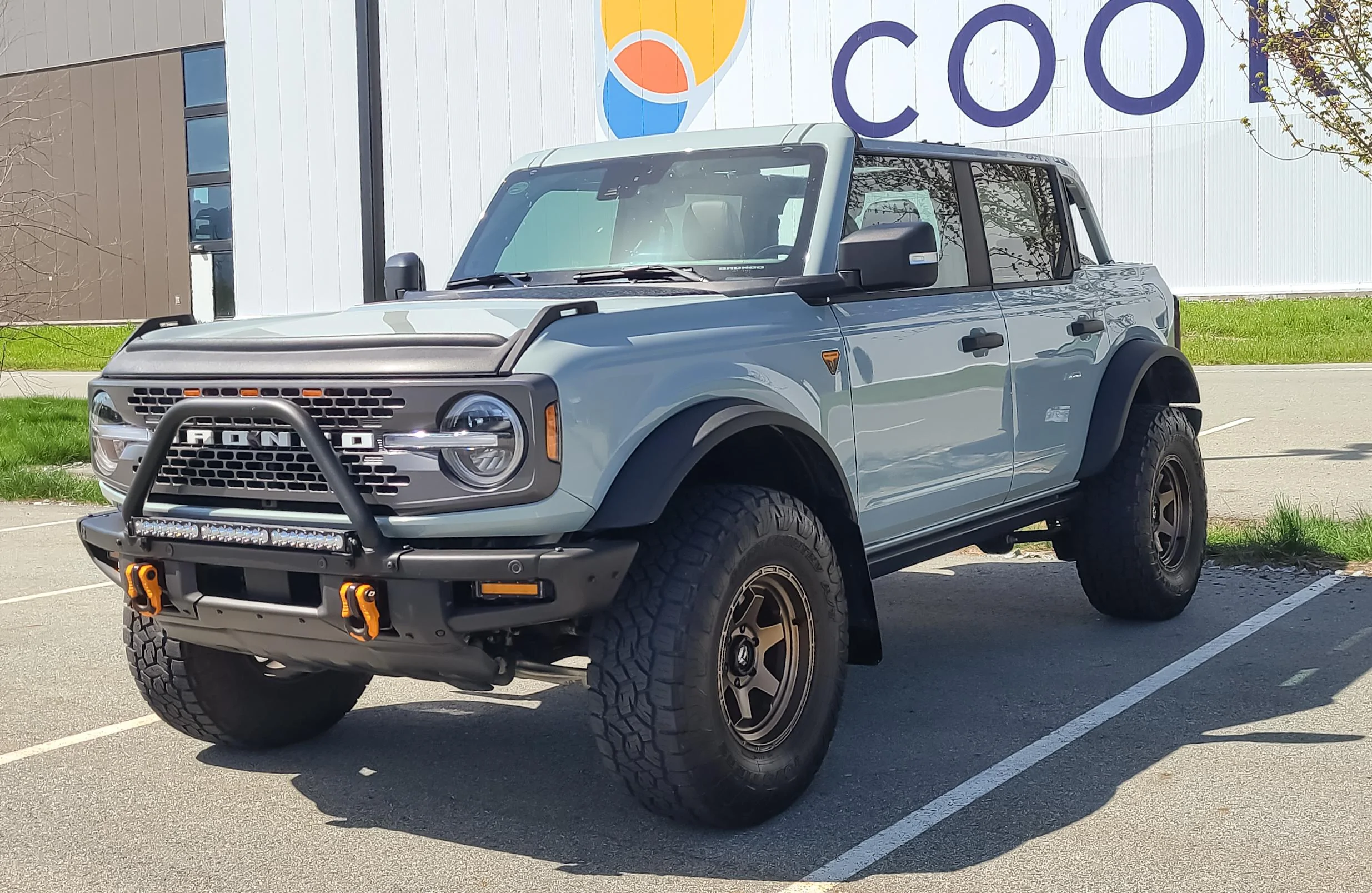

Yes agreed, the difference between a Badlands NON-SAS and a SAS is .43". I have a Badlands that I did a 2" leveling kit to get me at and above the SAS level, plus these look way cooler level than with a rake for sure. I also got some SAS pull-offs. But to be fair, Obviously, I'm a cheapskate, so keep that in mind. Here's what I did. I also have some steering upgrades because I actually use my Badlands off road😉

Yeah, the stock badlands springs. I call it a slight performance rake. It's fine!! Haha
