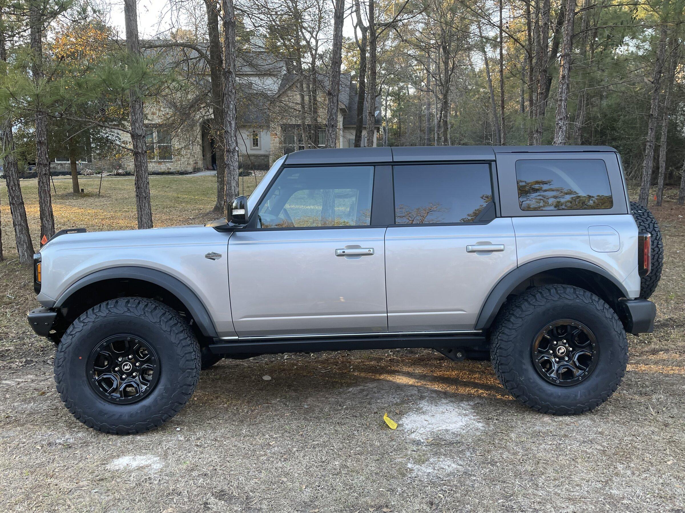

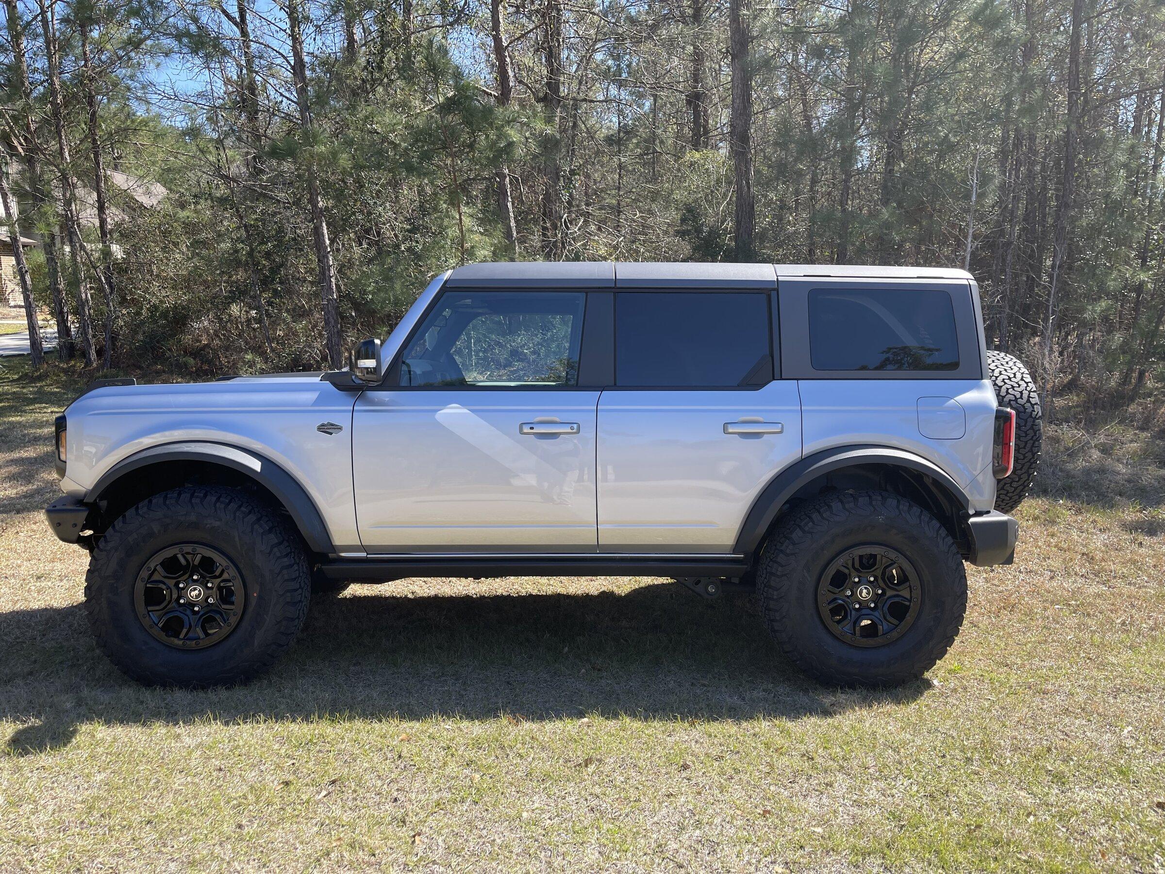

I think it’s the difference between badlands and Wildtrack. I have a Wildtrack with 37x12.50x17 with ford wheels with a plus 30 offset. No rubbing at all. I think the Wildtrack is set up different, I have seen many more Wildtracks running 37’s with no rubbing. I also have the fab tech 1.5 leveling kit.
TxMike
Miguel
Nov 24, 2021
61
Ford Bronco
This afternoon.
