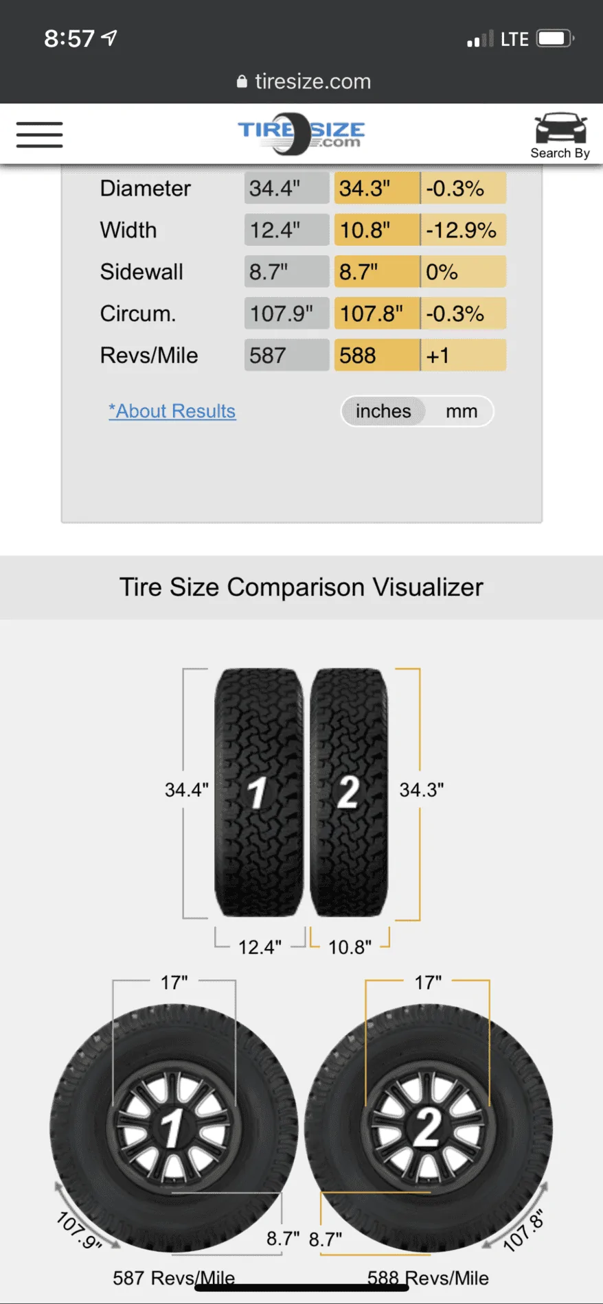

Those tires aren’t much smaller in height, but they are in width. He’s probably just trying to shed some of the extra weight or likes the look better.

Interesting, my tire math in my head was severely off, for whatever reason I thought that was significantly smaller.

It’s goofy because in metric, the first measurement is width and then sidewall height based off of that width (70-80% in this case). Normally, we see full tire diameter and then width. Took me a long time to get used to it.
That’s why it’s so confusing when people say “I have 315’s.” They could be 37’s, 33’s, or something much smaller on a track car. Just means they are 315mm wide, which is about 12.50”.
