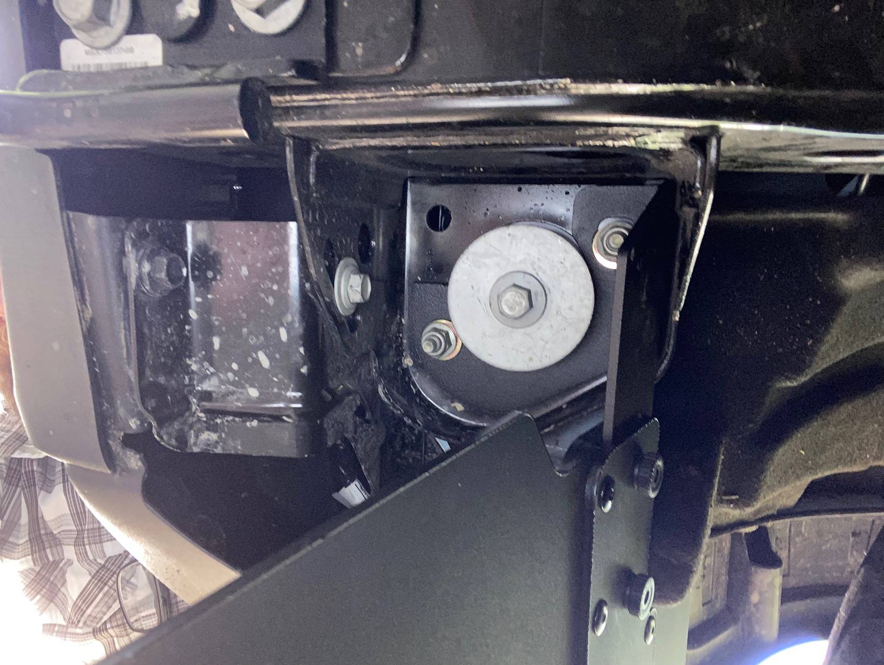

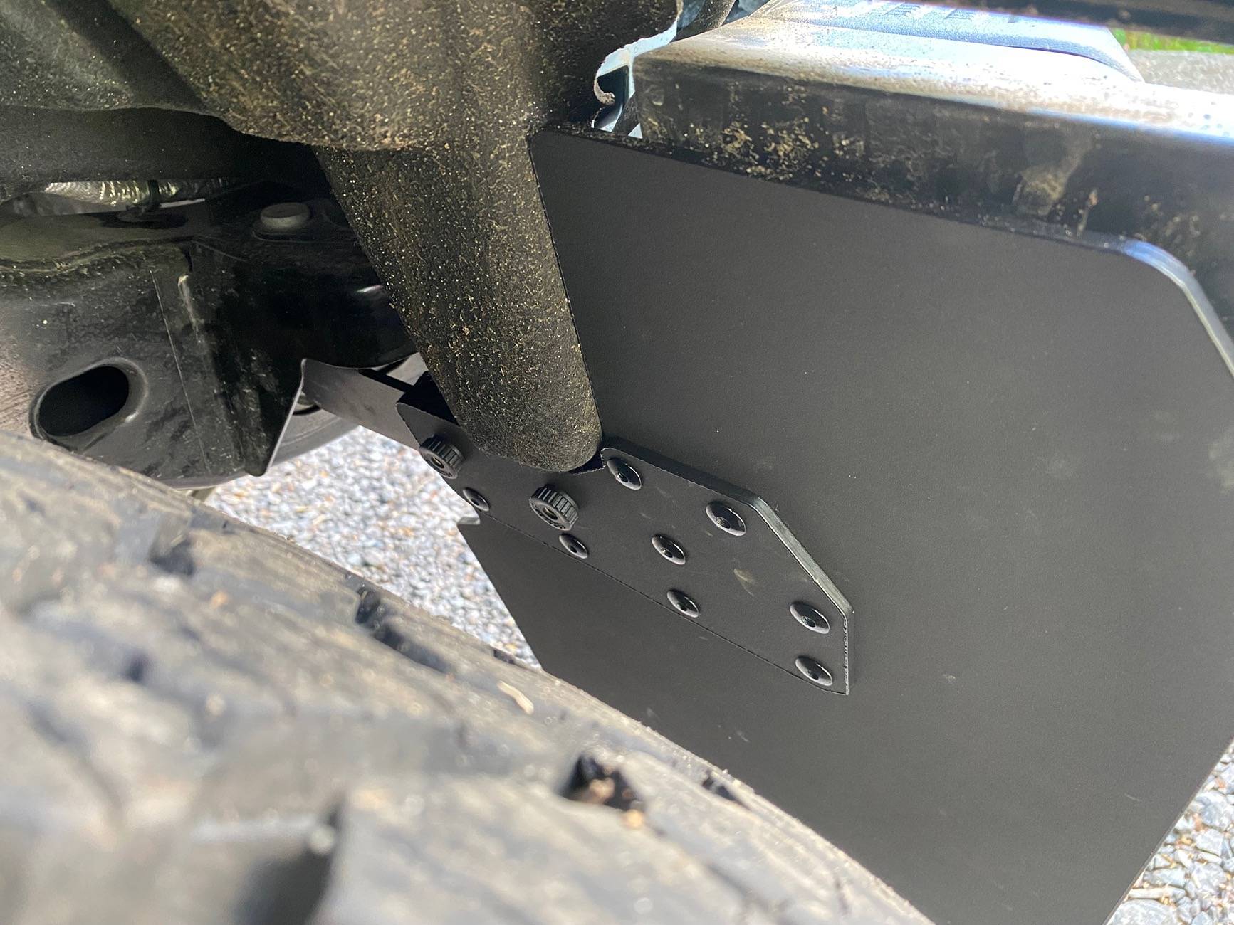

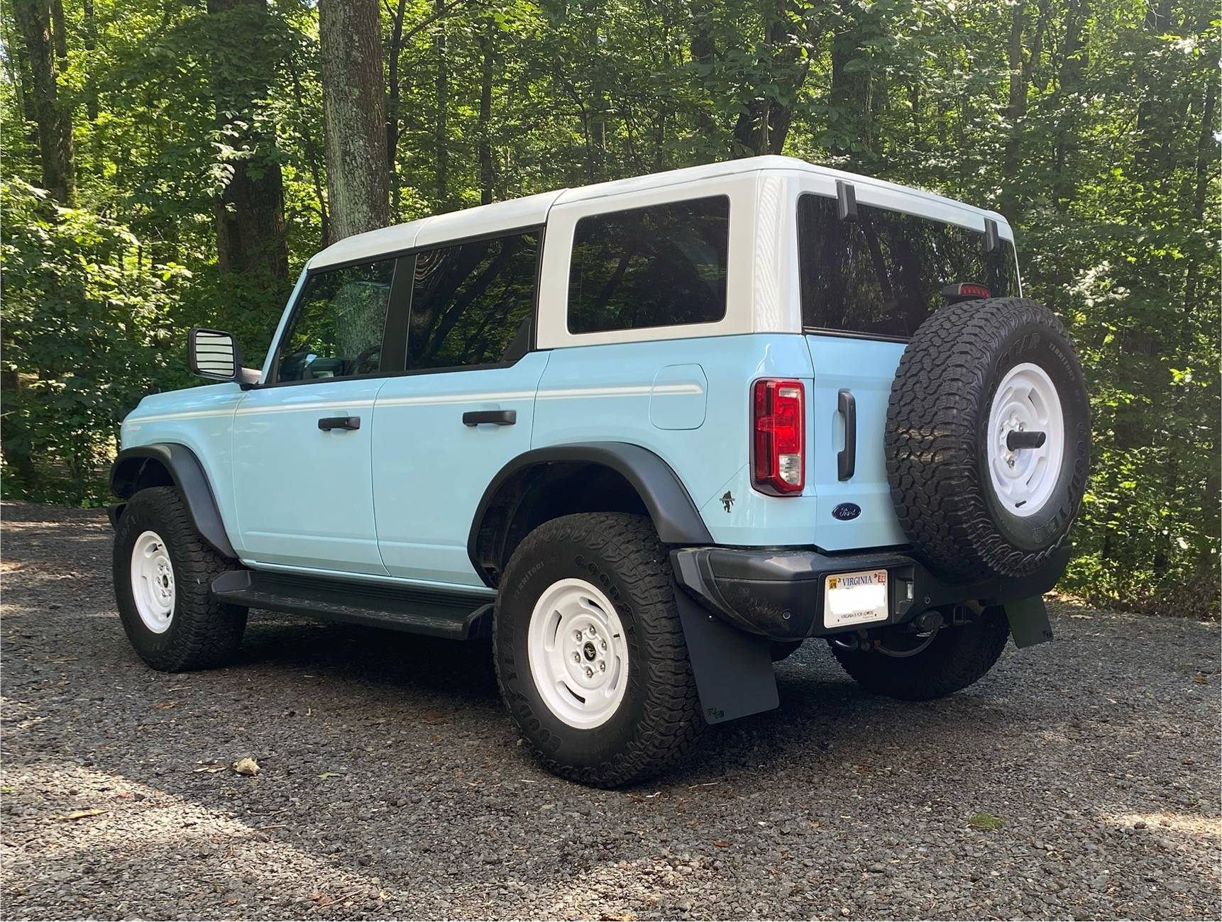

This is the RokBlokz (SAS) XL Long model on my ‘25 HE. The install video and PDF made it pretty easy.
Only discrepancy in instructions is the video and PDF instructions give different torque spec ranges for the nuts under the bracket that mounts to the body. I went with 45 lb-ft which was the lower end of the higher range of the two recommendations for torque specs. I chose the removable thumb screw option for the flaps. “Permanent” screws also provided.
Before:

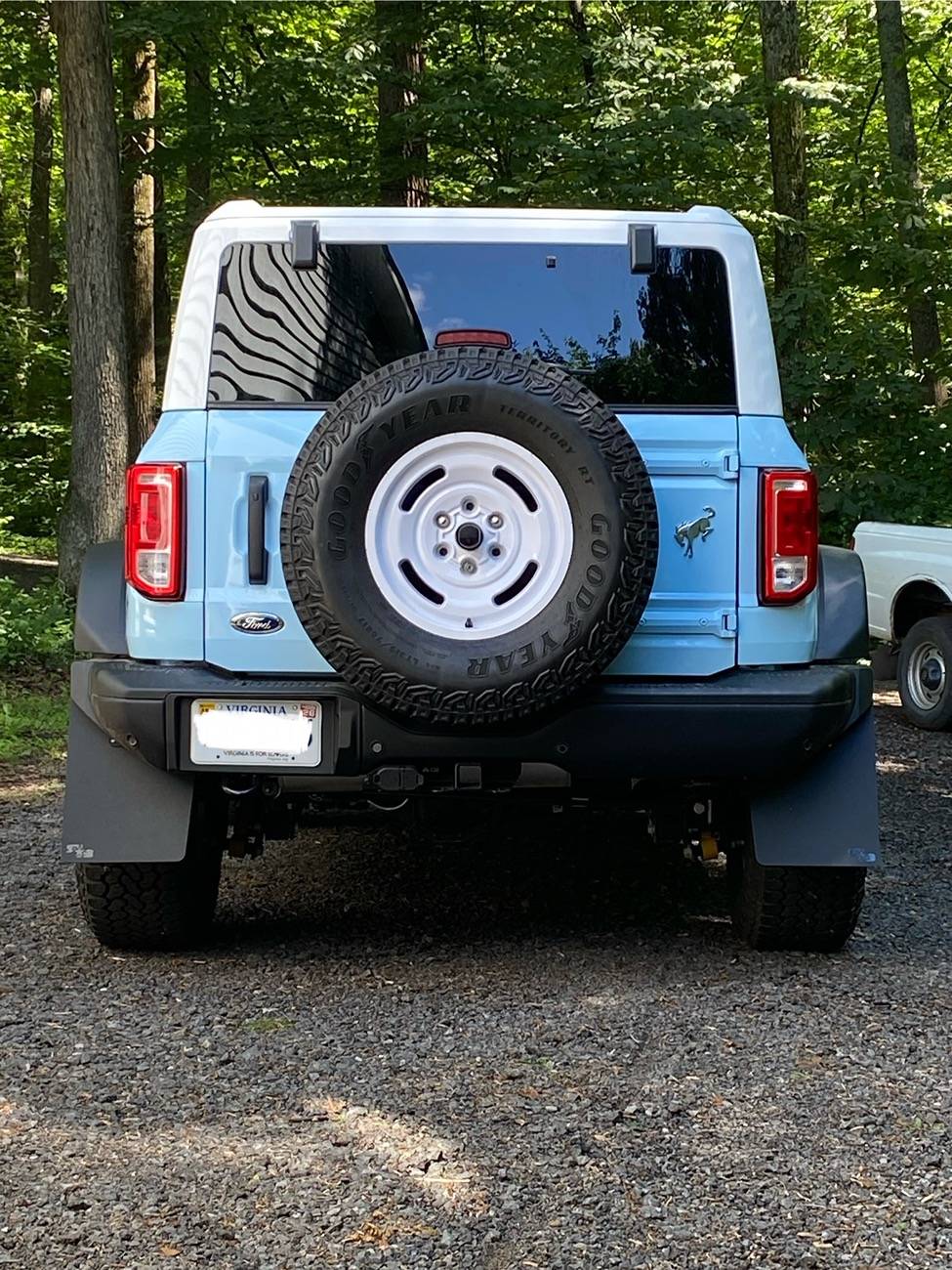

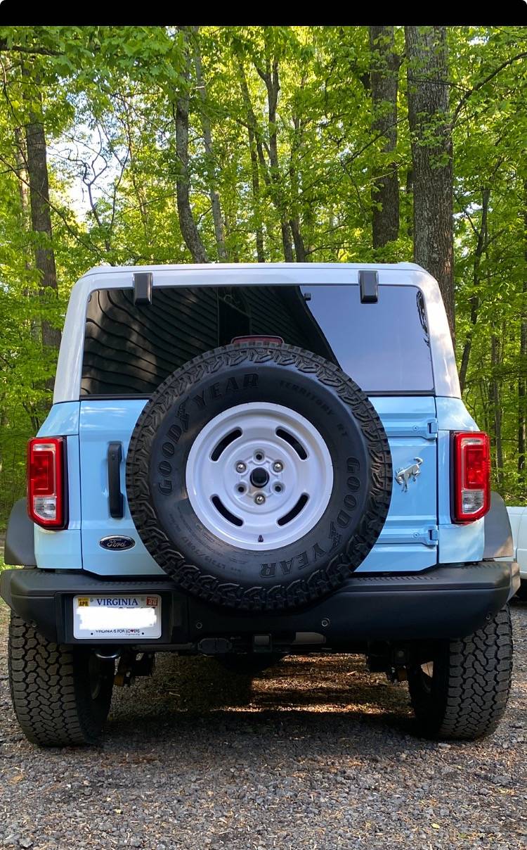

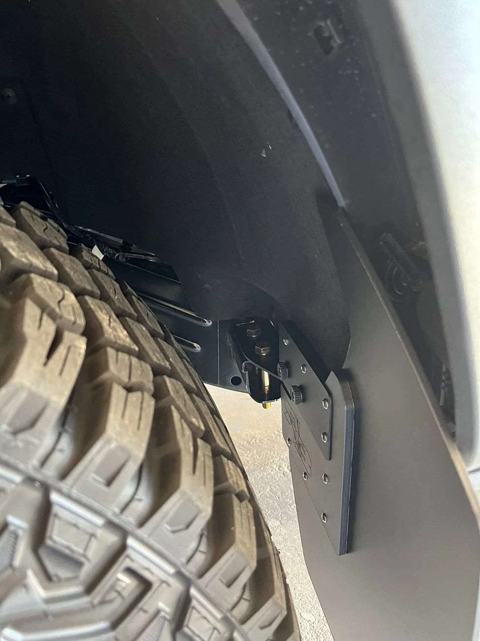

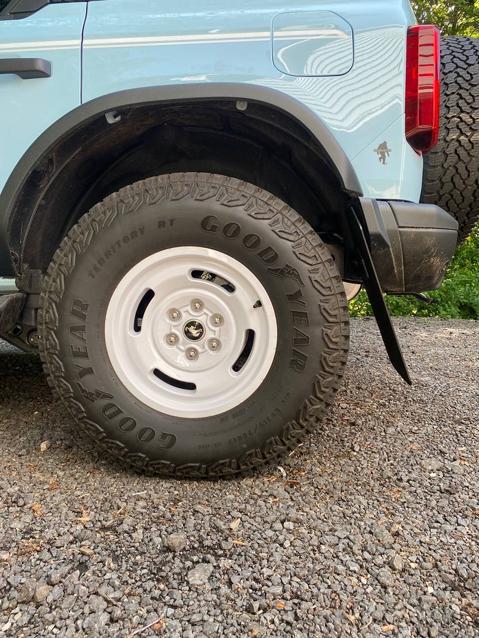

After:
Ford Bronco RokBlokz rear flaps installation. IMG_2109
Ford Bronco RokBlokz rear flaps installation. IMG_2116
Ford Bronco RokBlokz rear flaps installation. IMG_2111
Ford Bronco RokBlokz rear flaps installation. IMG_2118
Ford Bronco RokBlokz rear flaps installation. IMG_2120

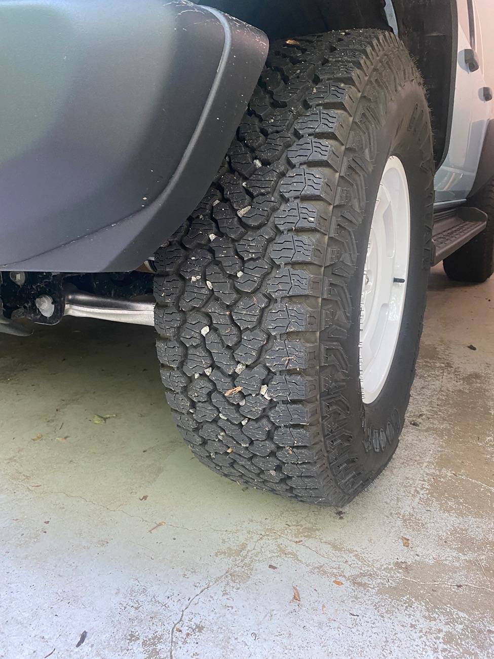

If you’re wondering why I went with rear flaps at all, it’s because my tires tend to look like this by the time I hit pavement when leaving my house. I’m already replacing my own windshield 2 months after purchase so I’m sympathetic to the people behind me on the roads.

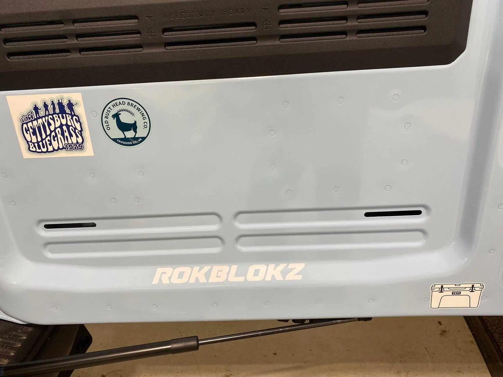

Almost forgot an important technical detail. I’m told that for optimal flap performance, you need to install the included decal inside your tailgate. 🙂
Ford Bronco RokBlokz rear flaps installation. IMG_2121

Good, neat job. I especially applaud your installing the rears. I think front flaps only not only looks selfish and inconsiderate, but lopsided and aesthetically clumsy.
I had several thousand miles on mine when I installed RokBlokz, and found that getting the rear brass install brackets weren't reaching the wingnuts. Rokblokz sent me longer bolts, gratis, and right away. So they're customer service is superb.

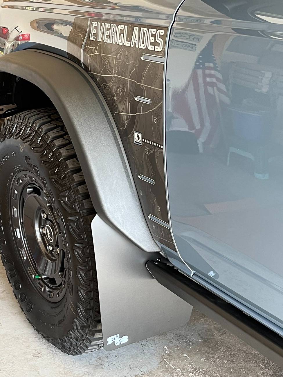

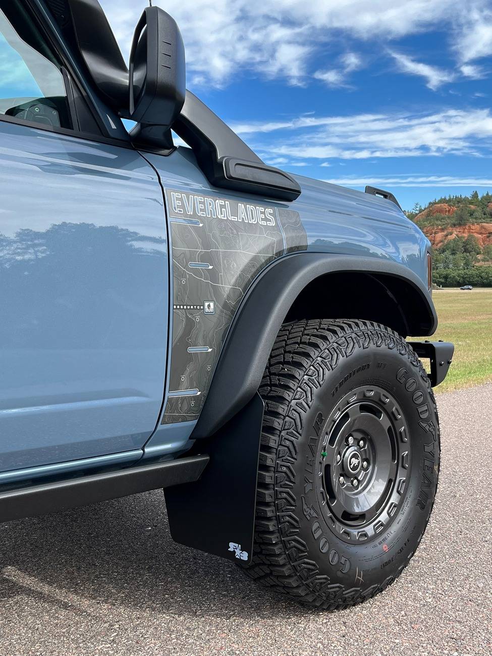

I'm not sure if this is helpful not knowing the length of your running boards, but the RokBlokz front flaps fit nicely with the Everglades rock sliders (pictures attached).

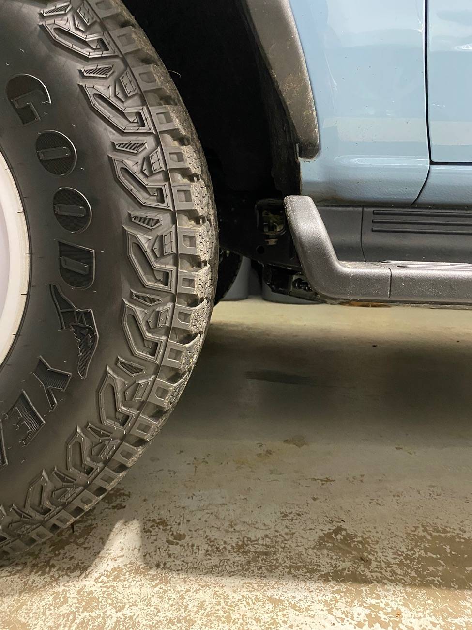

Thanks. The new style running boards actually jut aways into the wheel well. When combined with the flare at the end, this presents a fitment challenge for alot of flaps, including some that worked with the previous flat boards.

Ah, I see. That does present a challenge. I don't have a solution, but others might? I do like those classic running boards, though. Other than that gap, it looks like they do a pretty good job as rock blockers.

The boards absolutely help with rocks because I hear gravel pinging all over the underside as I head down the paved road but I haven’t gotten a single chip on the sides yet. A little mud does get through the gap. The only solution I can think of is buying a front set and then trimming them down significantly to just close that gap with a couple of millimeters of space between the trimmed flap bottom and the top of the flare. This way the flap wouldn’t be force-flexed towards the tire. It might work out or it might look weird and I’ll have to spend a couple hundred bucks to find out. Very tempted to try.
