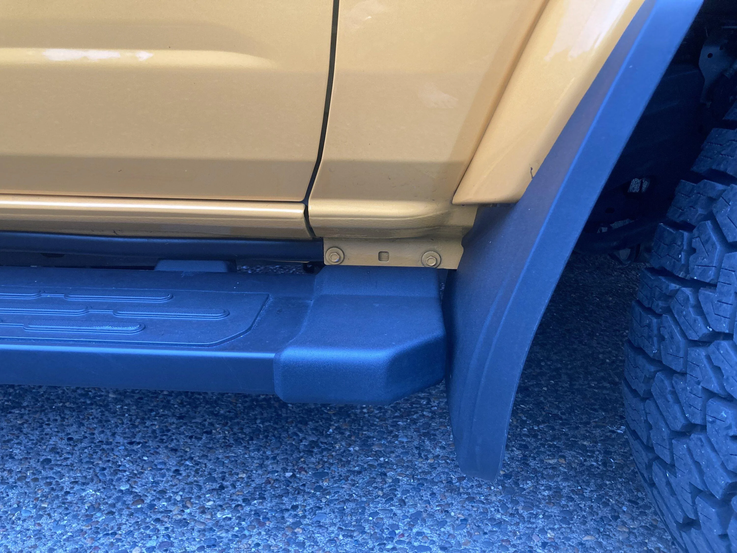

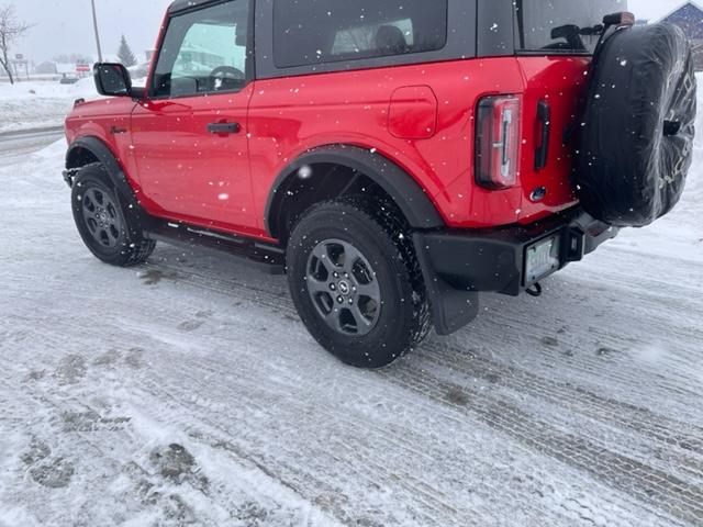

I finally took the plunge and these directions were perfect! The whole project took 2 hours max and I was pretty slow, not wanting to ruin my running boards. I installed the cheap ford flaps and on the fronts, I skipped the last step, which tells you to drill into your flares to install your flares to install retaining screws. Mine are held on with the 3 c clips, and 2 trim retainers and I've had no issues.
Ford Bronco Reverse Running Boards for Mud Flaps IMG-6551
Ford Bronco Reverse Running Boards for Mud Flaps IMG-6552
