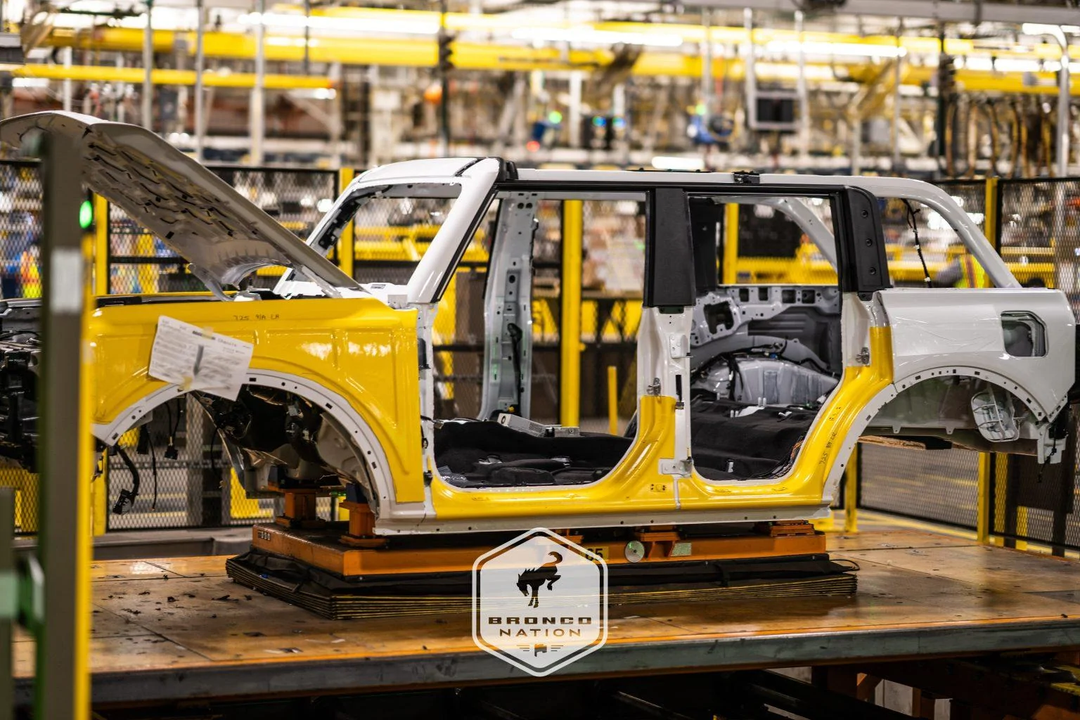

And no, I don’t see cutting out the stock bars, as they are integrated into the whole Bronco body, maybe adding a cage, if you can fit it in.

The so-called Sport Tubes are made of Boron steel, same with the A,B,C Pillars very strong and if you cut those out the vehicle will lose most of its rigidity.

The body will lose it's structure. It still has a full frame. True race spec cages are welded to the frame not the body. In the case for the Bronce unless you are going to run a full glass body the factory "cage" will likely have to stay in place and the real cage will be built around it.

Sawzall, angle grinder would get it off. Good luck
Actually, apparently a sawzall or an angle grinder can’t remove it, because of the boron steel reinforcements fire/Ems crews are having problems cutting open vehicles, even the high force sheers can’t cut through the boron pieces. Needs a plasma torch. But, still holds true that the sport tubes on the Bronco are actually a structural part of the tub assembly.
