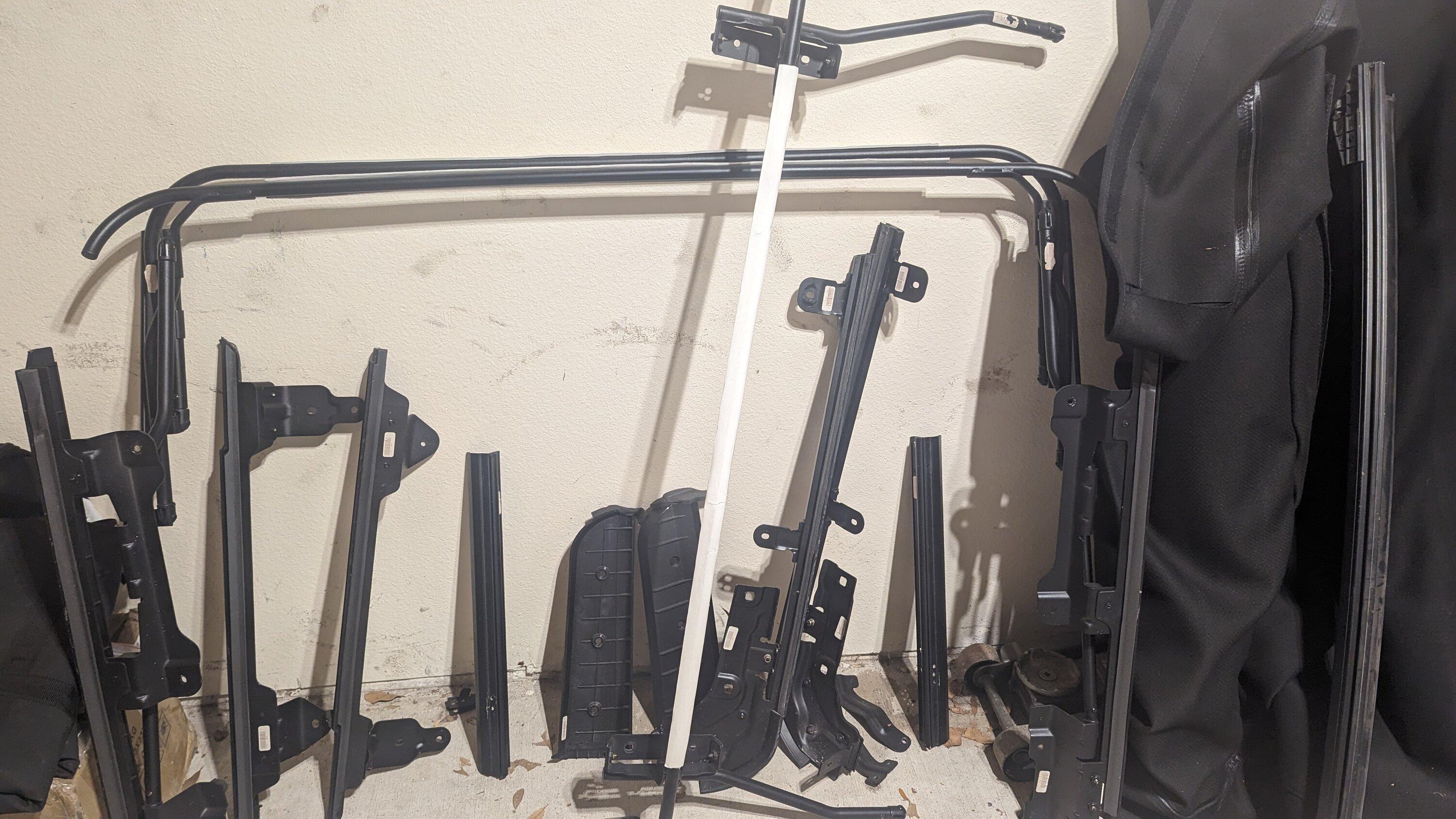

Thanks I have my hardtop on the toplift pro right now wondering if I can somehow hang the Bestop on it when swapped
SpringTXOR
Jason
Jan 20, 2021
1,457
3,038
The Woodlands, tx
1986 Bronco XLT
Ford Bronco Remove Bestop Trektop to Put on Hardtop PXL_20230728_031025819
The main bow assembly in left together, the rear one I just unbolted it from the roll bar as an assembly too.
