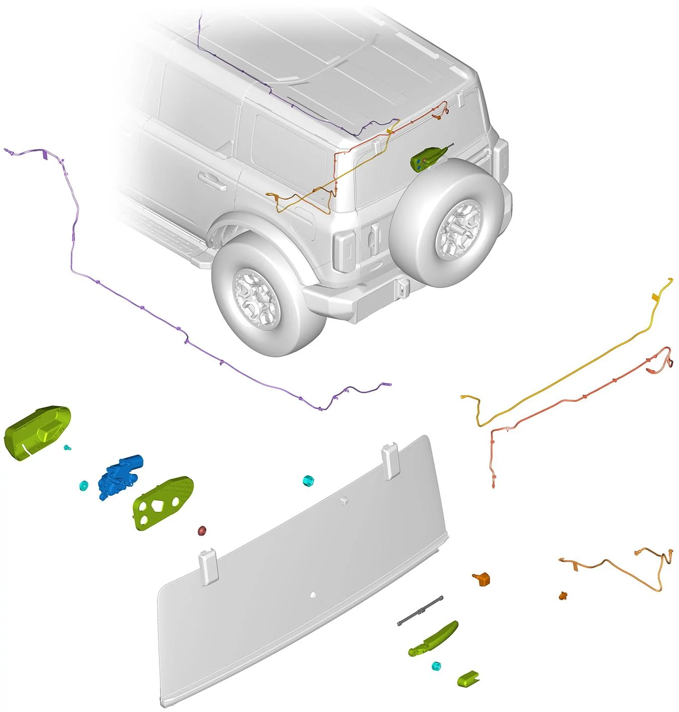

Does anyone have a diagram of how the wiper fluid hose is routed in a 2 door?

No. Sounds like a line is disconnected at a joint or you have a hole in it. What part of the cab is getting wet? The yellow line crosses from the left to the right the joins up with the purple main and heads forward along the right side. So basically 2 places the main line can come apart and also the connection where the window hose attaches on the left. If it leaking mid cab, there must be a hole in the line.

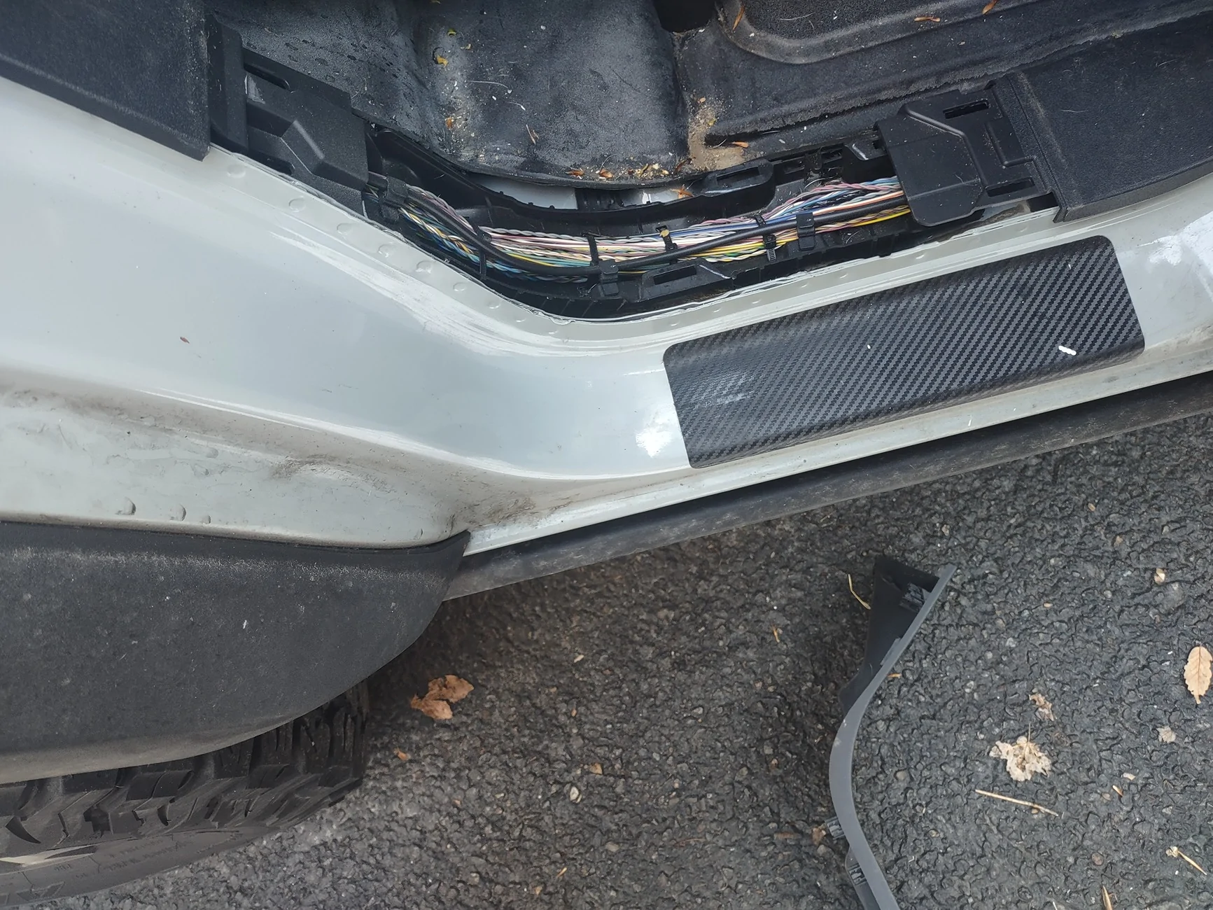

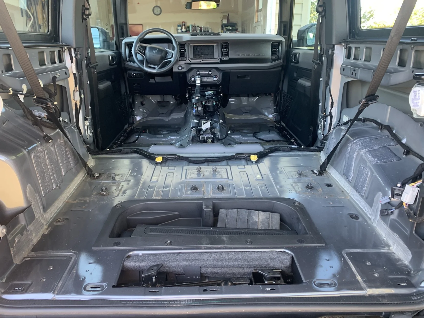

I had this problem on my two door. On mine, if you pull the trim piece up by the door on the passenger side, you can see the plastic line going to the back. My leak was on a 90 degree elbow that had blown out under the rear passenger seat close to the cargo trim piece. The line just pushes in the elbow with a molded feral made in the line. I pushed it back in, and smeared some black ATV sealant around the elbow where the line goes in.

If you look at just below the silver seat belt mechanism on the passenger side, you can see the plastic line where it becomes corrugated after the 90 degree elbow. It crosses over to the driver side here on the two door, should be the same on the four door.

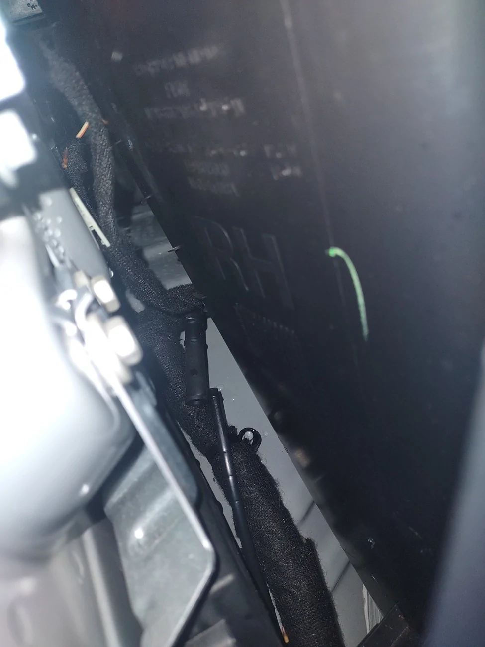

Ford Bronco Rear wiper fluid spraying inside. IMG_20260301_084516714
Ford Bronco Rear wiper fluid spraying inside. IMG_20260301_084651325
Got it. Finding it was pretty easy, actually getting it back on was tough. Would be much easier with warm plastics and hoses.

I would smear a little black ATV sealant around the 90 degree elbow. I don't know what blew mine out, back pressure or washer fluid that was not rated for extreme cold and it froze and blew out.

99% mine was from freezing. There were some sub 15f days and I just had regular/summer fluid in it.
