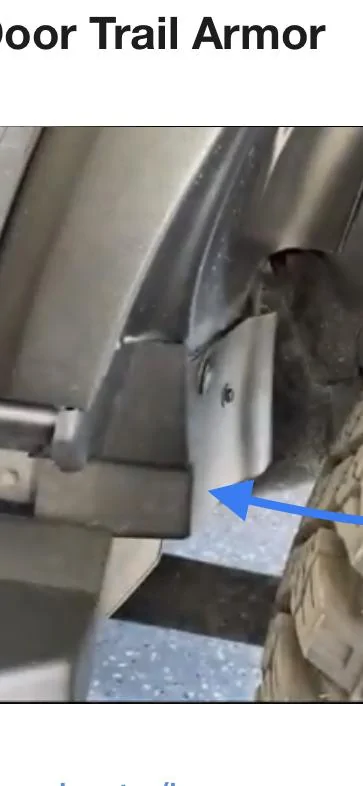

So here is the issue, in the videos and instructions, it shows sliding the trail armour into the trim piece in front of the rear wheel well. I don’t have this trim piece…
This picture is from Cupra’s video for the install. Arrow points to the trim piece.
Ford Bronco Rear Wheel Well Trim Question 8033D358-C88B-4CC5-B7C9-245D3867B03E

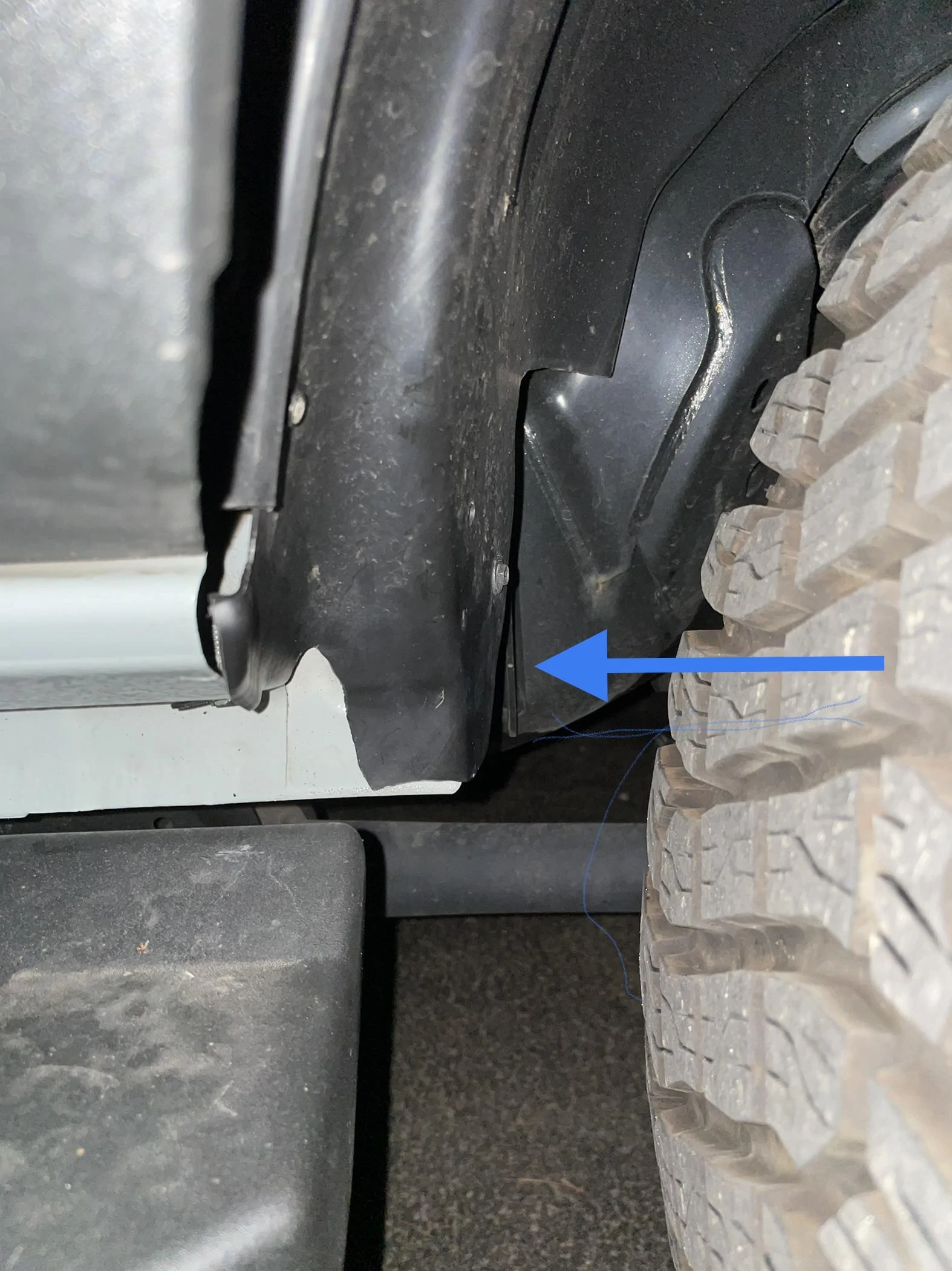

Now here is what my wheel well looks like:
Ford Bronco Rear Wheel Well Trim Question 96E16080-5455-4118-A455-294BCD8560B1
Am I missing a trim piece here? Or is this correct for the Badlands SAS with rock rails? Maybe did the dealer forget to install that additional trim piece?
Probably can install the Trail Armour but there will be a gap that does not seem to be there with all the pictures I have seen.
Any assistance or guidance would be appreciated. Thanks in advance.

The trim piece was not on my Badlands Sas as it came with the rock rails. I did a dealer swap to trade for the factory side step for the rock rail.
The trail armour is designed to use the trim piece from the side step equipped vehicles. It will work Fine if you don’t have the trim piece but as you noticed there will be a gap.
in the end I ordered the trim piece from my dealer for both sides. If you never had rock rails then you should have had this piece. Sorry I don’t have the part number but was relatively easy to find at the dealer.
