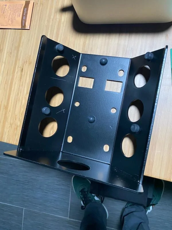

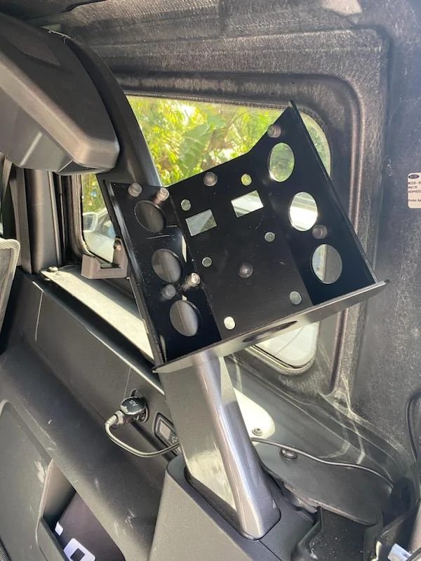

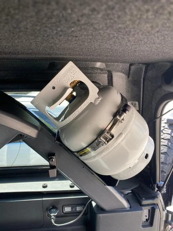

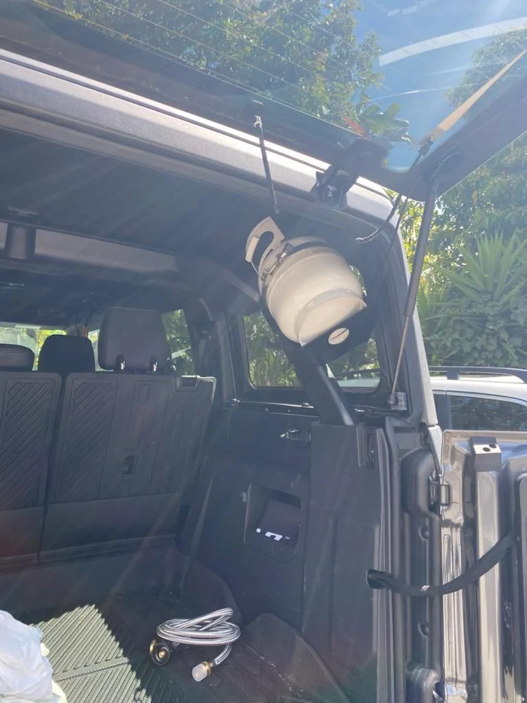

Most of us non-Raptor owners have two M8 factory-drilled mounting points in the rear roll cage, so here's my solution for what to do with 'em!
This is a 5lb propane tank with the PowerTank BKT-2285-AL Mounting Bracket. Drilled two 5/16th holes into it for the two M8 bolts with rubber washers and it seems to work great.
Ford Bronco Rear Roll Cage Mounting Points - Propane Tank Solution IMG_3011
Ford Bronco Rear Roll Cage Mounting Points - Propane Tank Solution IMG_3017
Ford Bronco Rear Roll Cage Mounting Points - Propane Tank Solution IMG_3020
Ford Bronco Rear Roll Cage Mounting Points - Propane Tank Solution IMG_3021
