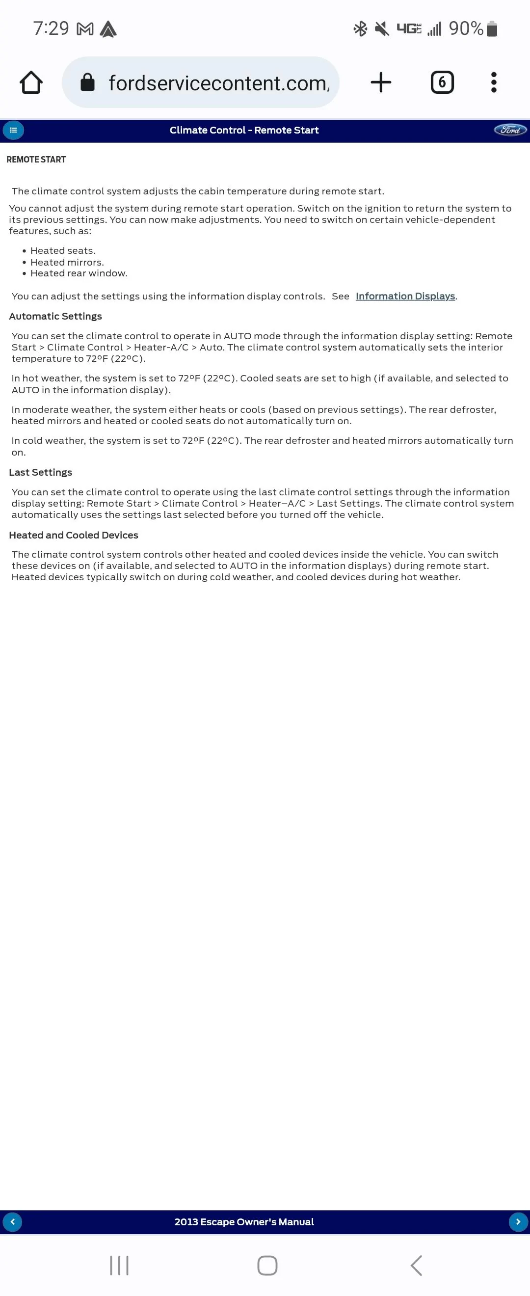

Ok, So now I'm thinking it's based on Cabin Temp. Factory setting is 72 deg. So, when I first start it, the inside cabin temp is say 40-50 degrees. Rear Defrost ON.
AFTER Driving a bit and the Cabin temp is now 78 deg, the Defrost won't turn on Automatically.
This is based on this:

i thought the quote from the owners manual in your previous thread explained when the rear defrost does and does not turn on with remote start. Looked clear to me, based on exterior temperature whether there was a need for it or not.
I cannot believe however that it would stay on for an hour. 15 minutes max if it in a timer and not a sensor.

Sounds like it is WAD (working as designed) Case Closed my dear Watson
