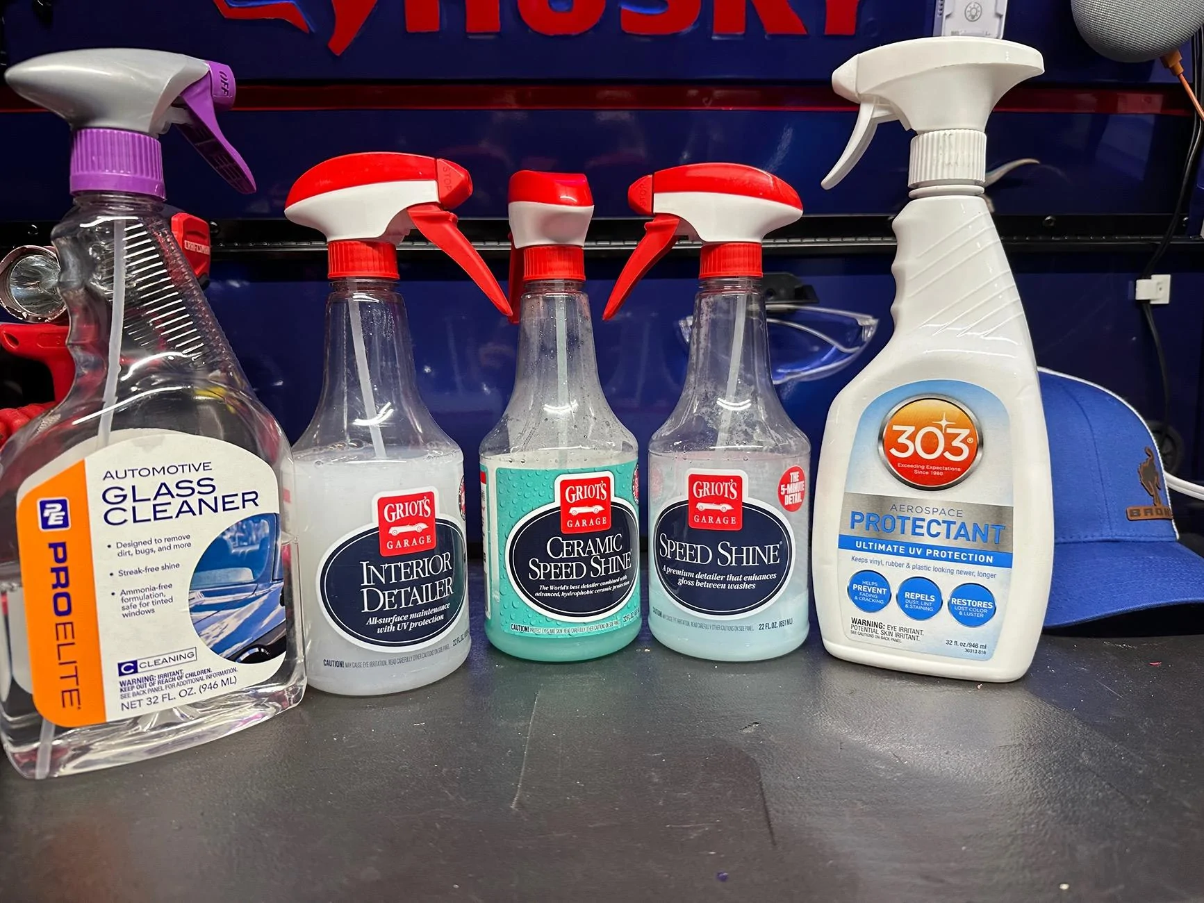

Why can’t you get it ceramic coated now? Might have to do a paint correction but sounds like you aren’t hard core off-roading. Might be worth finding a reputable shop and see what they say about it. I had mine ceramic coated shortly after getting it. It really does make a huge difference when I wash and detail it. Here is what I use on mine.
Pictured from left to right:
Ford Bronco Raptor specific exterior detailing recommendations? IMG_1819
Windows - ProElite Automotive Glass Cleaner - I have tried 100 different glass cleaners and found this one to be the best.
Interior - Griot’s Interior Detailer: I do everything on the inside with this and it’s really good. I don’t like the wet greasy look and this stuff is perfect for me. I don’t use it on the seats. I honestly don’t know what to use on these seats yet so for now I am just using a damp cloth to wipe them down.
Body/Paint - Griots’s Ceramic Speed Shine and regular Speed Shine: I discovered this stuff on my last Bronco and it is awesome. They both work great but after the ceramic coat, I prefer the ceramic speed shine. I have color matched fenders and I had my wheels ceramic coated as well. So my process is washing the Bronco, driving home the long way to air dry it. When I get home, fire up the air compressor and get all the left over water I can out of all the hiding spots. Do a once over with a clean microfiber towel to get anything I missed. Then I do the whole truck with the Ceramic Speed Shine. I just do section at a time. Hood, fenders, each door, etc. You just spray it on, wipe it down dry. I do the whole truck and then another quick round with a clean micro fiber to get anything I may have missed. Do the same for the wheels.
Exterior Trim - 303 Aerospace Protectant: Someone on these forums turned me into this stuff. It’s the best stuff I have found. I get a microfiber towel and spray this stuff on it and wipe down every exterior plastic trim piece as well as the hard top. I then go back around after I get everything and clean up anything I may have gotten on the paint.
For my tires, I just spray them with the Griot’s Interior Detail stuff. Not a huge fan of the wet look and I don’t want the crap slinging all over the paint. Depending on the weather and what I am doing, this process isn’t a regular occurrence. It does take me about 2 hours depending on how filthy it is. That includes driving to and from the car wash. Hope that helps!

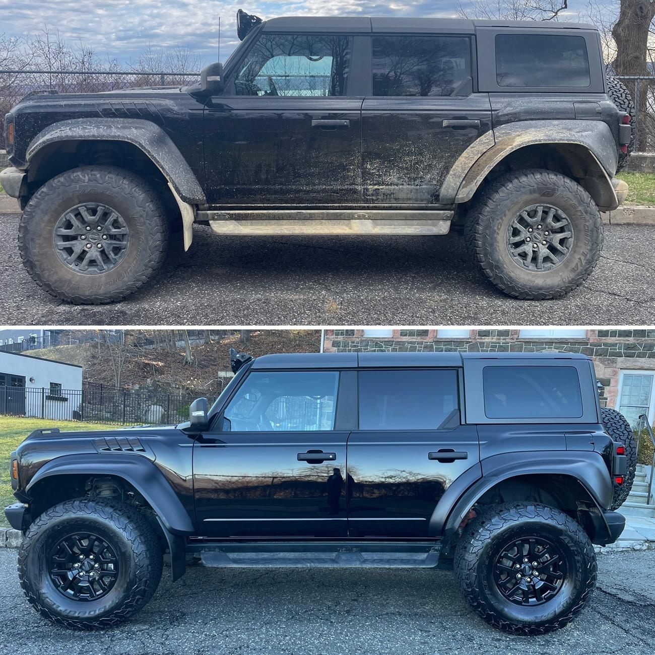

Ford Bronco Raptor specific exterior detailing recommendations? 8815F07E-BAA0-4AE4-AF33-33844AF6501E
Proper ceramic coating makes cleanup a breeze!!

Proper ceramic isn’t really a DIY job.
When I picked up my Braptor (November 2023), my detailer paint corrected & then coated it - including the MIC top, wheels, glass, the whole shebang. It requires a bi-annual touch up/re-coat. I hate black vehicles unless they are spotless and the ceramic coating goes a long way to ensure that it maintains a nice appearance with minimal effort.
