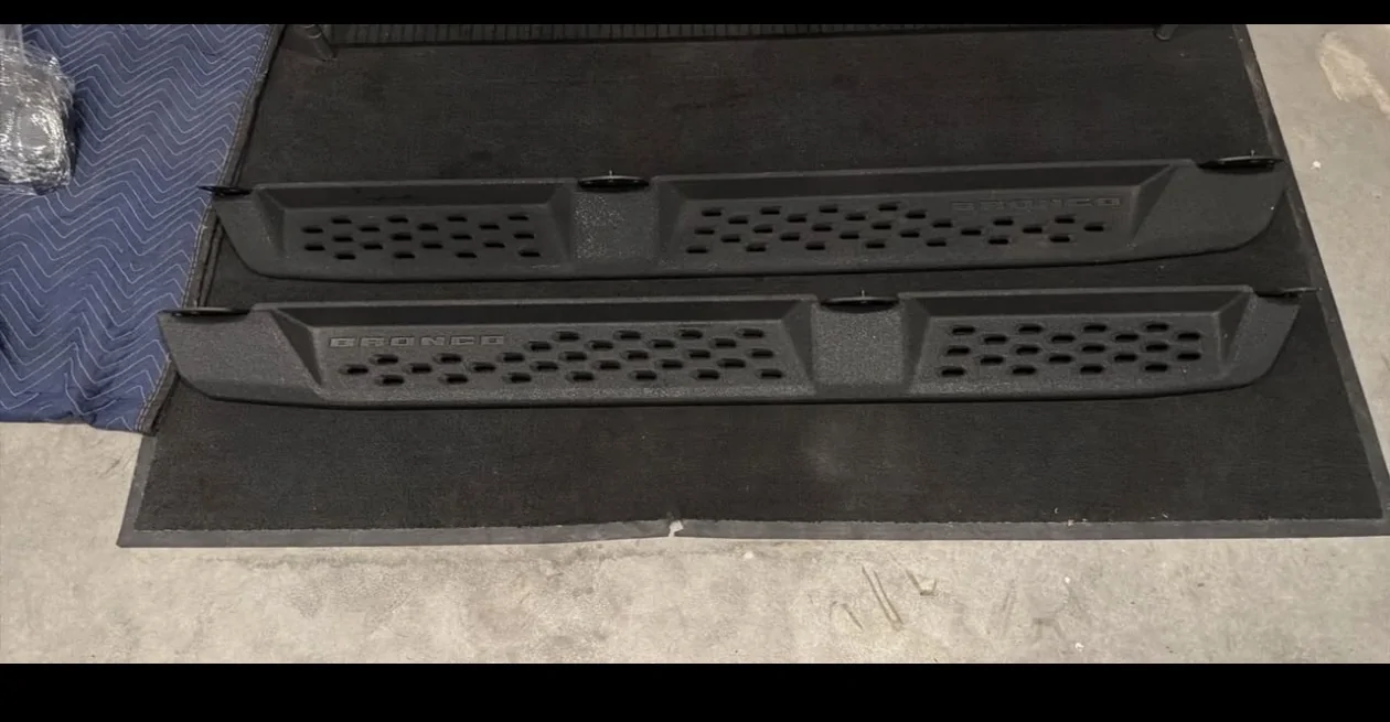

I know a guy selling a pair of raptor running boards. I have a 26 with regular rock rails. Will these fit ? Is there a way to make them fit if they don’t ? Thanks !

They fit. They use the same mounting locations. I sold and mountain mine onto someone's OBX

Do you know where on the rock rails they attach to? I don’t see any holes in them

The oem rock sliders get removed and replaced with the running boards. They both mount to the body with intermediate brackets

These ones require the specific rock rails too as they have mounting holes specifically for the boards. I wanted these on my Badlands but to get them from Ford was impractical versus other options.
Left Rock Rail: N2DZ78102D08ZA
Right Rock Rail: N2DZ78102D09ZA
... YOU NEED his rock sliders tooooo.
See if he will trade his rock slides for yours and you also buy is steps.
The steps can be attached to your rock slides BUT it's a lot of work. I did it for my 2 door
Need to drill a lot of holes into harden steel
Need to make backers that go inside of the rock slides to act as captured nuts and added support
etc

You need the complete rail and step assembly.
