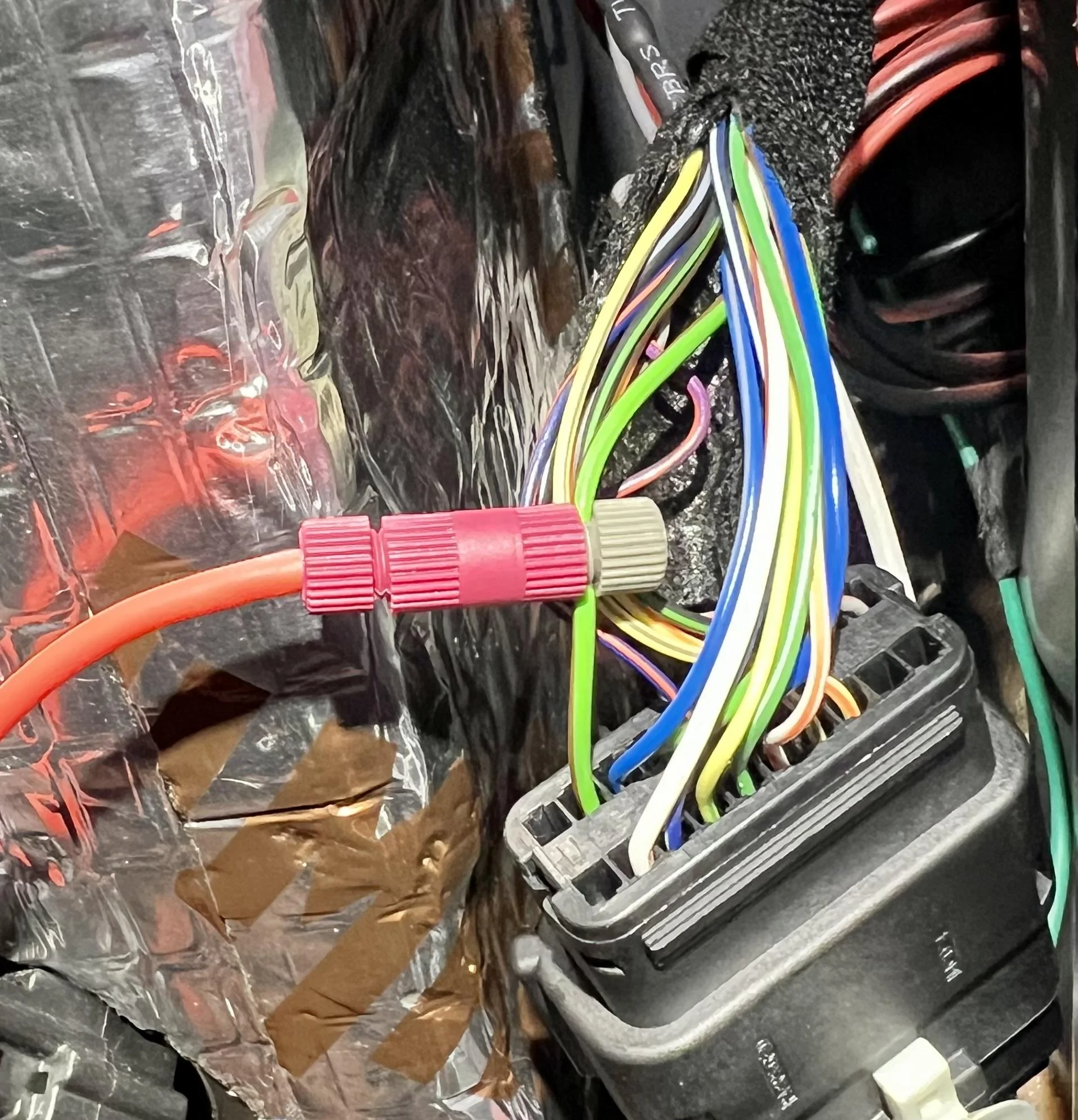

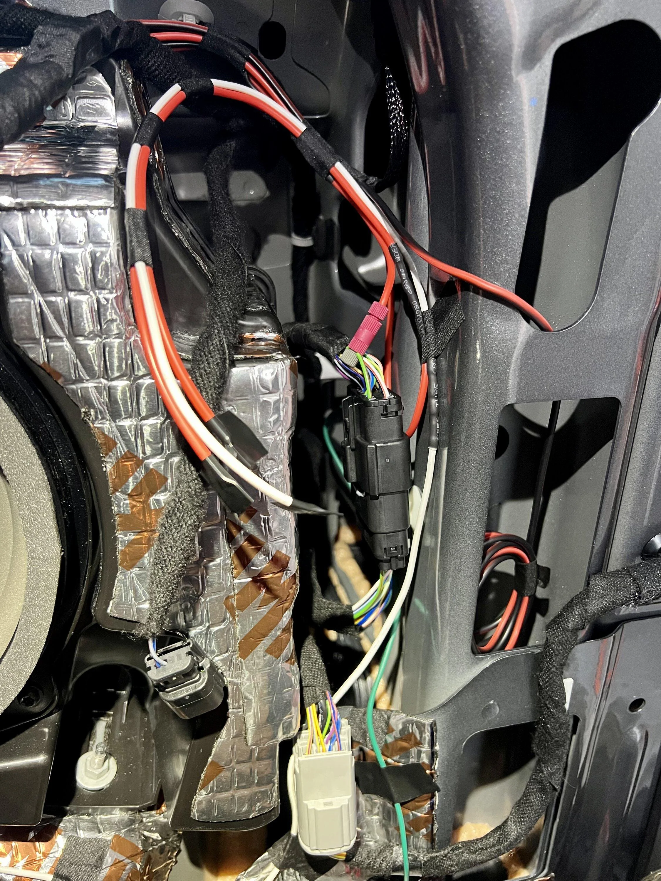

Did you get a reply on what type of diode to use?
I used a pre-packaged diode thing I found on Amazon. I like that it uses spade connectors (at the moment), so if I decide to remove one of the inputs (switch or reverse signal), I can just pull the connector off the diode thing. When I routed my wires, I bundled it up just behind that rectangular panel on the right rear.... So I would only have to remove that one rectangle to re-do any connectors if needed. Towed Vehicle Diode

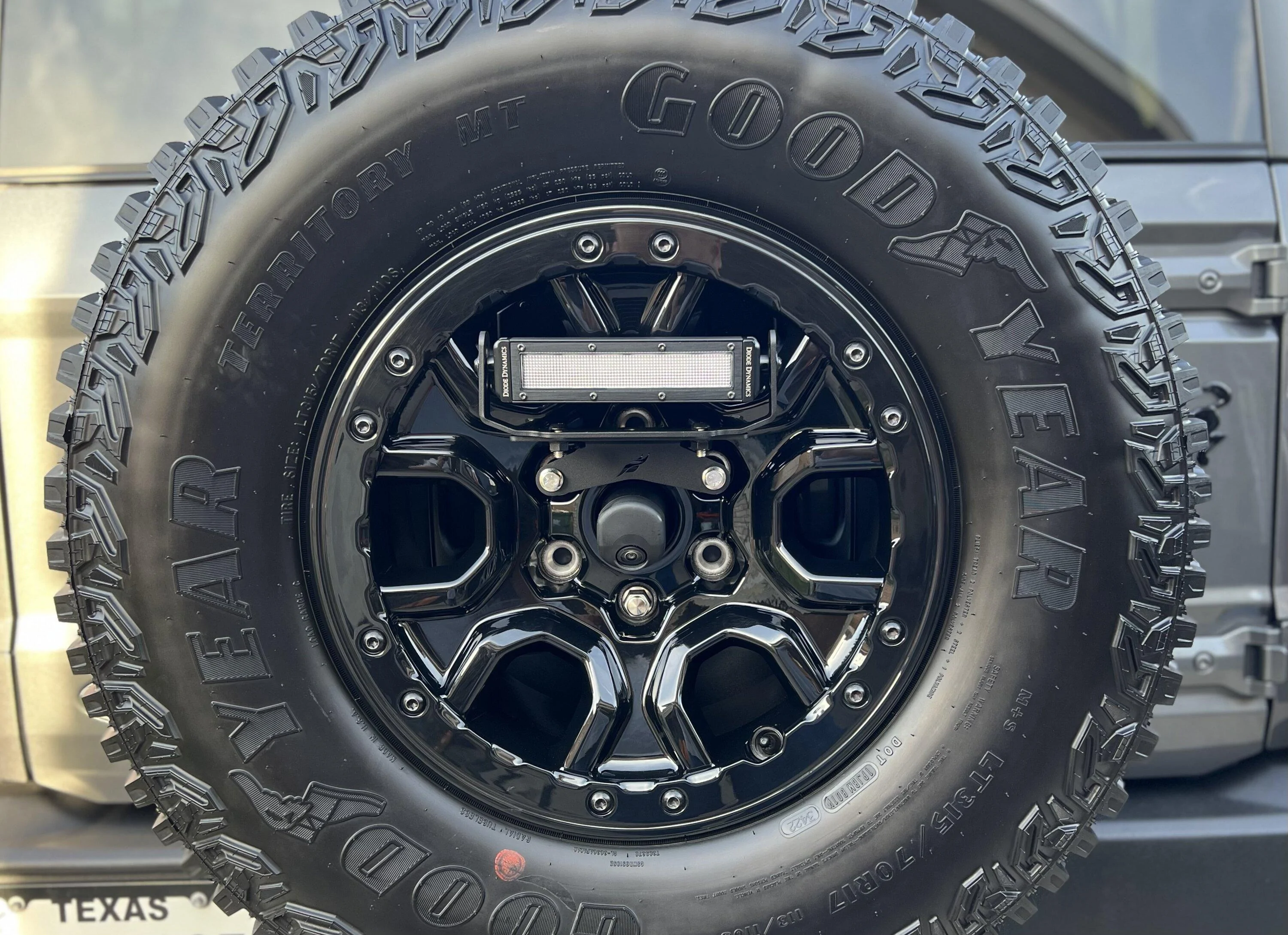

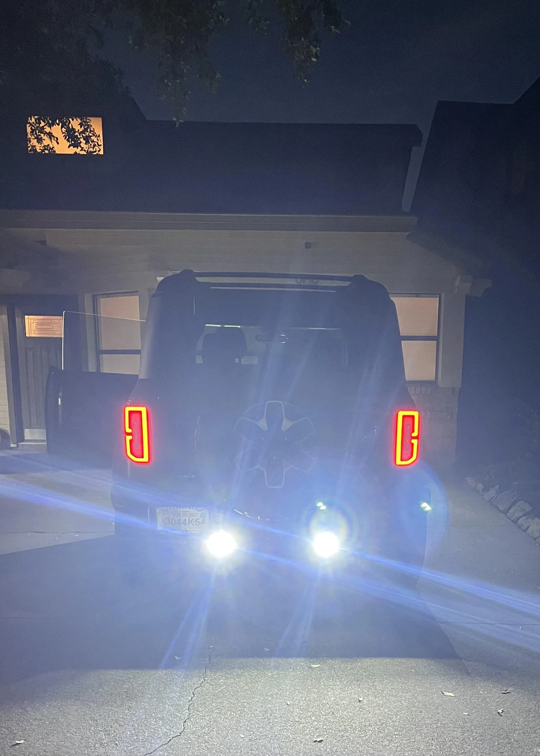

I have this set up now and it works perfectly. But I would like to add a 3rd light. Can I just splice into this harness? Thanks.

I don't know if the truck will support 3 lights on the reverse circuit. So you COULD but i can't sign off on doing that

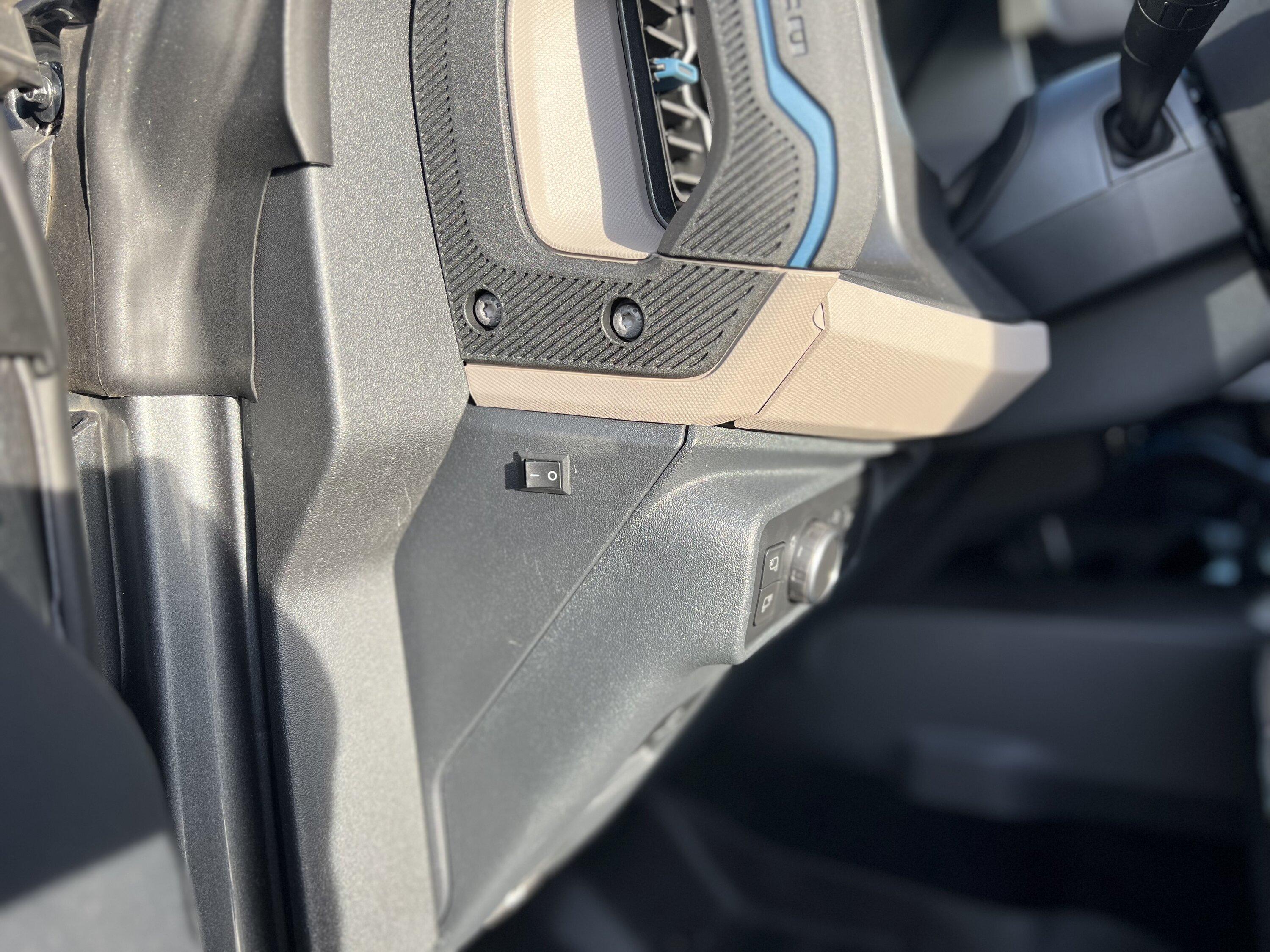

What would you recommend? Also, can I use the same harness to power from the aux switch, but just unplug the reverse circuit?

Our harness is designed to be plug and play and works with our upfitter/reverse harness (which allows you to turn the lights on from an upfitter switch as well as automatically in reverse).
WP 2-Pin: https://www.4x4truckleds.com/crystalux-wp-2-pin-reverse-harness-w-upfitter-control/
DT 2-Pin: https://www.4x4truckleds.com/crystalux-dt-2-pin-reverse-harness-w-upfitter-control/
If using our reverse harness with SSC1 or SSC2 you have to remove the DT 4-pin connector on the SSC1/SSC2 and put a DT 2-pin connector on. Our reverse harness does NOT support back-lighting.
