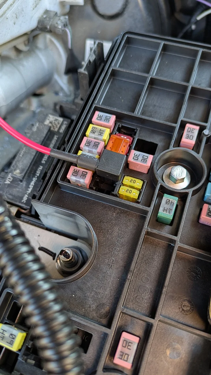

Installed the Putco LED letters, looks good and everything works fine. Just had a question about the fuse. Seems that either way you insert it into the slot, it gets blocked from being all the way seated by a millimeter or so because of the other fuses or the other plastic parts of the framing around the slots. Is that going to cause issues?

~probably~ be ok - would be best if you could get it fully seated, but worst thing is it rattles out and you have to reseat.
I would see if you can find another low amp fuse to slot it into, see if you can flip it 180, or just buy a different add-a-tap that fits better
