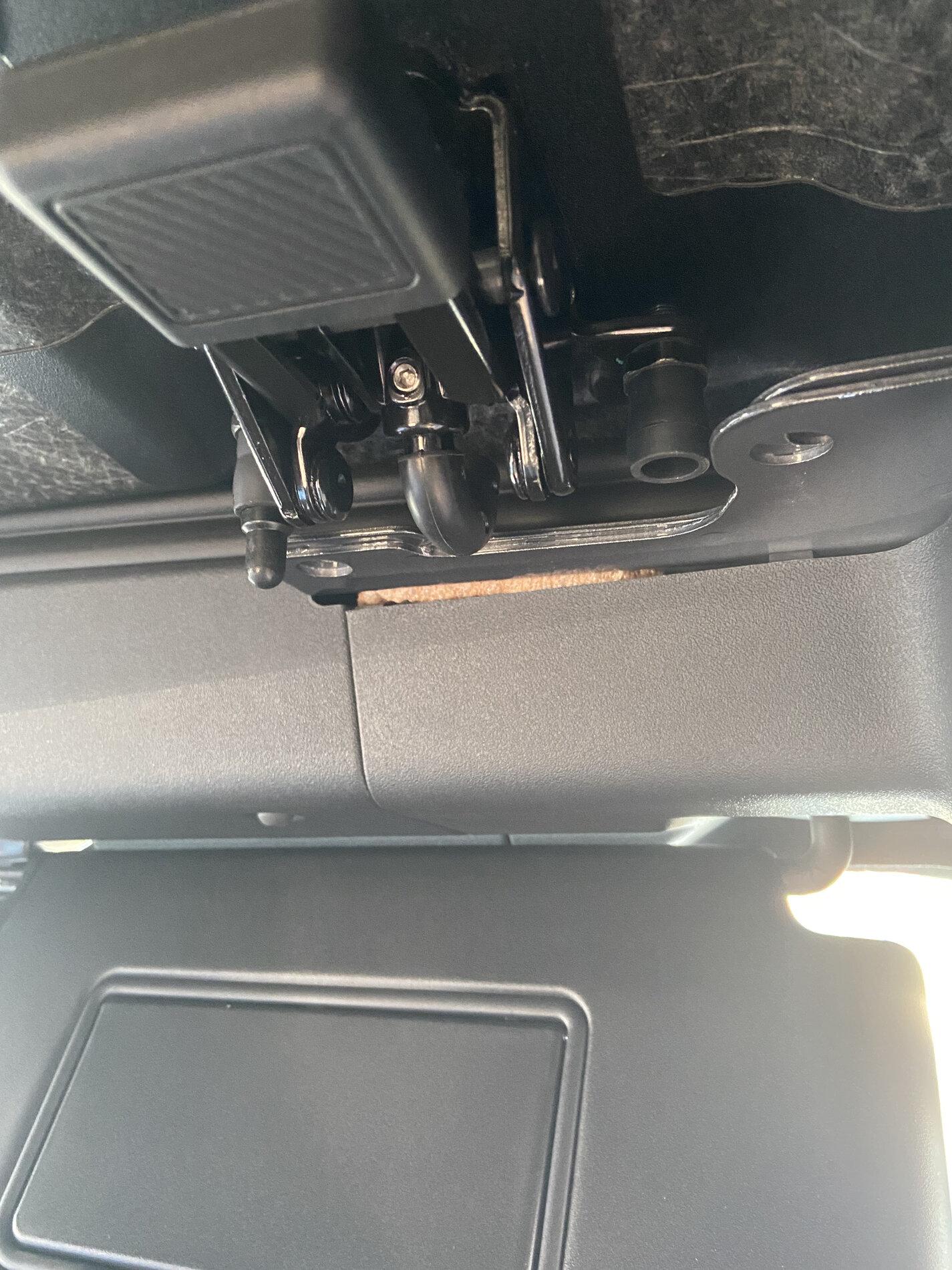

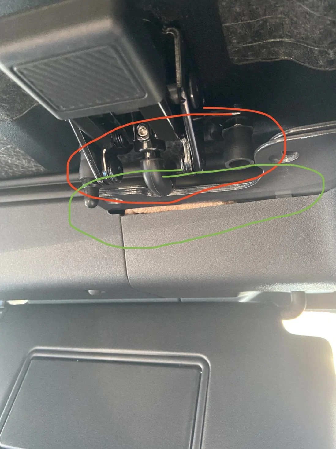

I began Friday thinking that I would get to bring My 2 door home frome the dealer.
I looked everywhere for a pre-delivery inspection list and did the best that I could.
I was not able to pick her up. She is everything I hoped she would be.
I immediately noticed that the sound deadening had not been installed.
Upon test drive, a terrible whistle was coming from the passenger side top corner above the windshield.
Pulled over, noticed that I could stick my hand in there & see day light. The latch for the roof was not latched into anything. There was nothing to latch too.
The dealership is searching for the part number and will fix both issues, then maybe I will finally get to bring her home.
Attaching a photo below so that others can double check.
She was quarantined at dirt mountain, I assumed over her top. Does anyone know who manufactured the replacement hard tops, or how I can tell that the top was replaced? I see a honeycomb pattern. Should I be concerned?

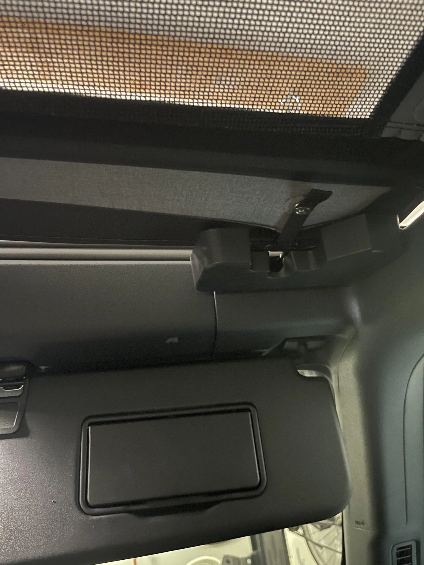

You’re talking about the missing bracket that should be wear the picture is circled in red below, but it also looks like there’s a problem in the area circled green below.
Ford Bronco Pre-Delivery Checklist 2CF7F2CA-E85B-45DD-B716-7B1805DBC9CF
Actually, never mind, the green part is probably just covered by this plastic on most Broncos. Hopefully they can get the part quickly for you guys!
Ford Bronco Pre-Delivery Checklist E31B2142-C852-4111-BD79-4C2C8E5ADBD3
It is 2 parts that are missing there. Does anyone happen to know the 2 part numbers that should be in the red and green circles?

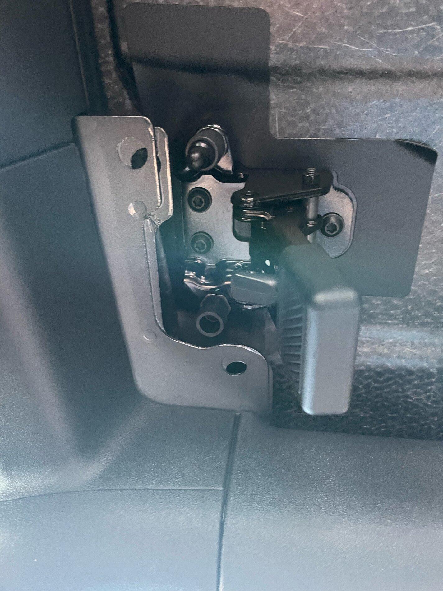

Update - My Bronco is still in service.
I received this message today.
“Im standing with parts now, what is being explained to me was this picture you can see the holes are misaligned. When they went to install everything the bolts would not fit. So we sent it to the warranty shop to realign the bracket so everything works as it should.”
Keep in mind,
This Bronco should have gone through QC at the plant, sat in dirt mountain for months, & passed a quality inspection at the dealer.
Ford Bronco Pre-Delivery Checklist A8E0B7D3-FFD6-4D23-8FFC-C8B21F80D7A9
