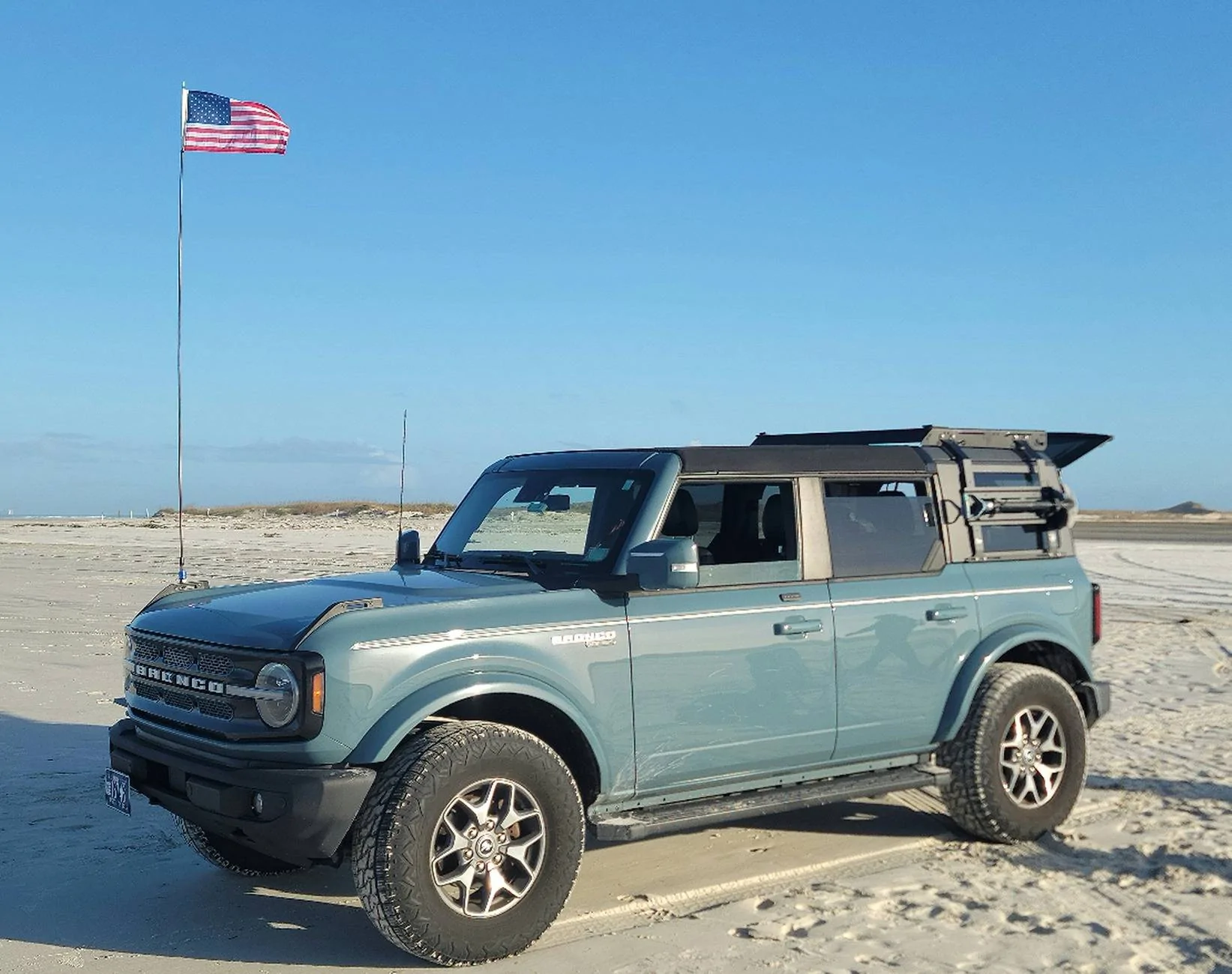

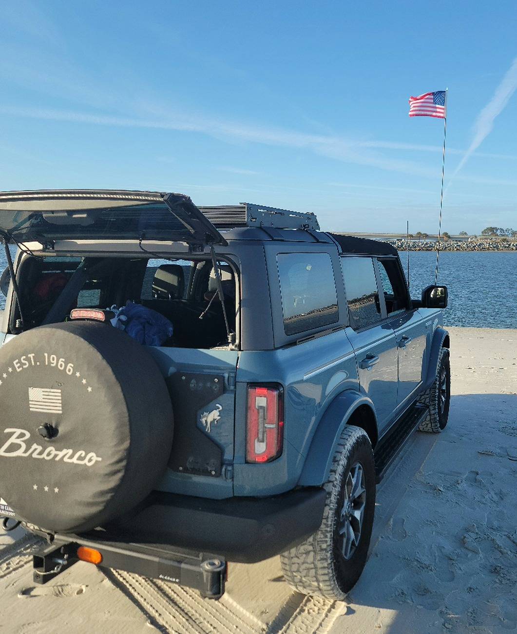

Powdercoating seems to be thought of as superior to paint and an ideal coating for off-road vehicle accessories. I have read a fair amount of complaining on the forum about low-quality coating or coatings that scrape off easily and corrode. My own experience is that powdercoat is excellent and durable unless it is scratched. My roof rack and bike rack are notable examples of durability, except where a metal hook scratched the surface of my rack.
The below article from Boat/US discusses care for powdercoat on boats, and how important it is to never scratch or invade the coating. Even the slightest abrasion can cause coating failure over time. This makes me wonder whether powdercoating skid plates and similar Armour, which are designed to scrape over rocks, is a fools errand that sets up unreasonable expectations. Bare metal or sacrificial paint seems the better choice here.
I'm posting this to suggest that some applications for powdercoating may be bad choices, or set up unreasonable expectations. Some uses, of course, are excellent! Your thoughts?

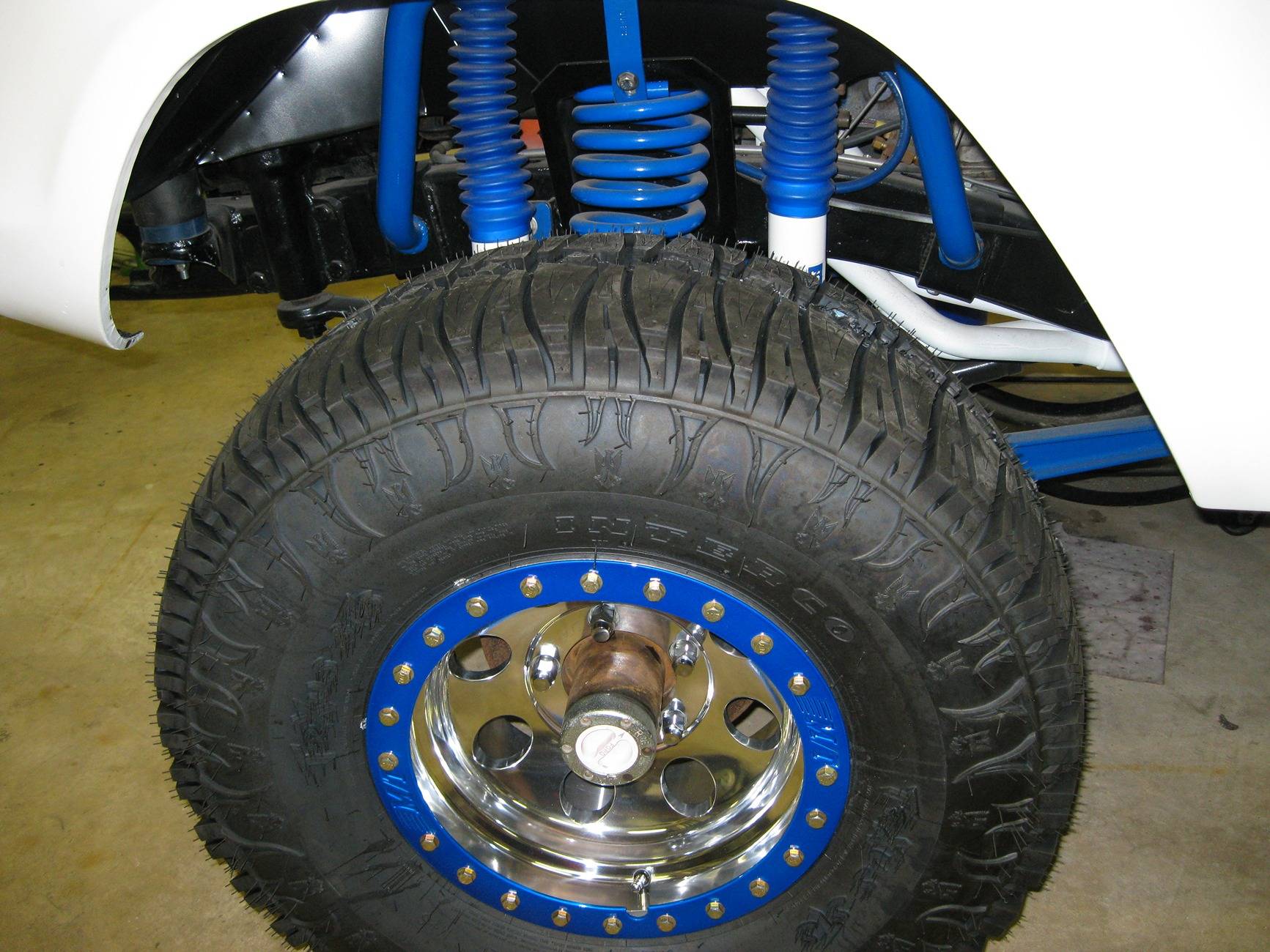

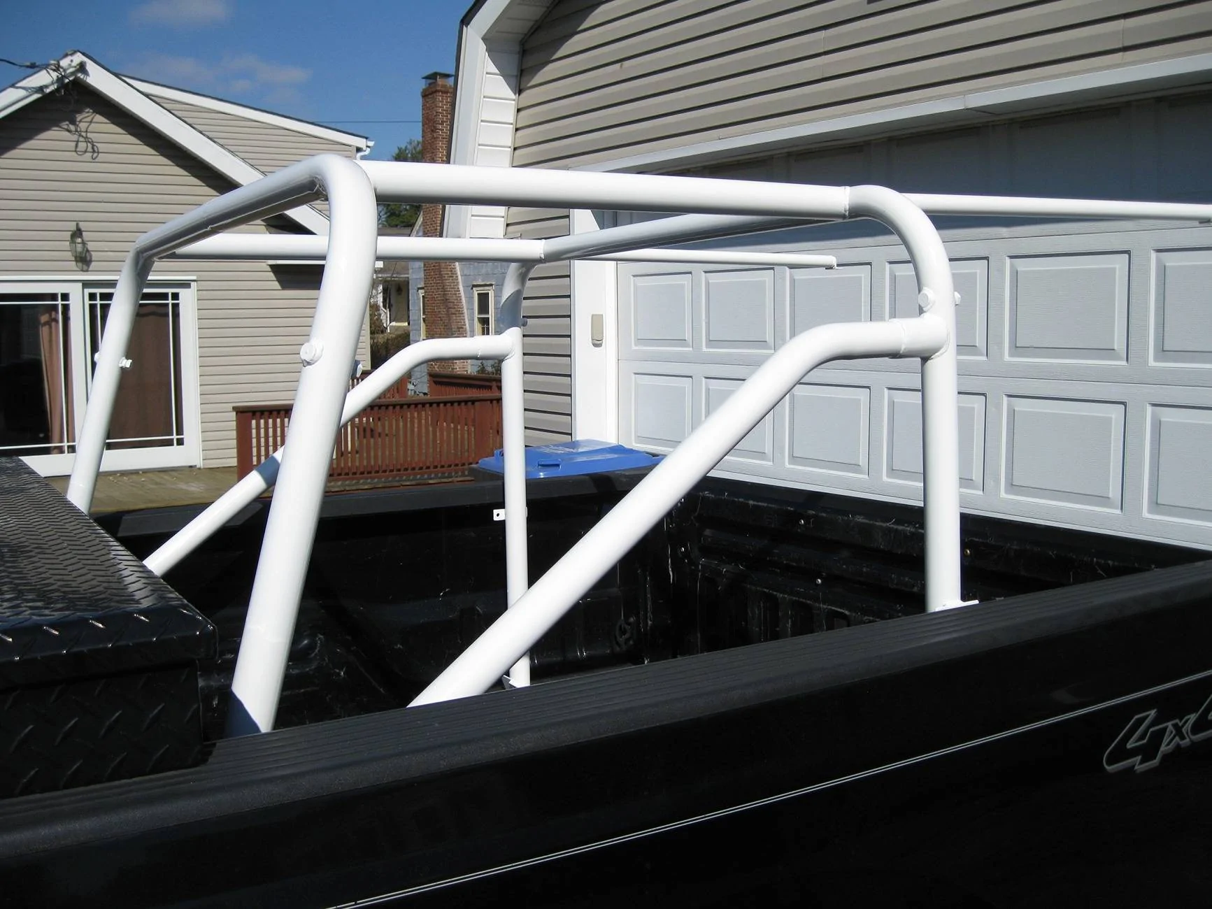

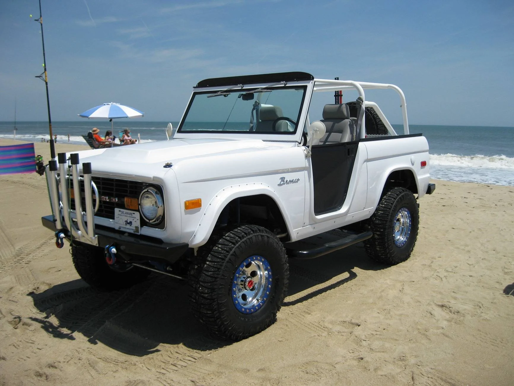

When I built my gen 1 Bronco about 15 years ago, I went with powder coating parts for the durability and at that time it wasn't much more than getting them painted.
The parts that are powder coated are the rocker guards, roll cage, spare tire carrier, front shock hoops, Radius arms, and both bumpers. All holding up very well.

Do you have a maintenance schedule or approach for the powdercoat? Garaged?

Nice ride!!!

*and that Gen 1 above is wonderful, btw!
