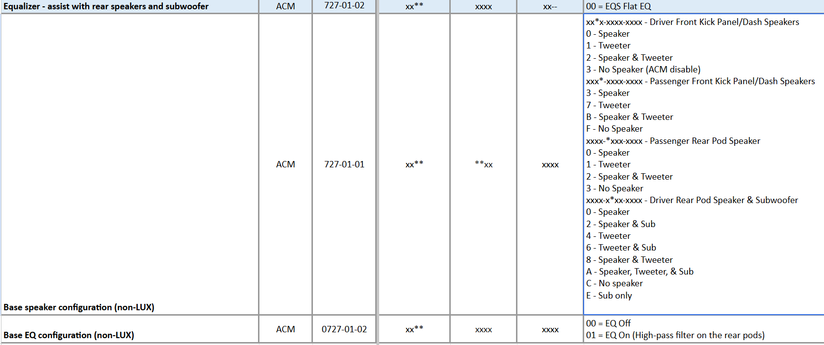

If you have the standard 7-channel, there is a Forscan setting to disable it, which may help you some. Check out this page:
https://www.bronco6g.com/forum/thre...k-sport-mode-chimes-seatbelts-and-more.28489/
You probably want the Equalizer OFF (727-01-02 = xx00-xxxx-xxxx), and for the speaker setting (727-01-01) set for xx2B-2Axx-xxxx
If you have B&O... no such luck. Only way around it is a A2B amplifier.
