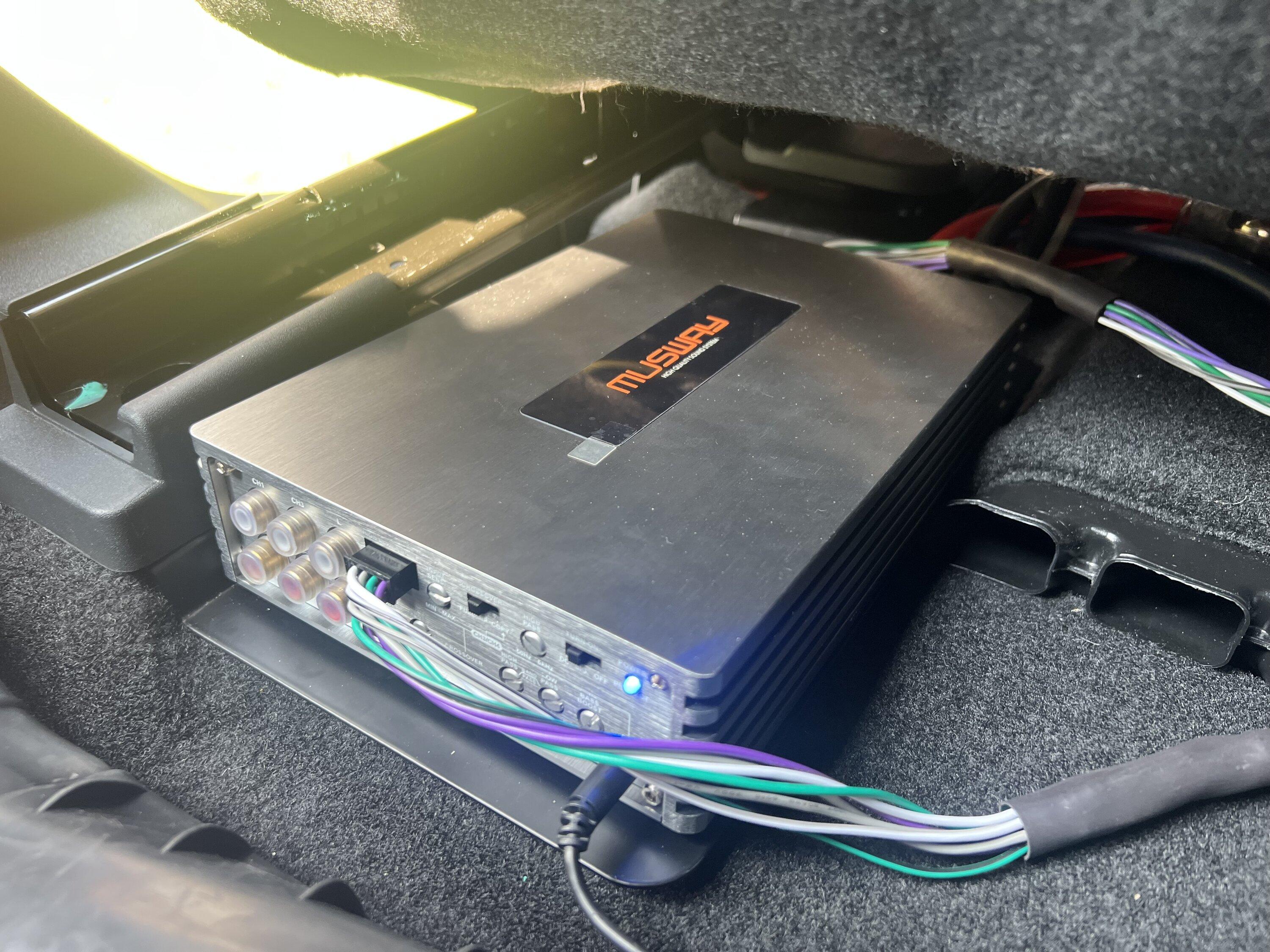

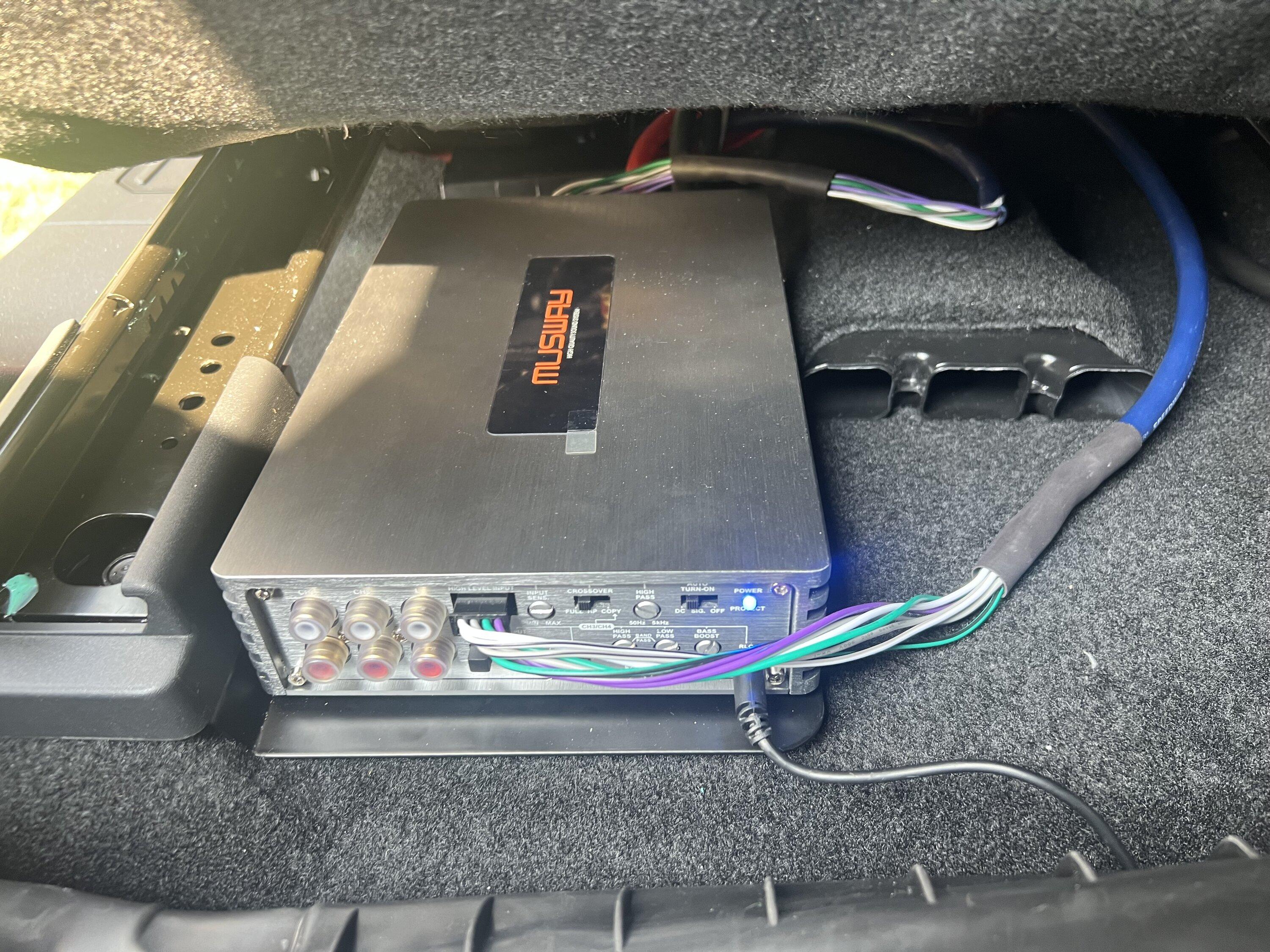

Where did you install the amp?

If you have the four-door, it can easily go on to the driver or passenger seat. Also may go under the two door as well under the seat or in the passenger rear quarter panel next to the factory sub box.

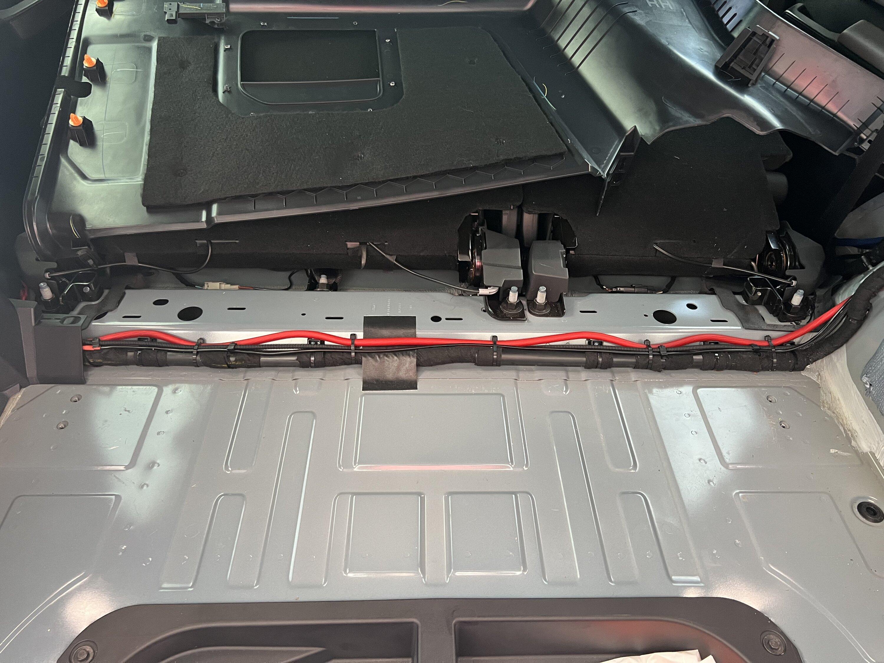

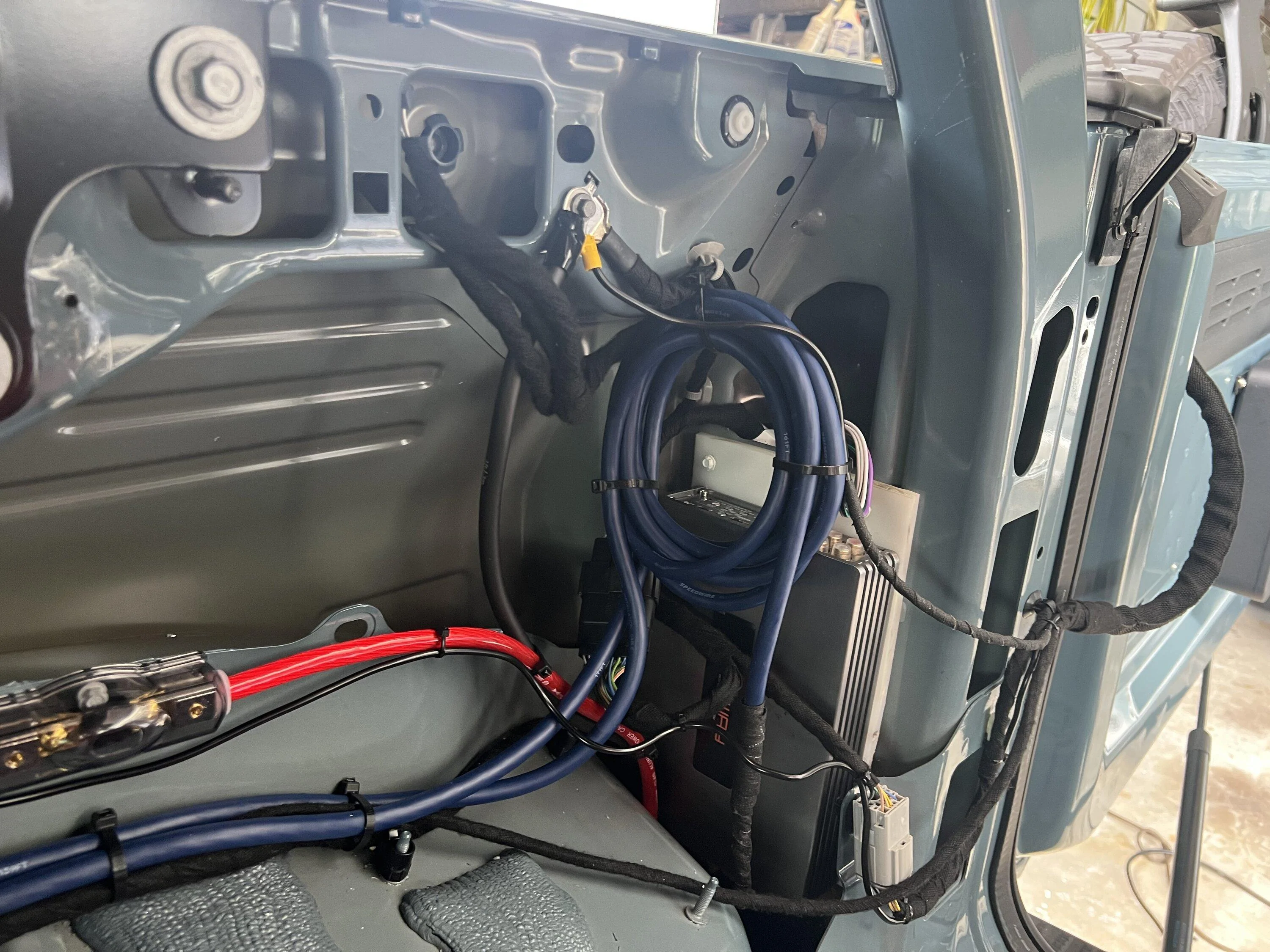

I contemplated that location but decided against it. We don’t have carpet and get the floor pretty wet sometimes. I put mine in the back passenger side behind the panel.
Wow, I didn’t know that was an option. Thanks for show me that so I may show other customers that . Did you really have a Lotta extra slack from the 17 foot harness I made you how many feet do you have wrapped up there?
Hey Joe. There’s maybe 3 ft coiled bc I ran the signal down the passenger side. What I ran short on was power wire running down the driver side. I crossed over behind the rear seats and didn’t have enough to make it to the amp. That’s why you see the fuse block in that pic. I chose to use a fuse block instead splicing, easier and cleaner. I needed 2 more ft. The amp location worked out well so long as there’s no adjustments after initial settings which I haven’t needed to do.
PS the 10” hideaway lives on the tailgate. That worked out well.
