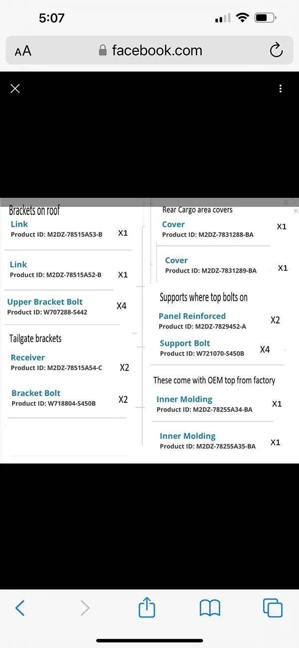

About to buy a soft top from a nice gentleman on this forum. Does anyone have pics or a part list of everything you need to add a ford soft top to a hard top only Bronco? The soft top was part of a dual top group and I just want to make sure I am able to get everything I need due to Ford parts being very confusing. Thank you

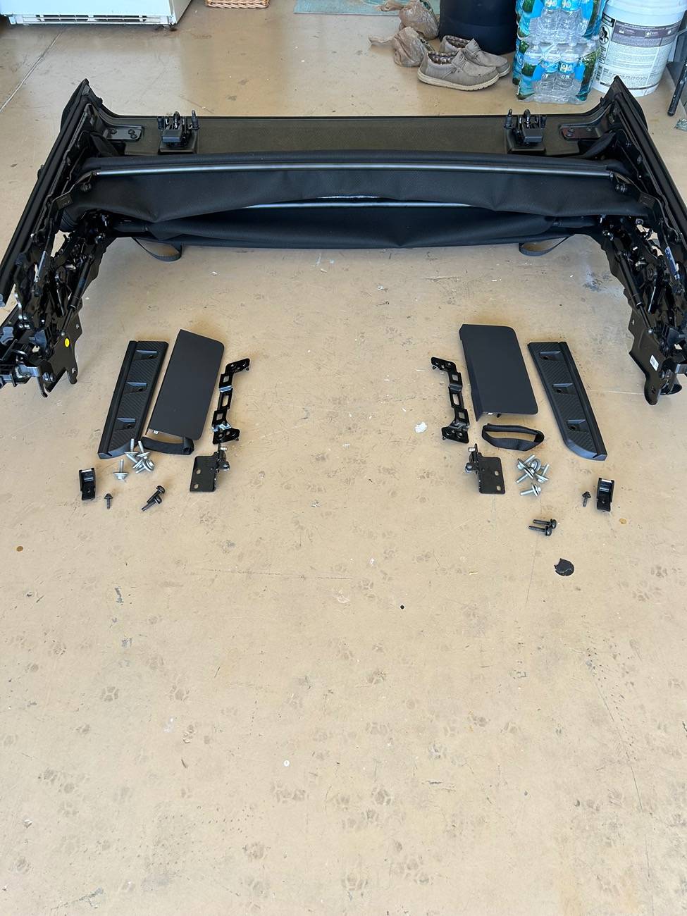

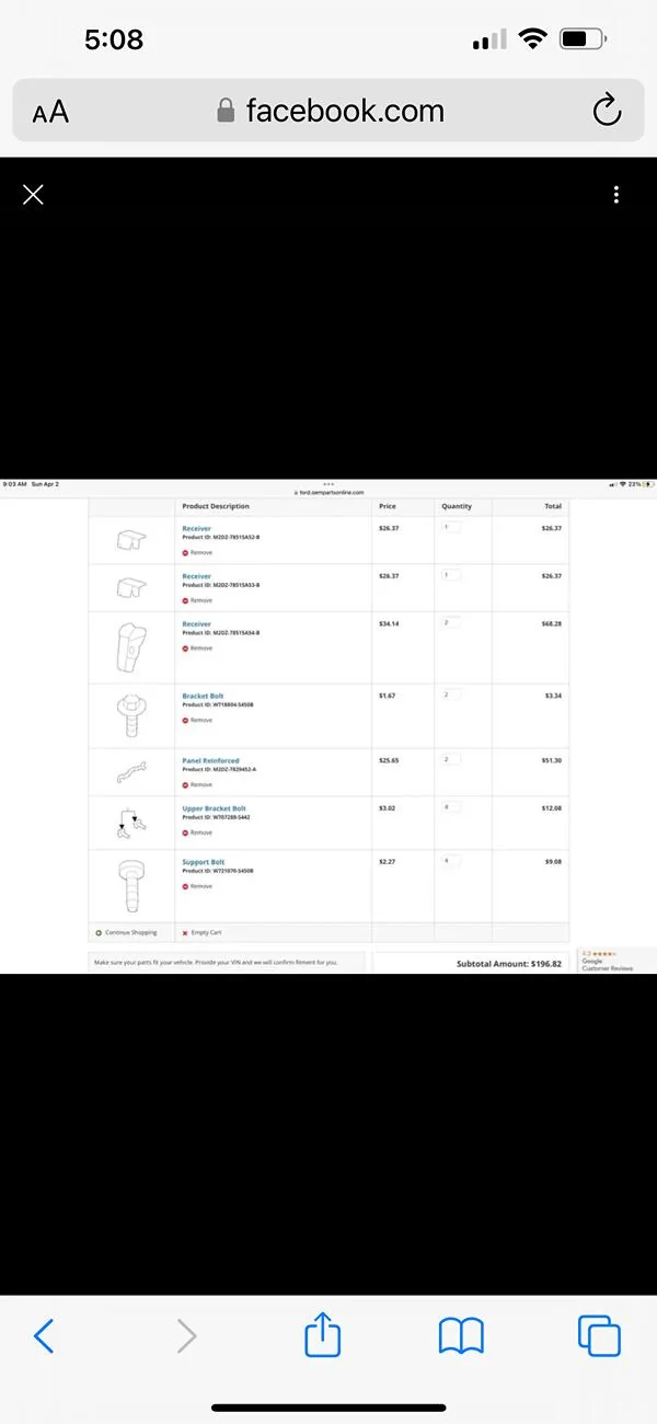

This should help

Can’t take credit for parts list. Pic of parts are from one I had.

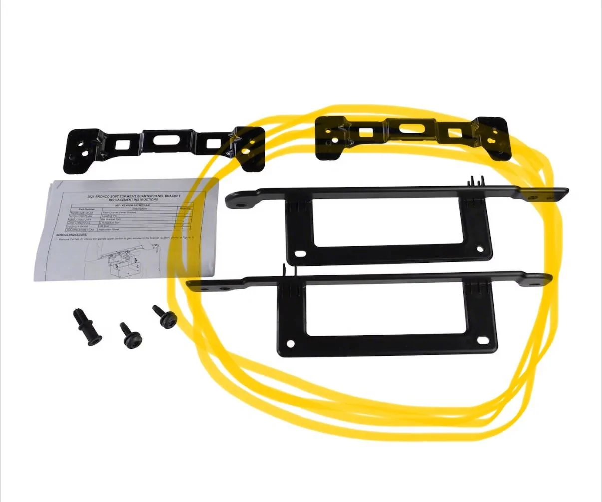

The new part # for the “Supports where top bolts on” now ends in “B” not “A” and includes 2 brackets the 4 bolts and a very useful alignment tool

The new part # for the “Supports wheee top bolts on” now ends in “B” not “A” and includes 2 brackets the 4 bolts and an very useful alignment tool
Anyone have pictures for the alignment tool? Is this something we can reproduce for people that already have the soft top brackets?
It appeared to be 3D printed. I can take a picture later today when I am near my garage full of surplus car parts…
Were you able to take a picture of it?

Unfortunately I cannot find them in my garage - it’s definitely time for Spring Cleaning! It’s possible they are in my vehicle storage facility but I wont be able to check there for a couple of weeks. Perhaps someone else can help illustrate the part for you.
