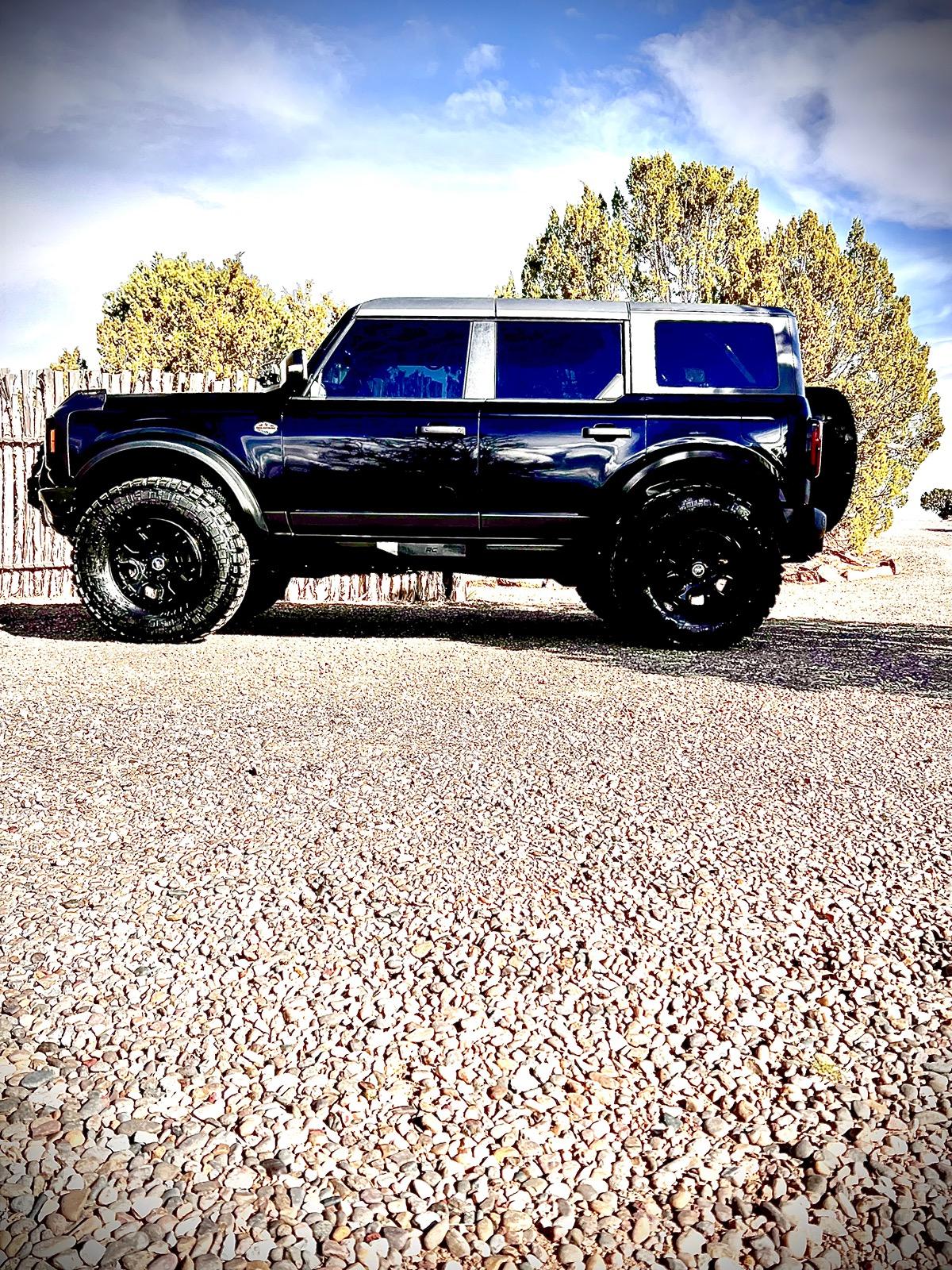

So the wife and I are debating if we should do an over landing buildout on our 23Bronco Wildtrak. We have installed the zone 2.25 lift designed for the Hoss 3.0 setup. Running 1.5 spacers with 37” tires along with the JKS clearance kit and DV8 inner fenders to ensure no rubbing at full flex.
Was going to install a full rack over the hardtop and install the IKamper lux which weighs ~ 170lbs and I’m guessing about another 150 lbs of gear in the rear.
Has anyone out there have a similar setup and how does it do on the trails and how does it do on a more extreme trail? Lastly what coils, if any, did you upgrade to ensuring proper ride height and capability or did you just install sumo springs.
A lot to unpack but thought I would ask.
Thanks in advance.
