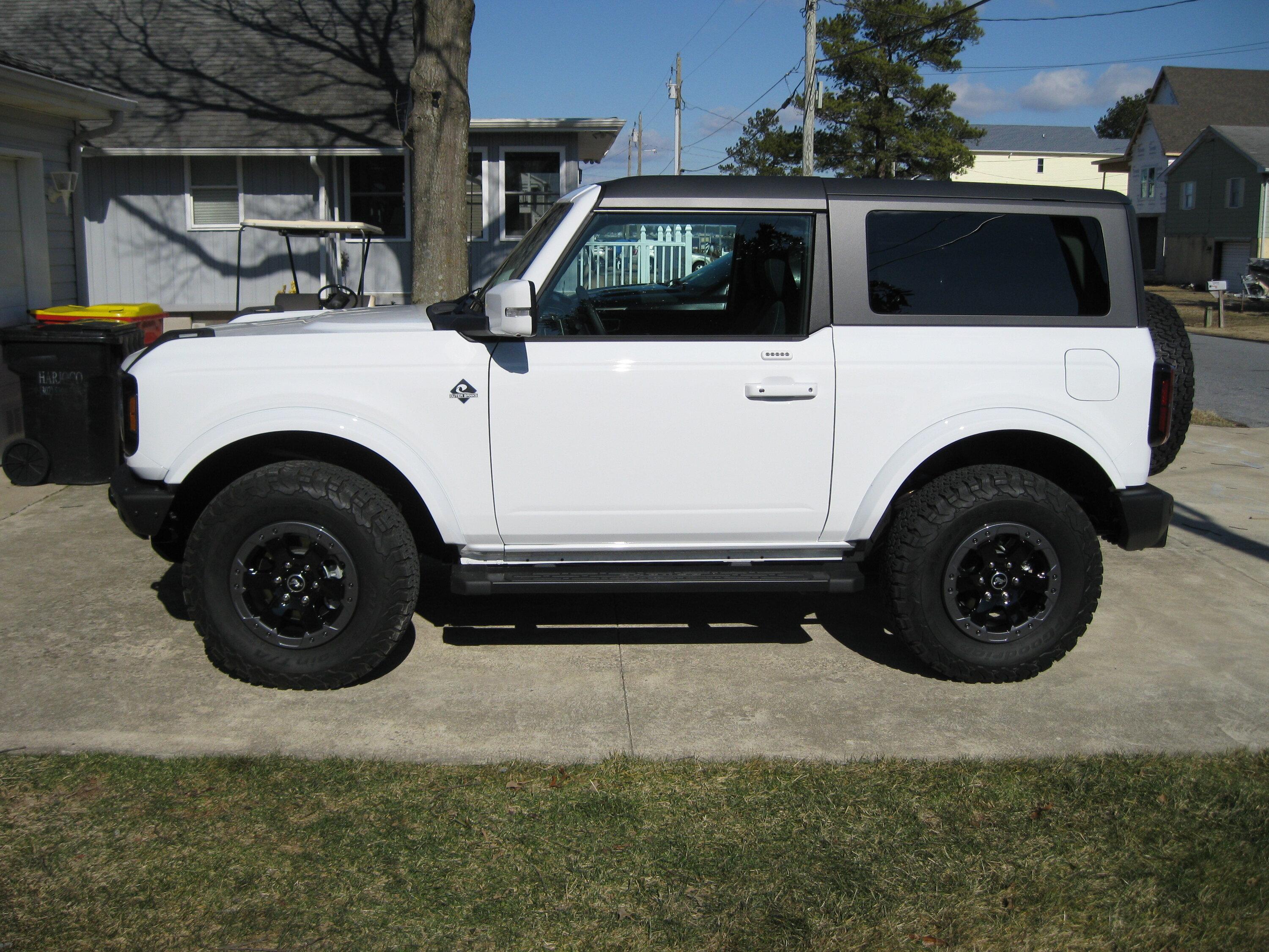

I am going to change to Analog HD white wheels for that Heritage look. I was hoping to put 285/70/17's on them. They appear to be the same height as my 18" wheels/tires.
