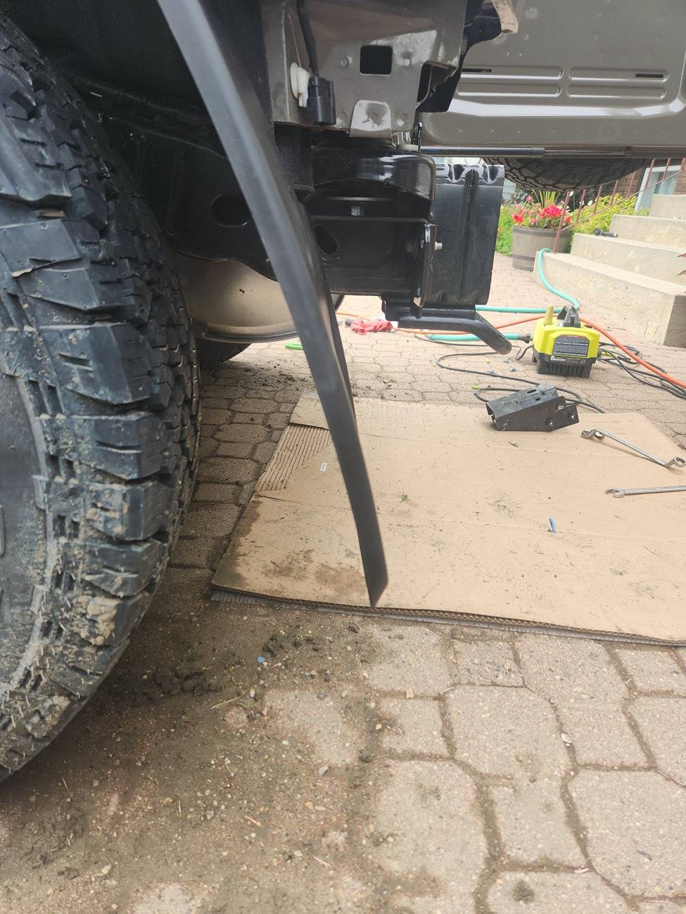

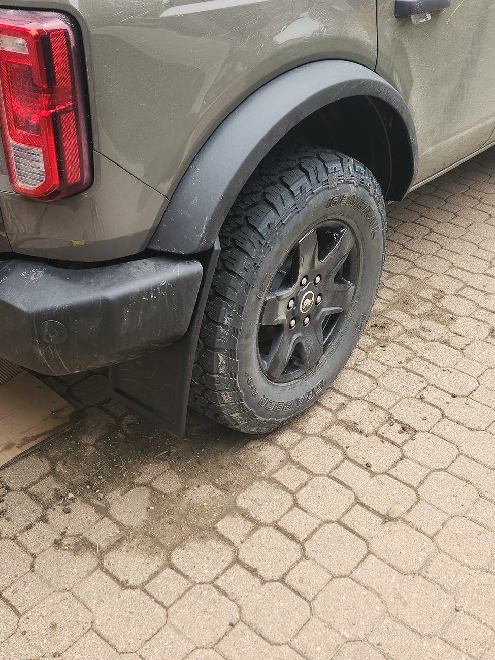

It took some finagling of the brackets to get the IAG splash guards sitting reasonably straight and not twisted. Two bends needed to be increased (parts were underbent.) I think I'll eventually make my own guards that are a lot more svelte - that's a next year's event. I have too many other vehicle projects to handle first.

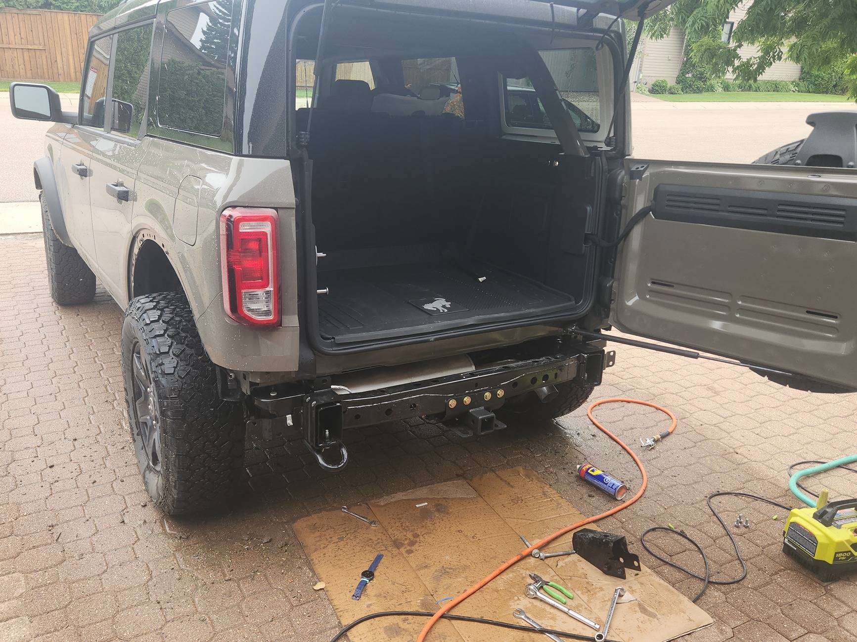

That's an amazon hitch: Nilight 2 Inch Rear Trailer Hitch Receiver Kit for 2021 2022 2023 2024 Ford Bronco 2 Door 4 Door (Exclude Bronco Sport) Rear Bumper Tow Hook Black Hitch Cover Kit : Amazon.ca: Music For $99 CDN you can't go wrong, welds are great and coating is better than the factory frame.
I'm not doing the wiring, it's just for a bike rack that I'm building/other rear mounted racks. Fits great, you wouldn't even need to take the bumper off but ford puts 8" long (hardly an exaggeration) bolts into a bracket solely for the wiring plug rough in, with the heads facing backwards so unless you snip them off you'd never get them out. Oh well - the bumper comes off with 3 bolts and two wiring clips, really nice, super light weight.
