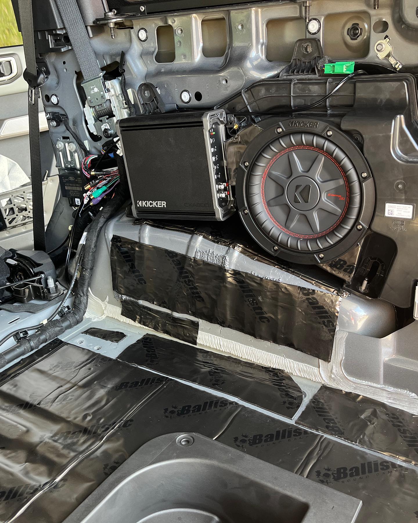

Should I rubber-mount (rubber washers) the enclosure back into the cargo area
This is what I did using sorbothane top-hat style bushings/washers at each of the mounting locations. This is in addition to CLD application and stuffing the quarter panels with an acoustic treatment. Basically floating the enclosure to avoid hard on hard contact.
Be aware that there is not a lot of free space available behind the trim panel. Some jiggering of any non-oem amplifier mounted in the same space may be required.
For the OEM enclosure, I took a slightly different approach than most and first focused on increasing the rigidity of the plastics. The plastic is thin and resonant. This was accomplished using an epoxy mixed with hollow glass spheres which was applied to the interior.
The port was sealed using the same epoxy mixture. An appropriate driver was selected that would work reasonably well within the enclosure volume while also avoiding over excursion. WinISD can get you close.
It was a bunch of work but turned out pretty good. Sympathetic vibration was greatly reduced overall.

I did both dynomat and poly fill. I also, put dynomat on the inside of the outer panel.
Did you plug the port? I had to on mine. Once I upgraded the woofer, I started getting a lot of port noise.
Yeah, I did have to plug the port.

Next time I have the rear end apart I plan to plug mine - I didn’t and it gets really boomy at particular frequencies

Ultimately you would want to avoid the plastic enclosure. There is too much give in the material. Dynamat will help as it adds mass to a moving panel which helps it move less/slower. The polyfill packed loosely makes the speaker behave like it’s in a larger enclosure. All are improvements but not ideal. The port noise is caused by upgrading to a larger sub and power with too small a port for new driver/power combo.
