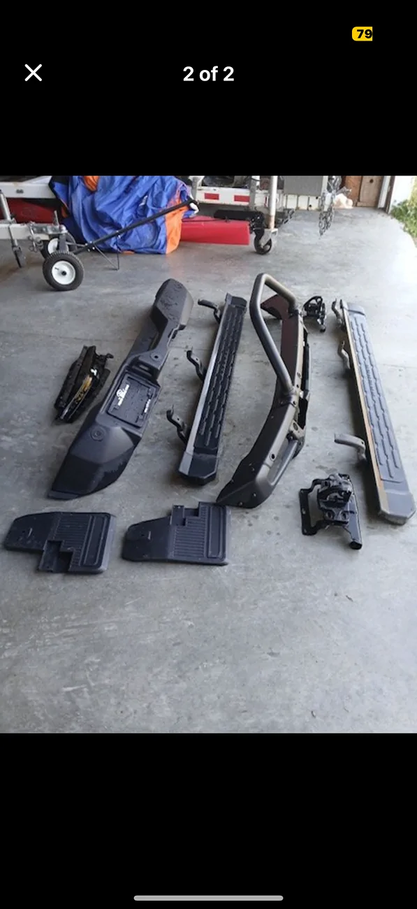

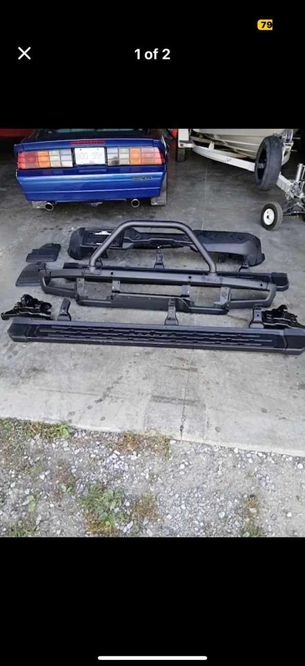

Hello, I was thinking of picking up this OEM steel bumper that came off of a bronco. Do I need any more hardware with it? Or do I have everything needed already with what I have on my bronco? I noticed it has some open slot areas for fog lights and such, but I have a 2025 base bronco that didn’t come with fog lights. Are there covers or something like that to cover up the holes or what should I do? I’m picking this bumper up for like 300 bucks.

Looks like it's only missing 2 plastic covers, that cover the hooks. The mod bumper doesn't come from the factory with foglight, nothing is missing there.
Missing some hardware,(may not be in the photos). Can't tell what's above the rear bumper in the second photo.

I don’t see the bolts for the recovery points (3 per, they don’t use all 4 holes iirc) but you may be able to reuse existing bolts from current bumper there. Thats about all I can see from there though, since the bumper is mostly assembled it looks like it will have all the small hardware / Bronco bolts / etc
If you have the plastic bumper you will either need to cut off your existing tow hooks or get new intercooler mounts - as the plastic hooks are integrated with with intercooler mount and you can’t just remove them like you can with the steel bumper. So be prepared for that too.

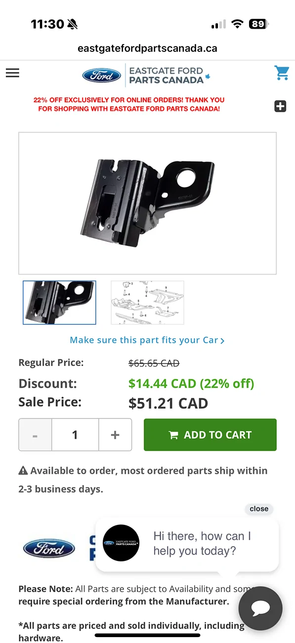

Whats option 2 exactly? Which part do i need? Im leasing

Thanks! So i for sure need this bracket to install any steel bumper at all, or just for the steel oem ford one?
Depends on the bumper but most will probably need it (or cut them off) as those tow hooks from the plastic bumper stick straight out

Is this the part and do i need two of them?
i cant start cutting things because its a lease

There is a different part number for right hand and left hand. Read the post I linked for the proper part numbers
