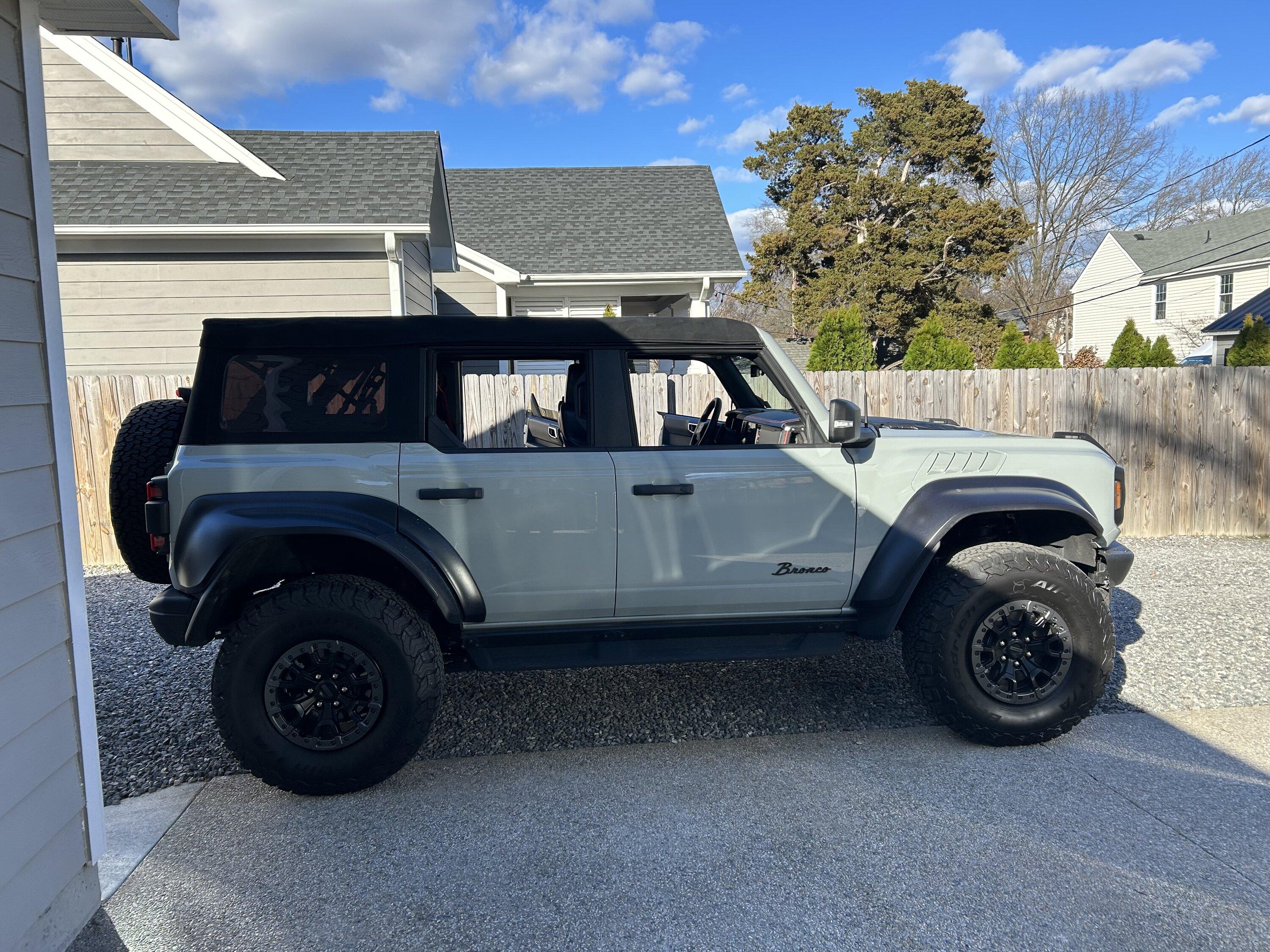

I think that there is some confusion here. Maybe it's just me.... haha There are technically two "Ford" soft tops. One that's made by a company named Webasto who also makes the hard top. The Webasto soft top is ONLY available by ordering a soft top Bronco from the factory. The second soft top is the soft top that Ford sells as an option to purchase individually. This soft top is made by BesTop
The Webasto top fits the Raptor 100%.
So in theory if I buy a takeoff oem, from the factory, soft top from another 2022 Bronco then it will fit on the Raptor?

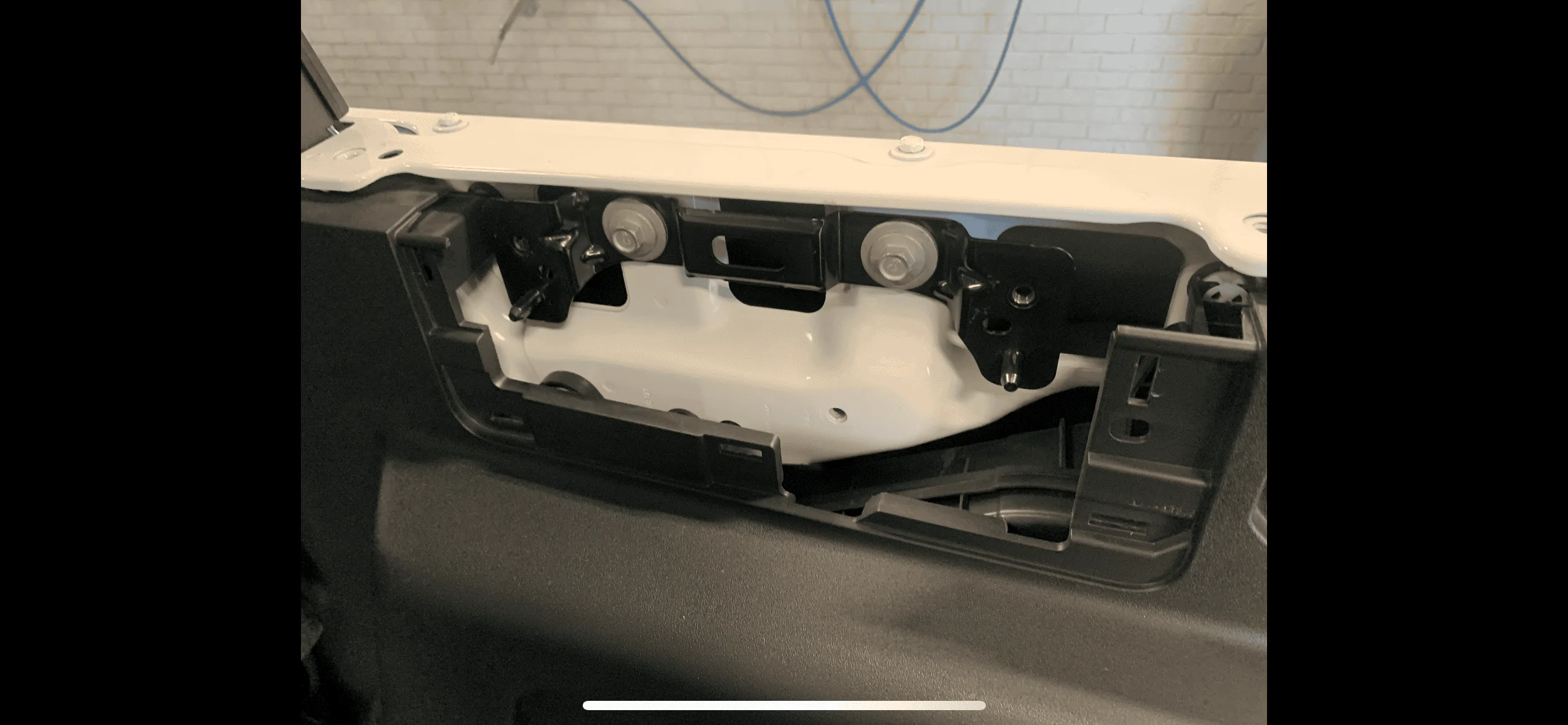

Mind helping me with a little issue I'm having....
I bought a 2021 OEM soft top off someone for my late 2022. The mounting holes on both sides do not line up at all.... Can you maybe help out with your experience...
I just posted the issue on the forum. Am I missing something...?
https://www.bronco6g.com/forum/threads/soft-top-mounting-holes-changed-on-newer-bronco.68641/
Yes you are just missing the brackets. The top two bolts on each side mount to a bracket and the bottom bolt on each side mounts to the body. This also happened to me last summer. You just need to ask that person for the brackets. I tried to look up a part number for the bracket and was not successful then.
Does this interfere with or require removal of the center brace or are the mounting points behind the brace/bracket?
Yes, if you have an OEM take off top then it will fit with out touching any of the raptor bracing.
Thank you so much!!! Thought I was in trouble there! I’ll get that!
