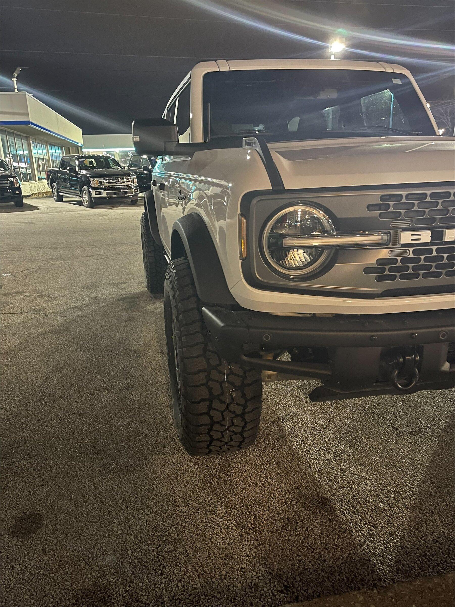

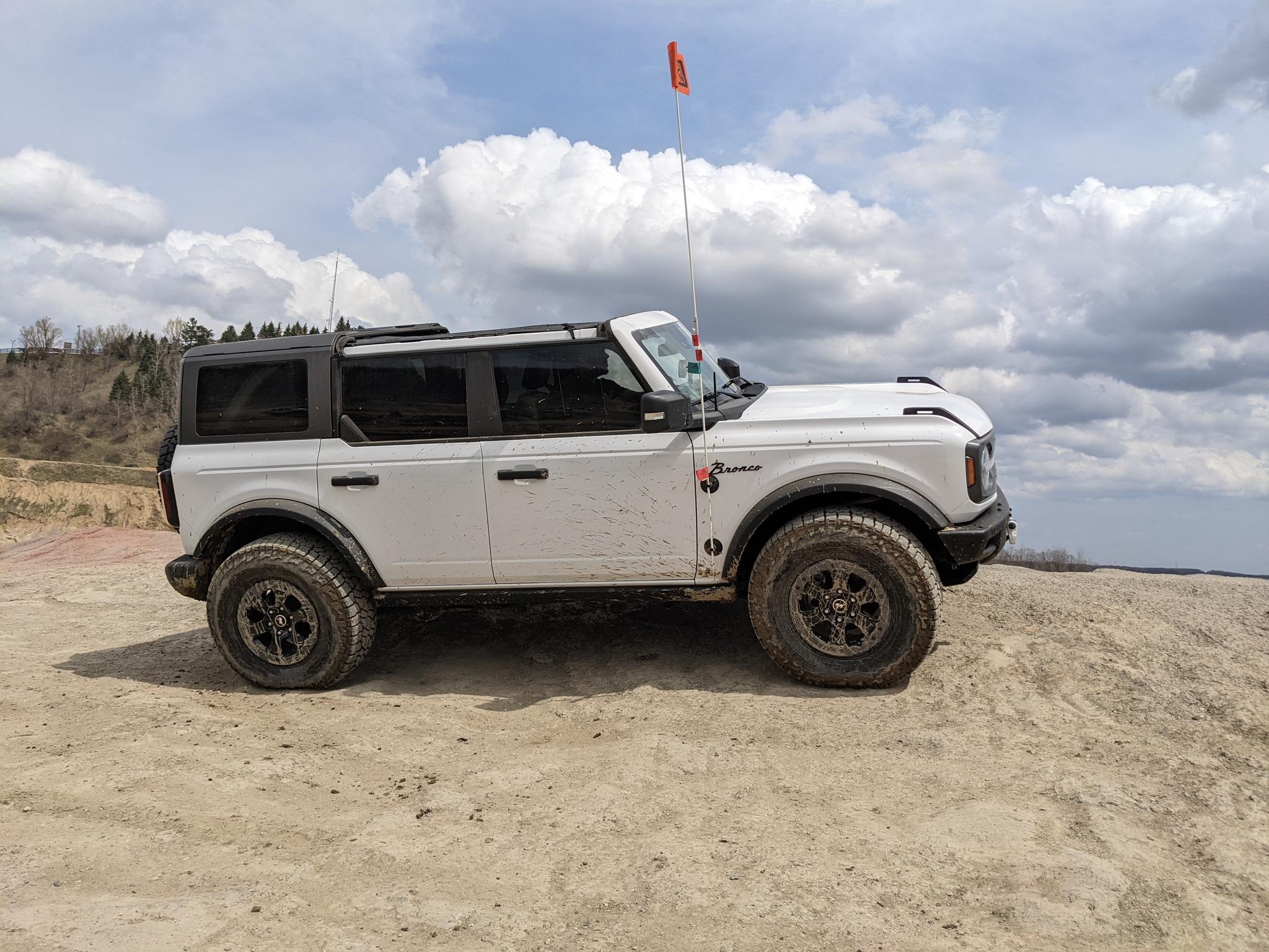

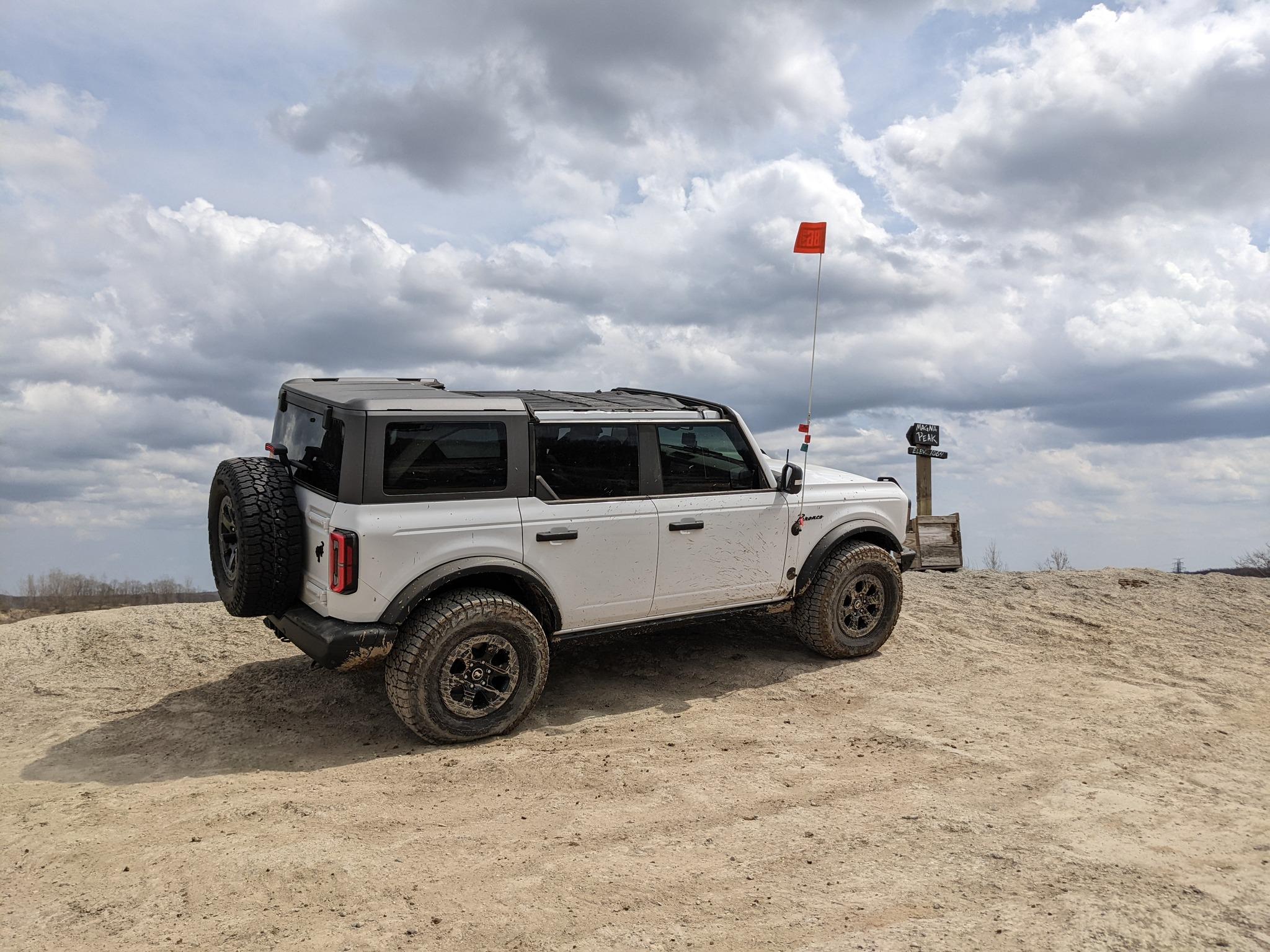

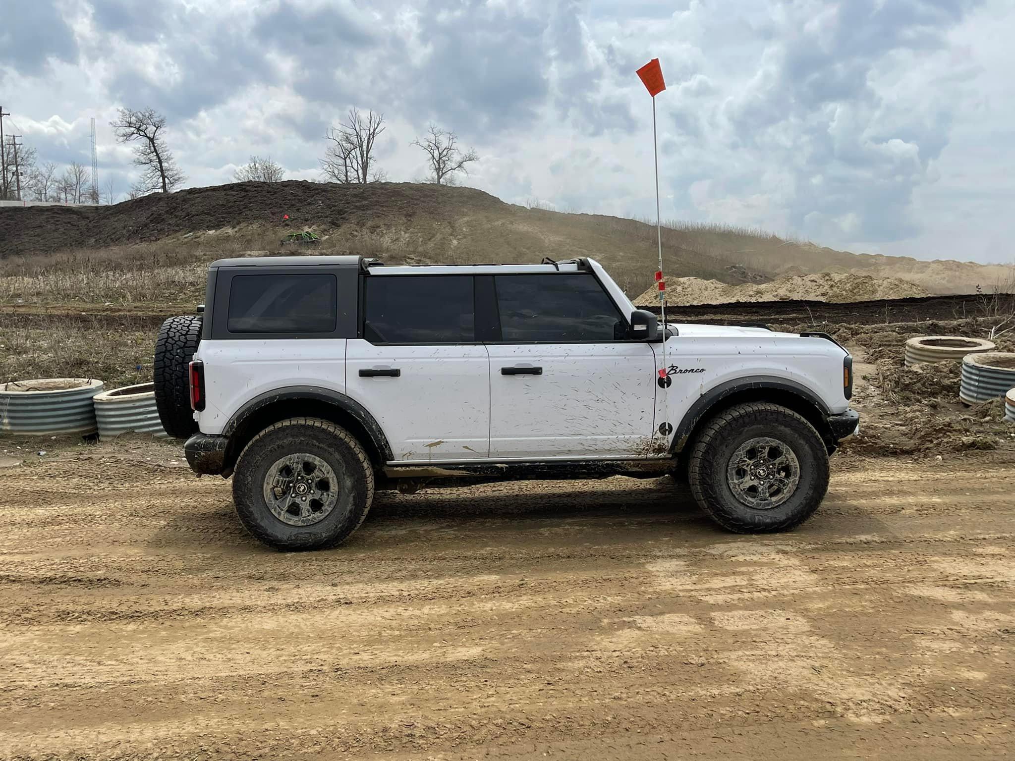

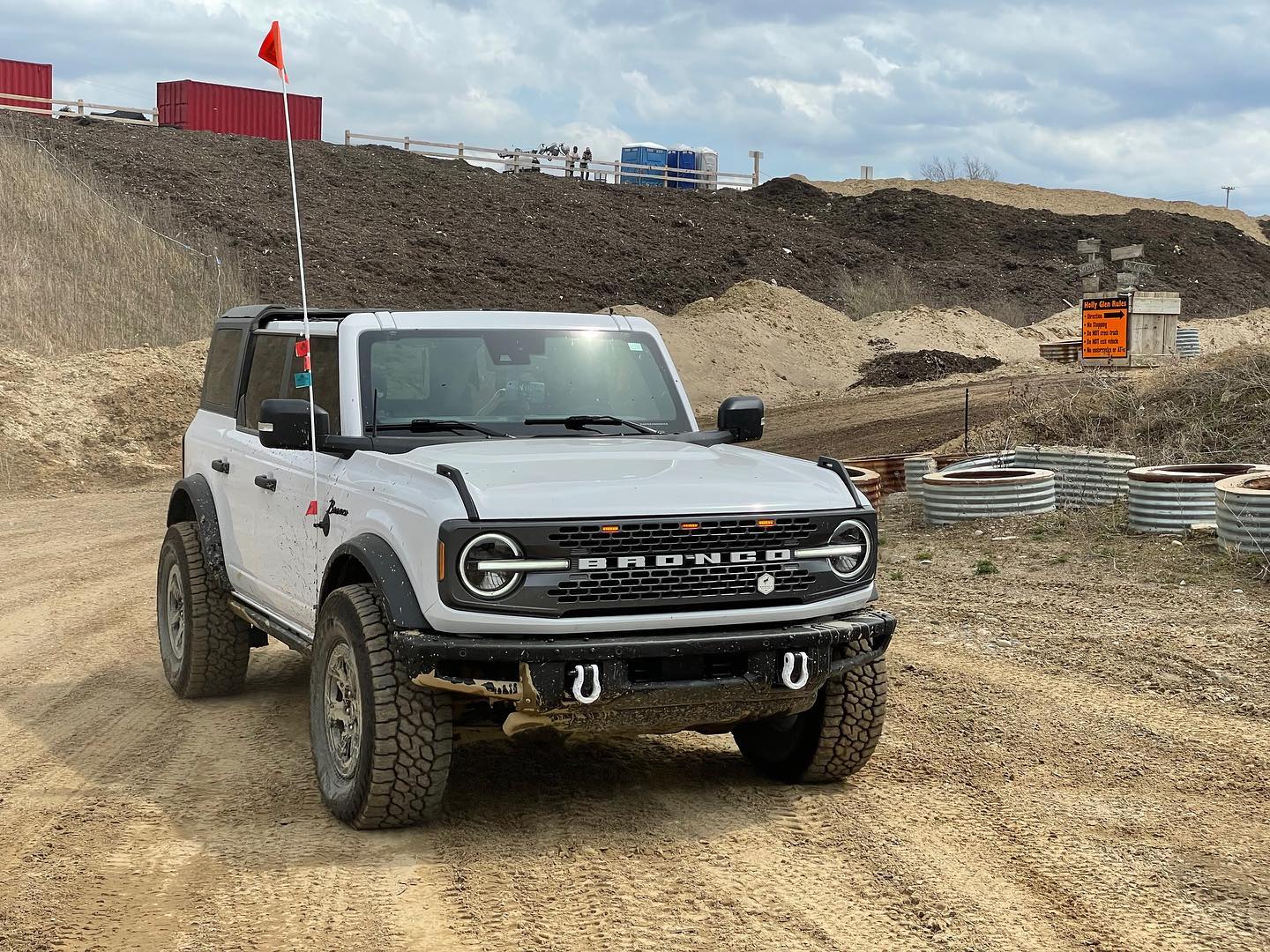

Posted these before. stock BL alternate wheels. No lift, 1.5" wheel spacers 315/70/17 tires
EDIT - Only removed crash bars -
Ford Bronco Non SAS Badlands 1 inch level bettys354
Ford Bronco Non SAS Badlands 1 inch level front shot
Ford Bronco Non SAS Badlands 1 inch level side shot betty
Ford Bronco Non SAS Badlands 1 inch level top of Magna
Ford Bronco Non SAS Badlands 1 inch level top of magna2
