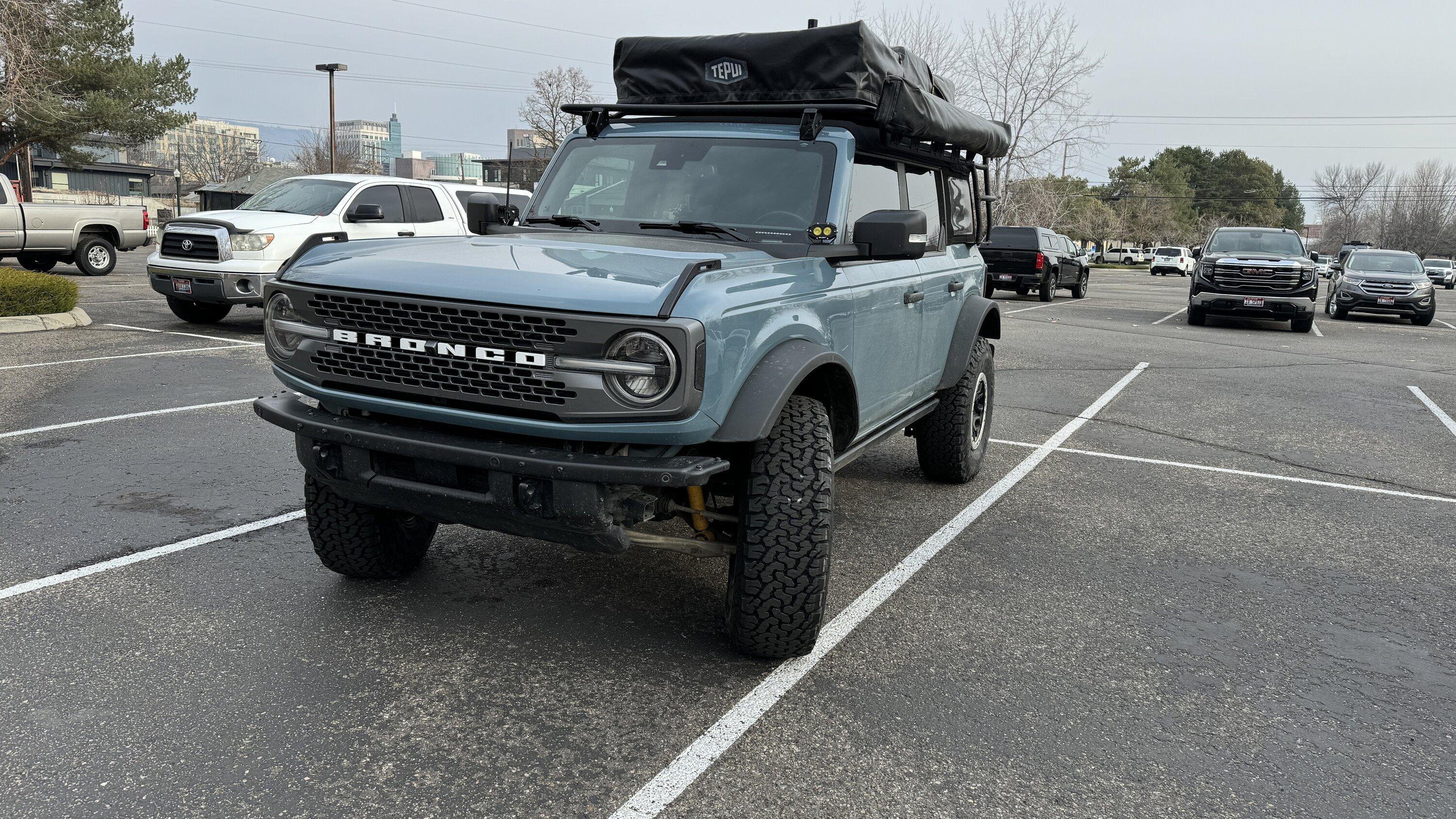

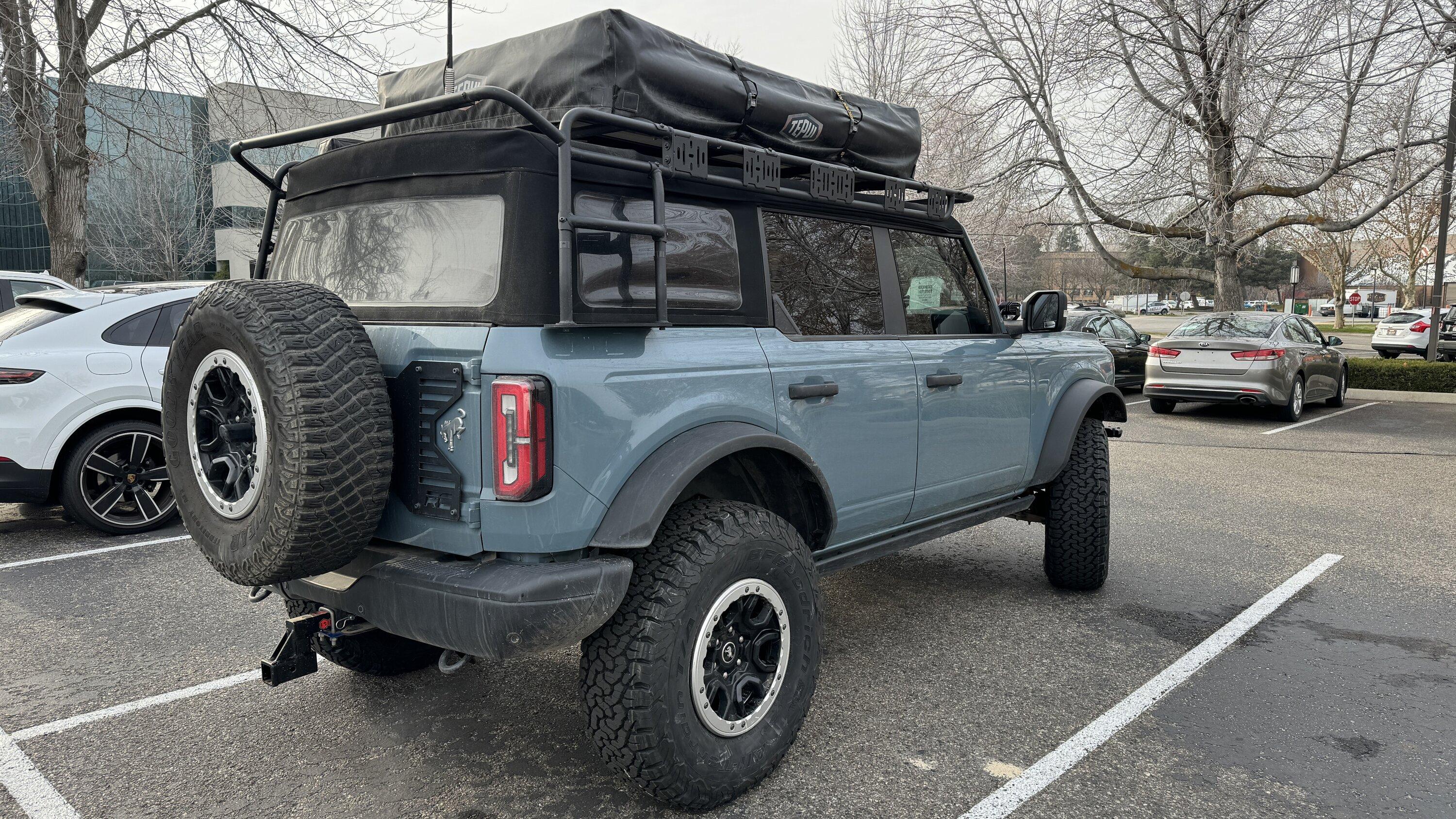

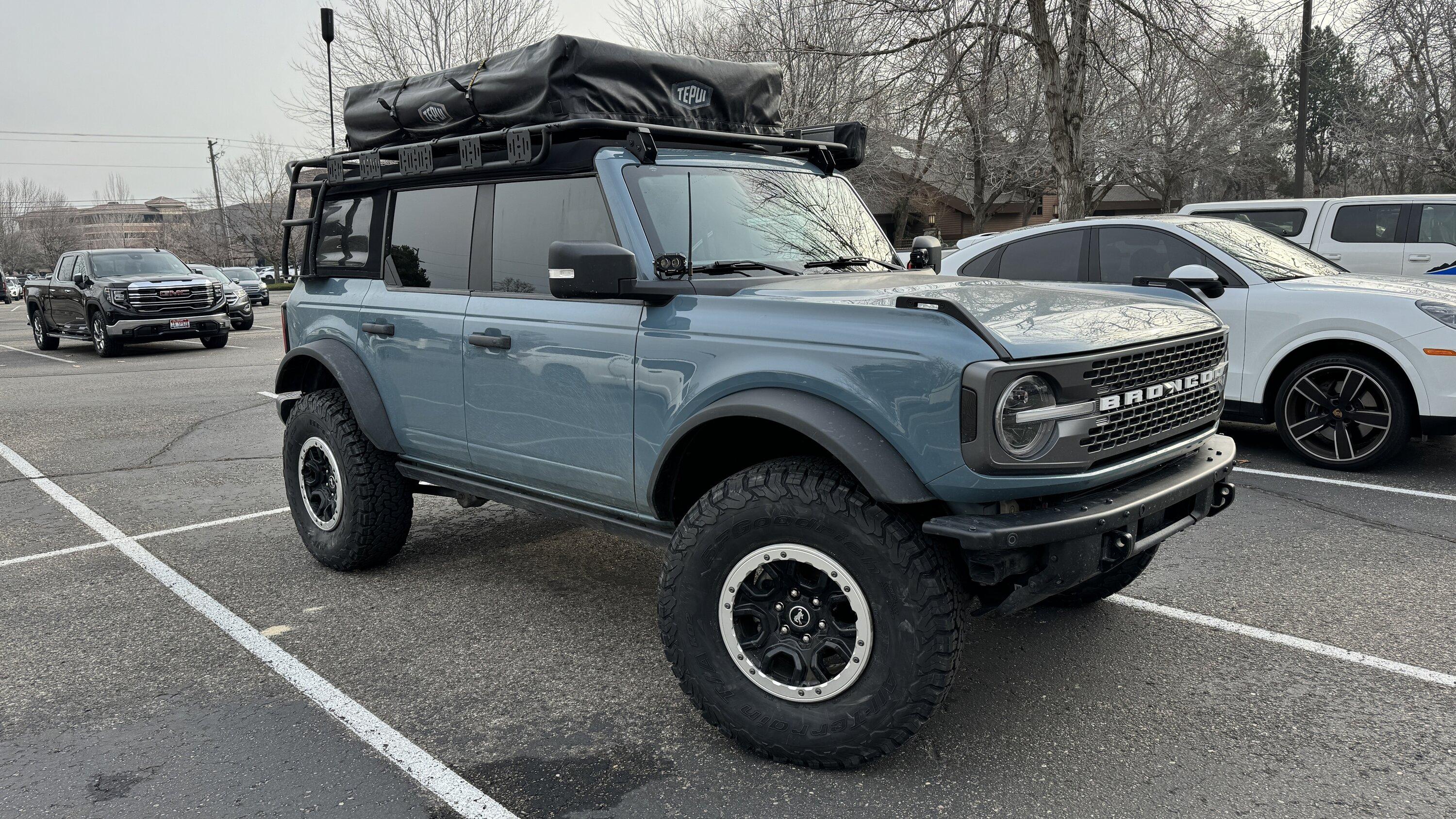

Went with 37x12.5x17 KO2s!!!! Zero rub at full articulation!!!! I am still going to trim off front and rear crash bars. Zero issues with UCA on stock SAS wheels. Thanks guys you gave me the confidence!!!! 2” OME kit and 3/5” body lift. I will get some articulation pics soon. Too dark tonight when I got to my flexing trail.

Discount Tire!!! Thanks guys!
I found a rub point. It is making contact with the large stay bar nut on the passenger side at full lock to the passenger side. I may need spacer or different off set to correct.
