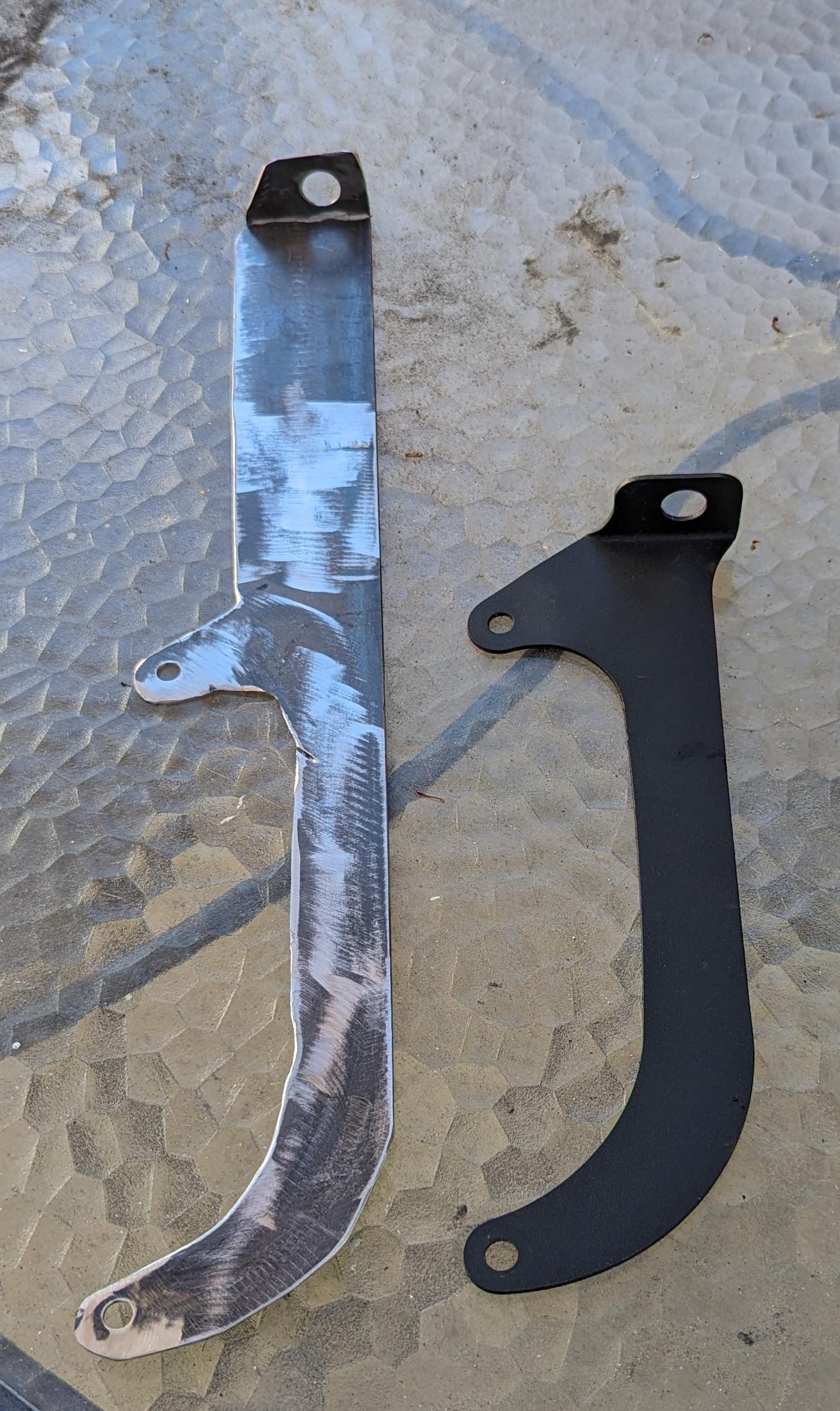

Also, I built a mount for an antenna on the back gate. Kind of wobbly, so I may modify but there does not seem to be a solution for gate mounted antenna for a Sasquatch equipped Bronco, unless you have some other gate mounted farkle (reinforcement, tire mounted rack, etc).
I'm making myself an antenna mount for the swing gate as well. Any chance you can show me your idea? I'm planning on using the brake light to mount mine to. I know I'll have to run a separate ground from the chassis to the bracket since the brake light is plastic.

Not the prettiest thing I have ever made, but given i was free-handing it with an angle grinder, I think it came out okay...
Ford Bronco Nice Slick GMRS Radio Install Antenna Mount

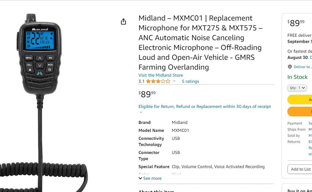

Can you use the same mic from the 275 on the 575?
Here is a replacement mic that also works on both. Much better menus and noise cancelling.
