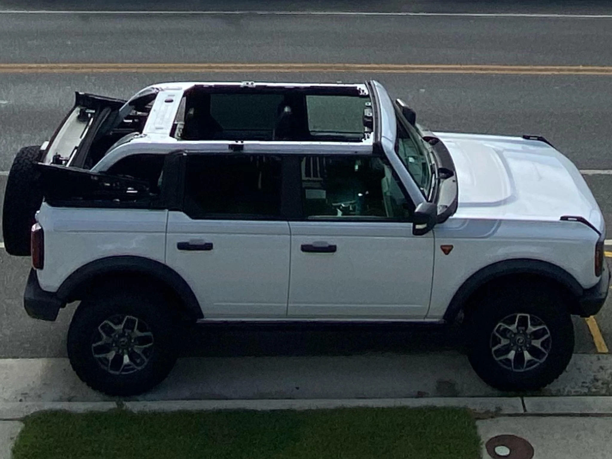

Dang that looks awesome! Yet classy too! I am digging in - pm me on what size tires you have too - that just looks amazing the silver
🙏 this is a stock Badlands, so 33’s. dig In and have fun with it!
edit: and apologies it just occurred to me that you were asking about the badge not a stripe 🤣

All good and yes the badlands wheels/tires is what I really like! And the stripes - I’m looking at that too so you read my mind.

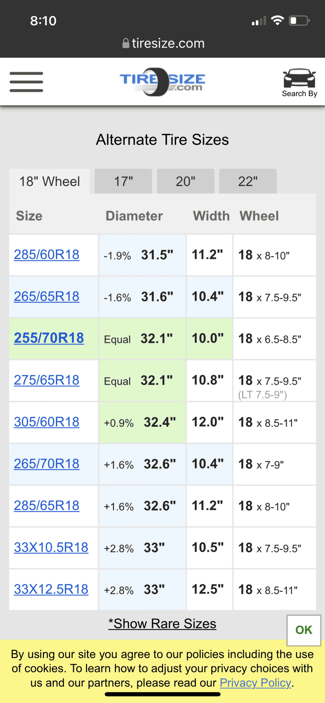

I’m going with 275/65R18 Open Country’s on my OBX. Matches stock tire height to skip the speedo recal but adds some width and a much more capable tire.
The biggest tire you can drop on stock wheels seems to be 275/70R18. Plenty of people here have done that swap already if you search for the photos.

You are right! Just added the screen shot. Thanks again!

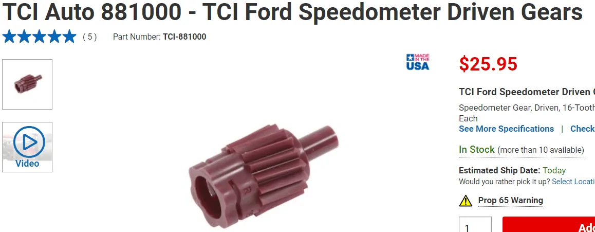

Interesting point Rick. I remember changing speedo gears out in the past in more simpler times and wasn't aware that the modern vehicles could be recalibrated by a different driven gear.
No gear, it's done through forscan.

That's a great looking OBX, Mikey. and yes... I didn't think a driven gear swap would work on a 22 Ford.
