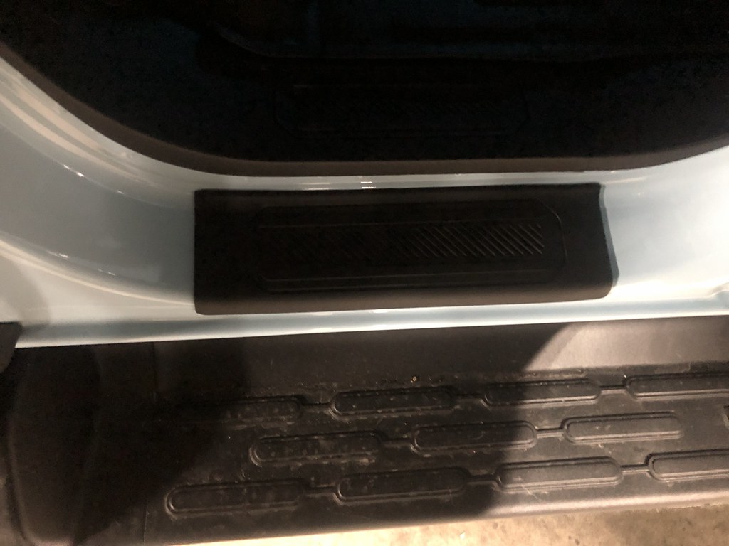

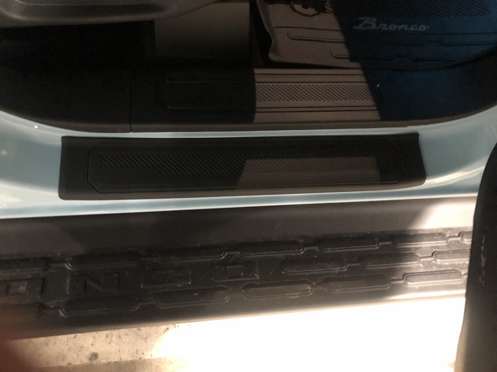

Cross post from the ‘what did u do today?’ thread:
Added scuff guards before the sills get scuffed - especially from my pitt/collie mix Riley's claws when he jumps in and out! $30 from Amazon

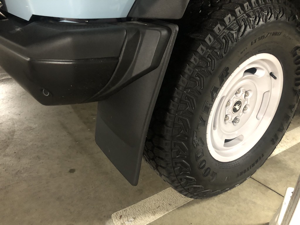

Attached rear mud guards from Weathertech. The fit is good and they look nice on but:
1. The 'dril-less' claim is weak as you need to screw through the plastic bumper inner.
2. Really a two person job as you need to reach inside the plastic bumper shell while tightening the screws from the outside. I managed, but really awkward and frustrating.
3. The mudguard material seems very stiff, so I would not be surprised if it cracks if heavily scrapped while off roading. We'll see.
The front ones will be installed in the near future.

The Goodyears when new throw gravel like nobody's business. You've got the running boards for protection, which is good, otherwise the fronts would be the priority mud flap.

Fronts hopefully go on tomorrow.

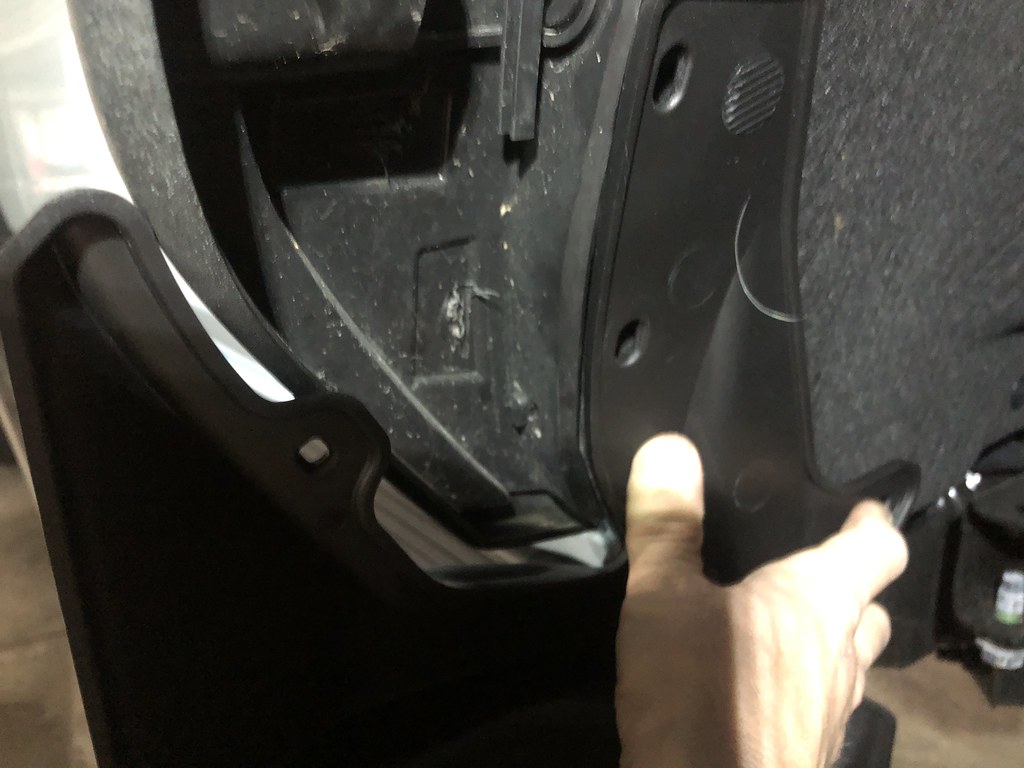

The front weathertecs are poop. Weird fit where thre is an outer bolt hole to nowhere but this will vibrate where it hits the stock piece. Also drilless is bogus, because there is a spot where you have to drill through the liner.
will send these back.

The Mabetts or IAG work fine in the front even with our rectangular fenders. I did need to buy longer speed nuts to get everything to line up.
