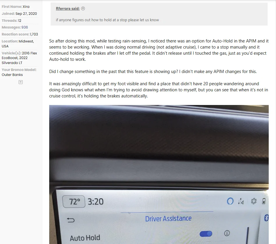

Yes, sorry for the imprecision. You were in that thread if I recall correctly and someone dug in and found something that looked like the Bronco could read speed limit signs. But, MattinNash seemed to get it going although no one seems to have been able to replicate his success.
Ford Bronco NEW Flashcal+ Bronco Support! 1784729377371-z

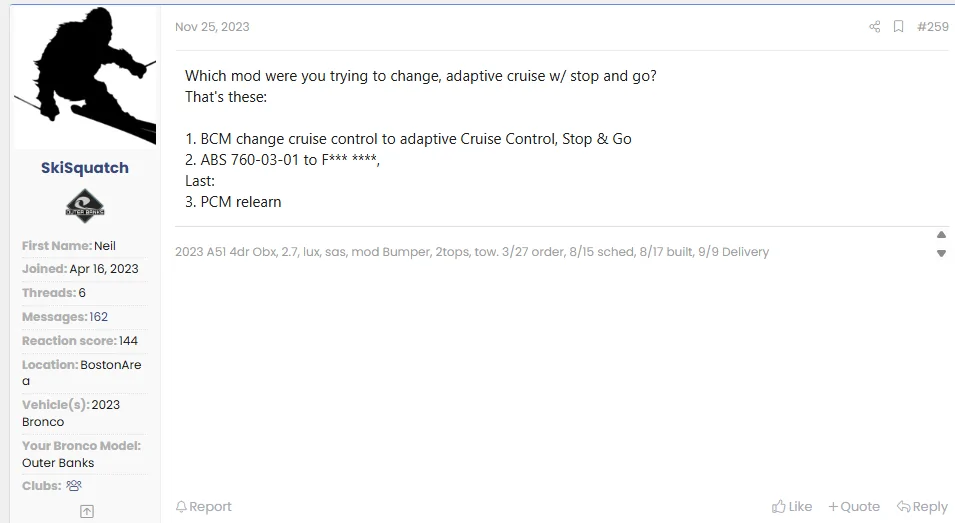

Here are the steps for Stop & Go:
Ford Bronco NEW Flashcal+ Bronco Support! 1784729957949-52

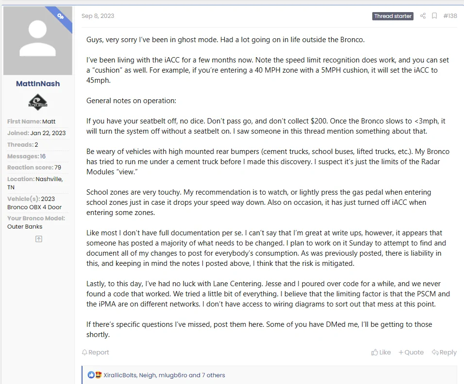

And more:
Ford Bronco NEW Flashcal+ Bronco Support! 1784732294022-c9

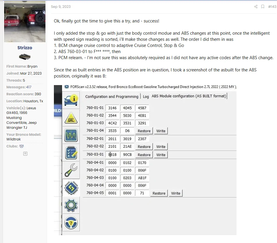

And here is the menu item for Auto-Hold enabled after APIM change:
Ford Bronco NEW Flashcal+ Bronco Support! 1784732352653-nl

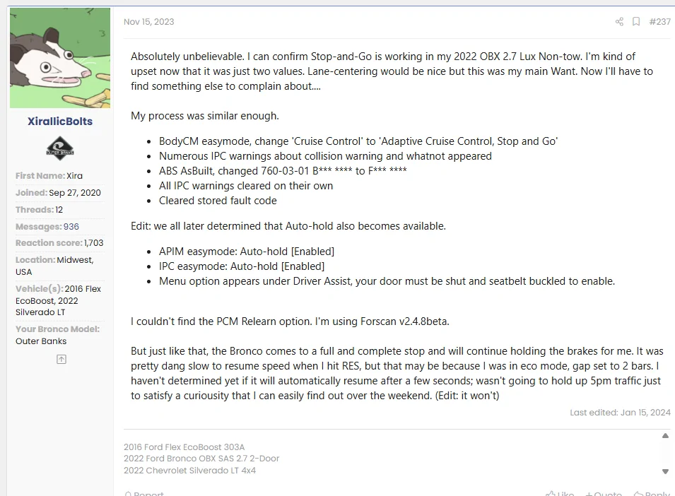

Apparently, the dash speed display showing the speed limit is a download from the nav database, and not the car actually reading the speed limit from the signs. Adaptive with stop and go is what I meant, but because the thread was titled "Intelligent" that became my go to word.
If any of these can be incorporated, it would be great.
Ford Bronco NEW Flashcal+ Bronco Support! 1784732475769-hd
