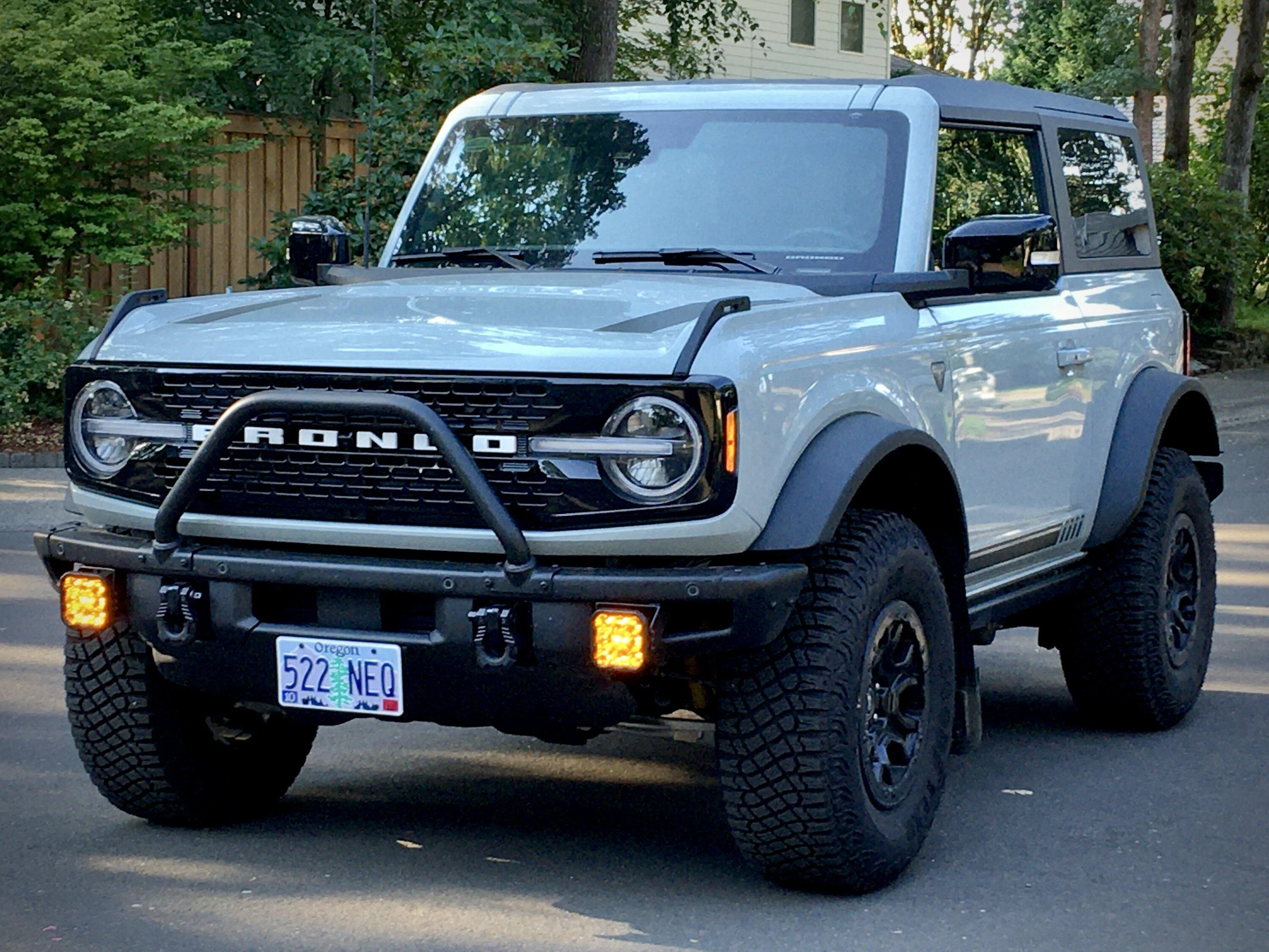

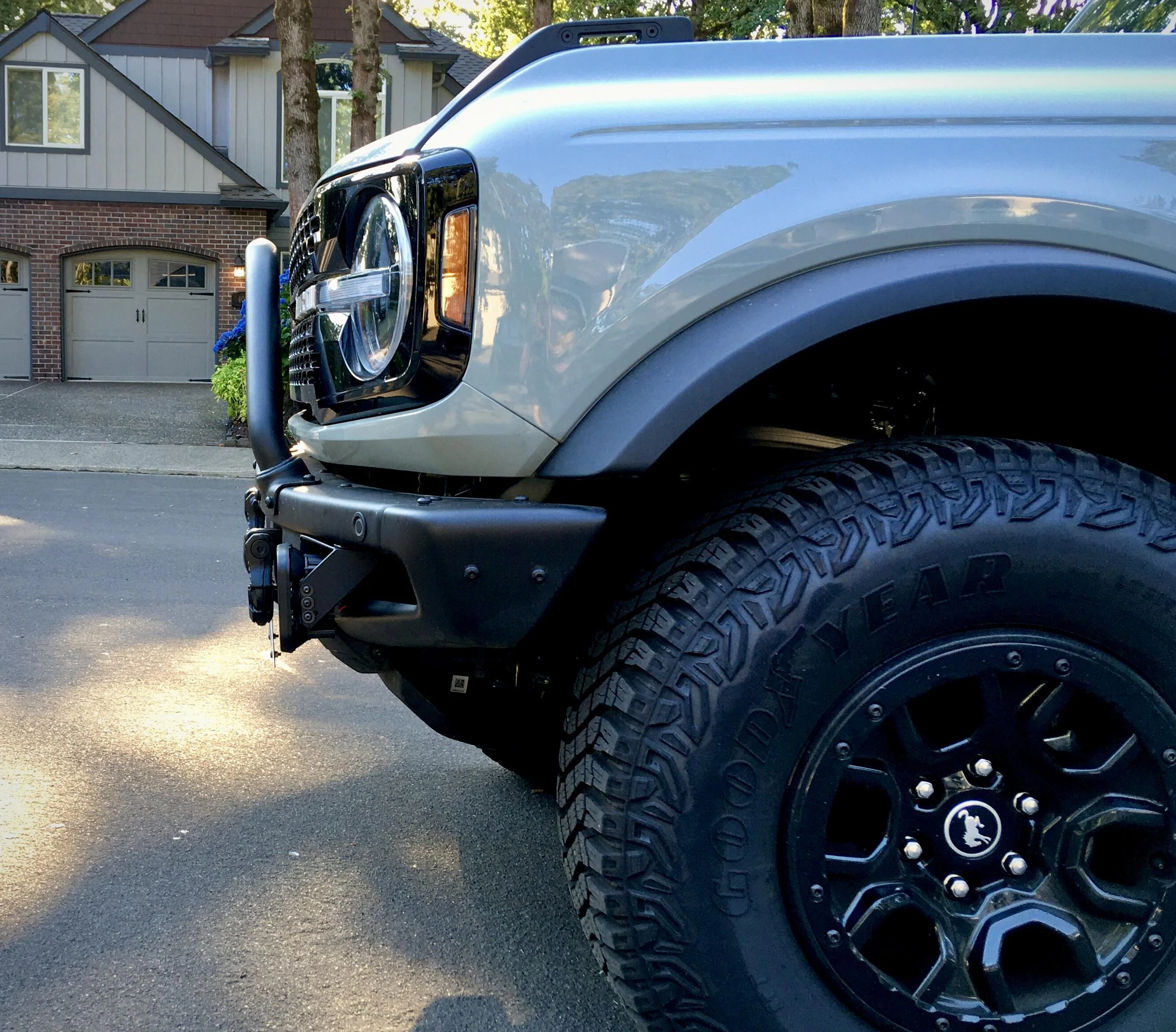

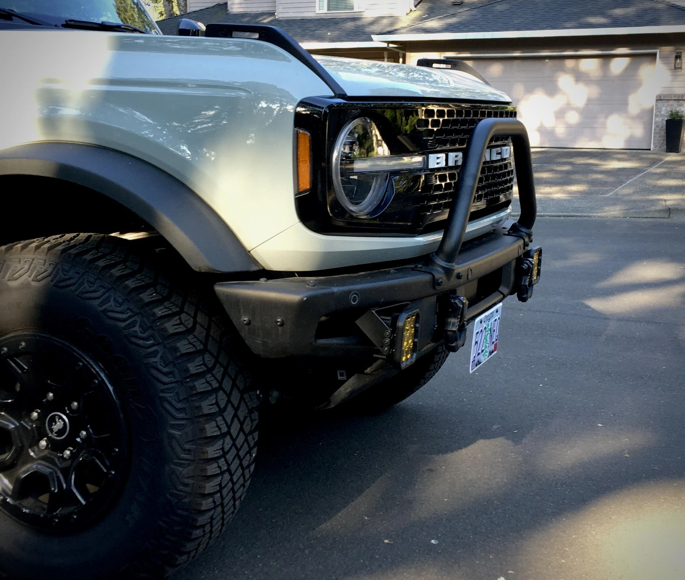

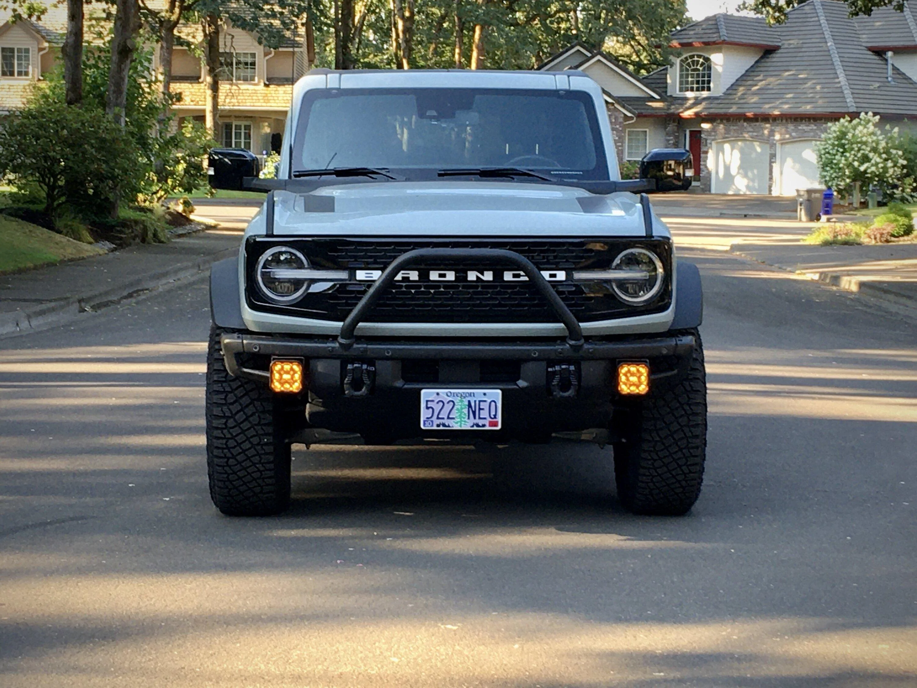

I made a custom bracket out of 3/16" thick and 2" wide steel. The challenge was to take in the account for the three different angles the bumper has to fit the predrilled bolts in the pocket holes. This was about 20 degrees from the front to the tire, 9 degrees angled back from the front to the axle and 3 degrees down from the inside to the outside. I did not take in account for the 3 degrees so I have a temp bar/washer to make up for it. I plan to make another set with all the adjustments, but not until I see how they hold up and work in thick fog.
