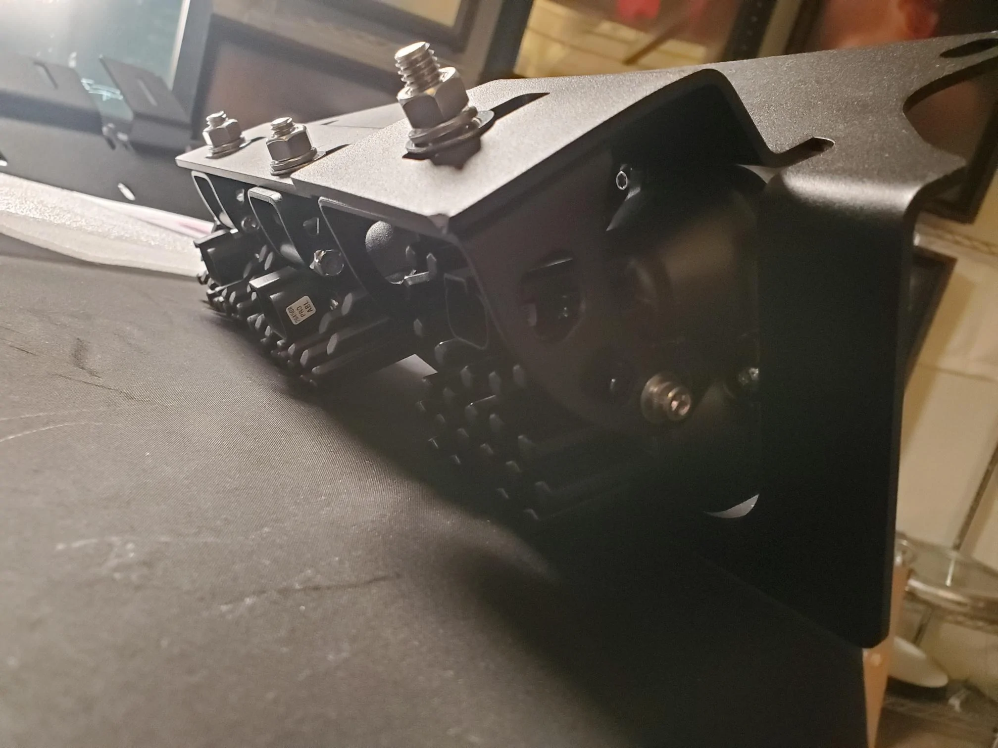

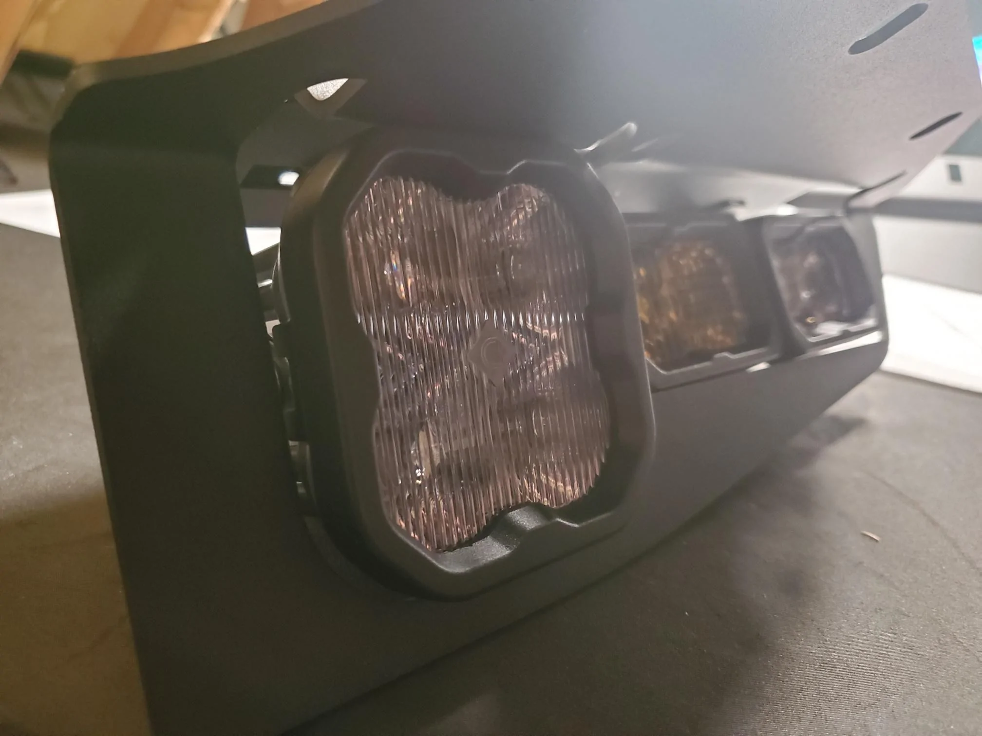

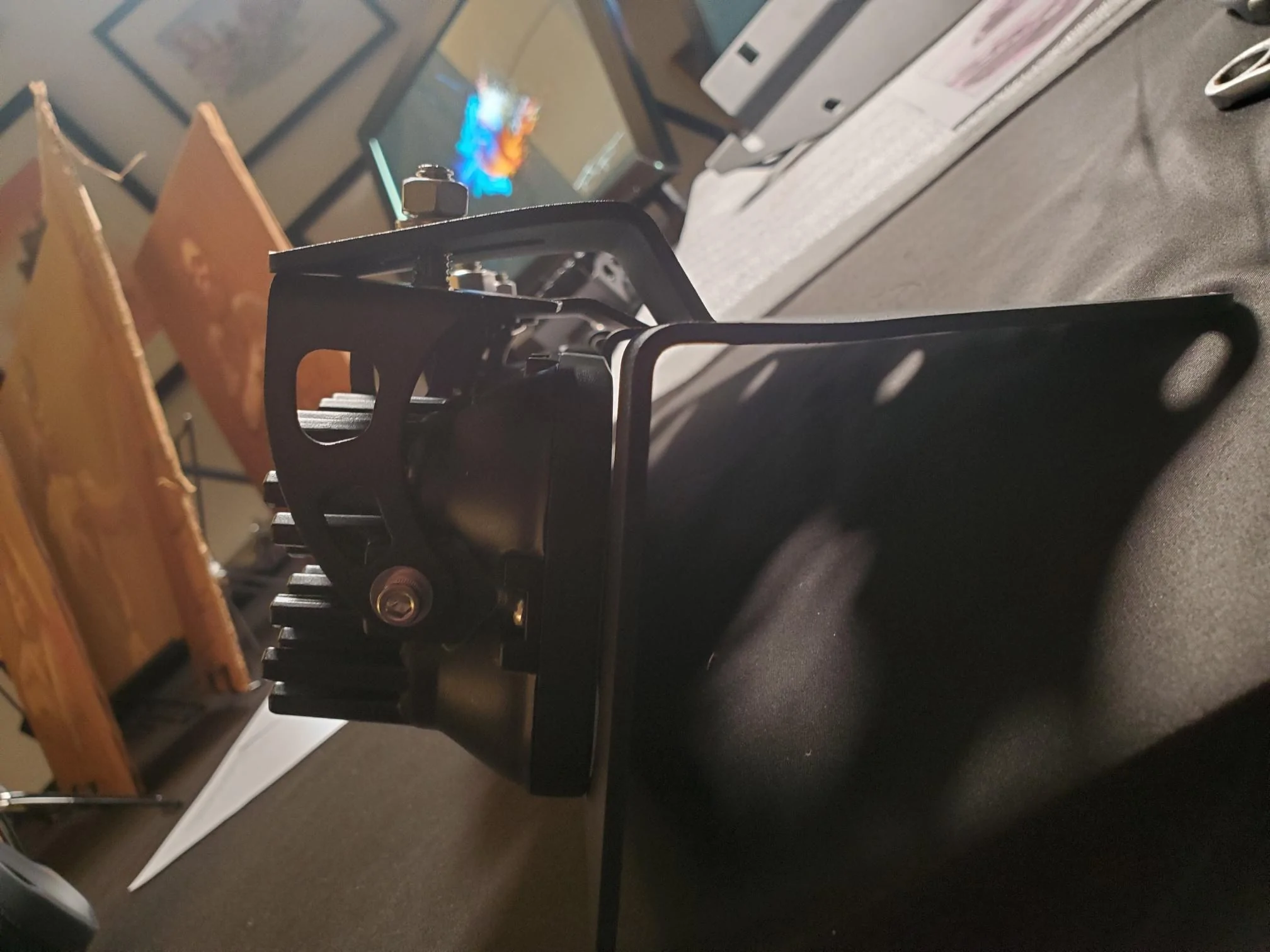

Just upgraded our own fog kit on our demo truck to some Diode Dynamics w/KR Off-Road Flush Bezels.

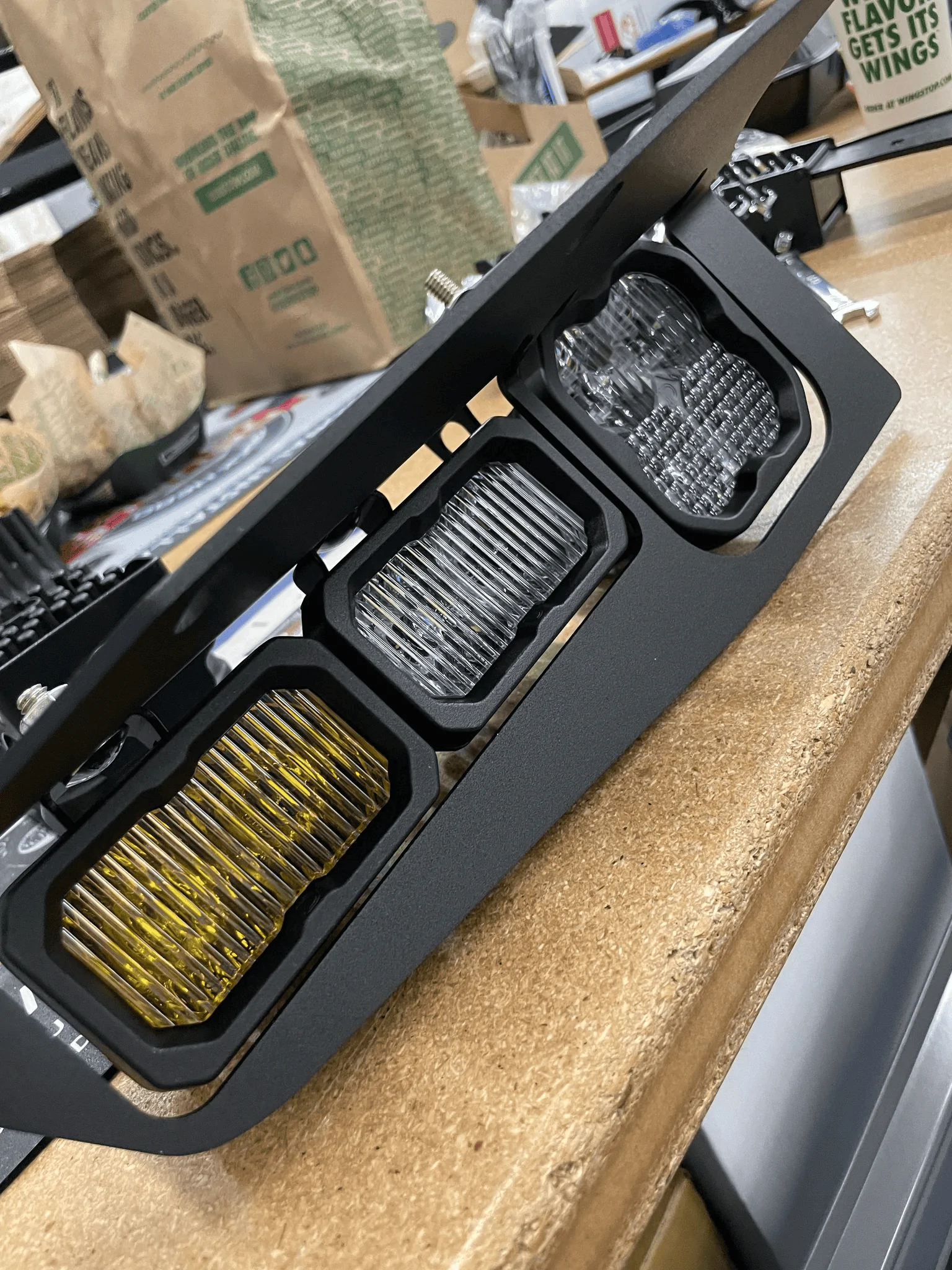

This is the combo I ordered. Is there a trick to getting those DD brackets to sit right into the Off-Road Flush Bezel? When attempting to mount flush, the SSC2's seem tight to the bottom of the bracket opening to the point that aiming them downward does not seem possible, unless I push them beyond flush. But the SS3 is impossible to get to sit anywhere near acceptable. the openings for the bolt are a limiting factor. but the real culprit is the height of the DD bracket.
here are 3 pics. The last shows how the SS3 sits when just behind - and flat to - the bracket. Almost acceptable... except the contact between brackets is sitting at 20 odd degrees. The only way to get the KR/DD bracket contact to sit tight is to jam the SS3 through and beyond the KR bracket opening into an awkward position that is entirely not aim-able. (the 2nd and 1st pic.)
PS: the 2nd pic shows how tight the bottom of the SSC2s are sitting when flush.
Nothing like what I see your pics. What am I missing?

Lay the bracket on a desk overhanging so that the lights sit flush
you have sufficient room to aim the lights - if you need more room to angle them because of a 6” lift or what kit… then just have the lights sit further back in the bracket so that when you aim them way down low they don’t touch the bezel
but you don’t have the lights installed properly based on your photo is why your having an issue
I started with installing all flush as 4x4 truck LEDs mentioned. The SS3 was pointed down as required. The SSC2 we're rotated and aimed down. Not exactly "flush" when everything is aligned.
thanks for the follow up. I just walked back to the computer to add an update. after fussing for the better part of an hour, I wrote that post. after hitting send I worked for another 2 minutes and suddenly the SS3 popped into position. I don't know how. but I'm guessing that writing the post helped it along. ;)
now off to see if lightening can strike twice...

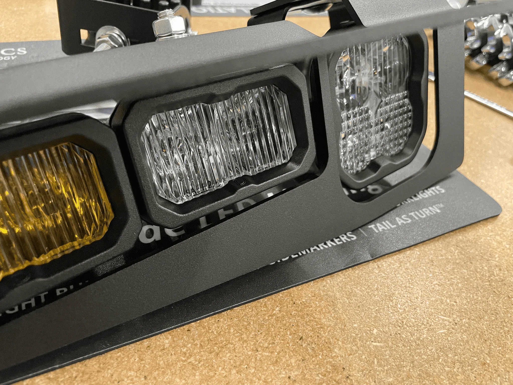

This is what the lights look like when they are aligned flush:
Ford Bronco Diode Dynamics fog lights 1671129378513
And this is what the lights look like when they are sitting further back, which lets you move them up/down without hitting the bracket
Ford Bronco Diode Dynamics fog lights 1671129403019
