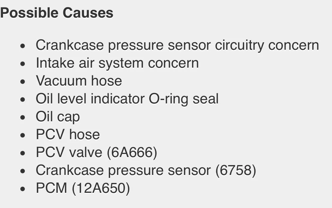

Not something I would be worried about, especially if the check engine light wasn’t currently on. Probably just a historical DTC.
Should be completely fine to drive.

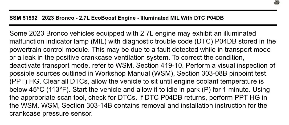

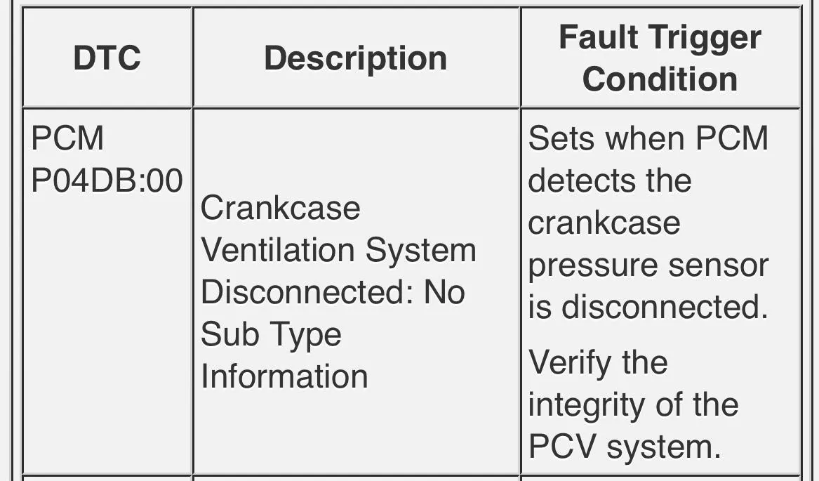

Yeah aftermarket intakes, catch cans, etc. can sometimes cause codes like this.
There’s also an SSM for this code for some 2023’s with a 2.7, not sure on your year or engine though.
I do have a 2023 Outer Banks with the 2.7.
Well from this SSM it sounds like it was just a fault only while in transport mode most likely. Probably just a programming issue. Which is also probably why it’s a historical DTC and not a current fault with the check engine light on. So as long as the light doesn’t return, you probably have nothing to worry about.
