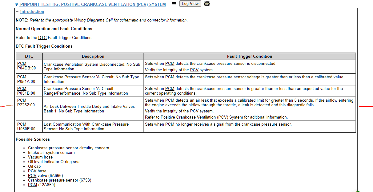

I have a new 2023 Bronco with only 4200 miles on it. I installed a KN cold air intake when I had around 600 miles on the vehicle. Around the 2800 mile mark I got the P2282 check engine code. I have taken it to Ford but they wont do anything other than charge me for the Diagnosis and tell me it is my PCV hose. I have contacted KN and have had new valves and hose sent to me. I have replaced that, and I still get the code. I asked if they (ford) checked all aspects of the code IE the throttle body etc. they said their computer shows a leak at PCV.
So, I took it back in and the same result. I talked with KN again and they sent me some other parts to swap out which I did and still no change. I have asked a local shop if they would do a smoke test to see if there is leak and they wont touch it b/c they didnt install the intake.... I was then told to maybe disconnect the battery for 2 hours and see if that helps. I cleared the code and did that... light came back on. I was thinking maybe I need to tune it so the engine doesnt think it's drawing in more air than it's supposed to but I have been told they cant do that kind of a tune bc the PCM is locked or something and a performance tune like the one Ford offers, wouldnt do what I need it to in order to clear the code...
Where do I go from here? Is this bad on my engine? I have noticed my gas mileage is suffering tremendously from this. I have a 2.3L and the bronco reads 250 miles to E on a full tank.... That number drops every time I fill it up... Started at over 300 then went to 280 then 260 and now 250...

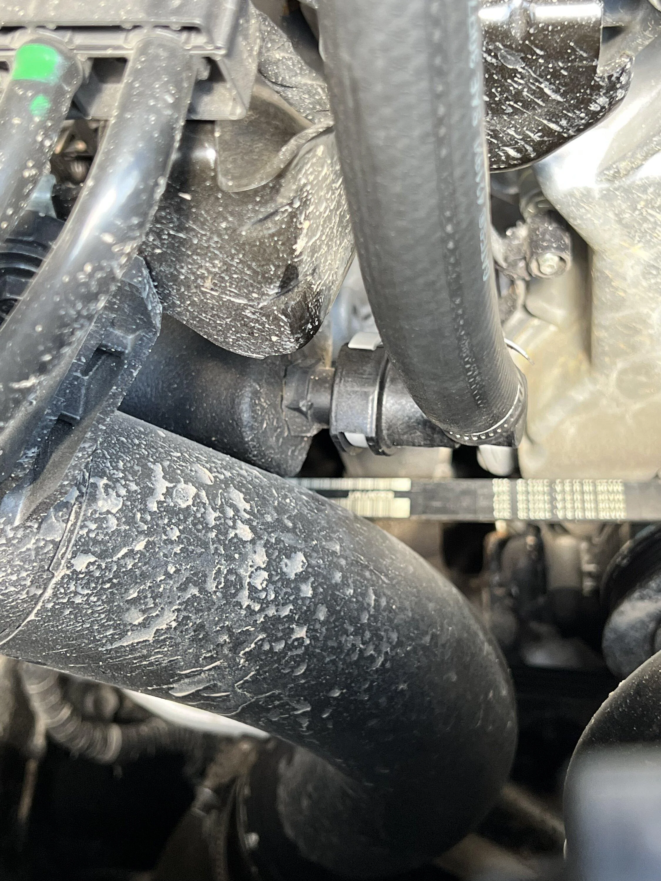

I had a similar issue with mine after i installed the same intake. If you zoom in to the picture, there is a little piece circled. One the bend there is a little cap that is glued on. (See red line inside red circle) Blow up the picture. They little cap blew off causing a similar issue. K+N sent me a new part for free.
Also the Magnuson–Moss Warranty Act prevent a company from denying warranty based on aftermarket parts. I hope this helps.
Yeah i had them replace that part as thet blew off before the next check engine light came up.
Damn that sucks then. The first time I had it was before the cold air intake and it was diagnosed as a selinoid near the gas tank.
