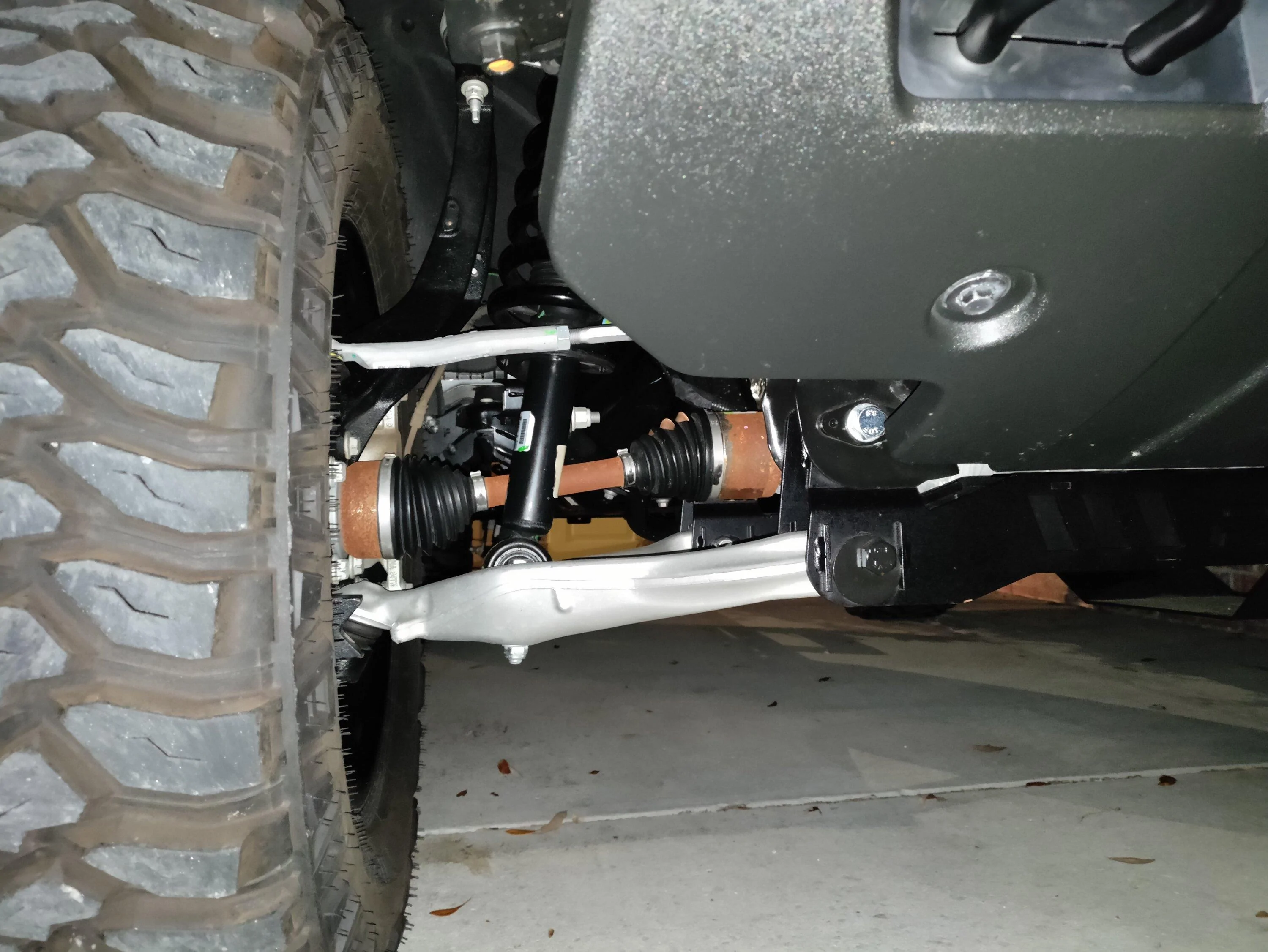

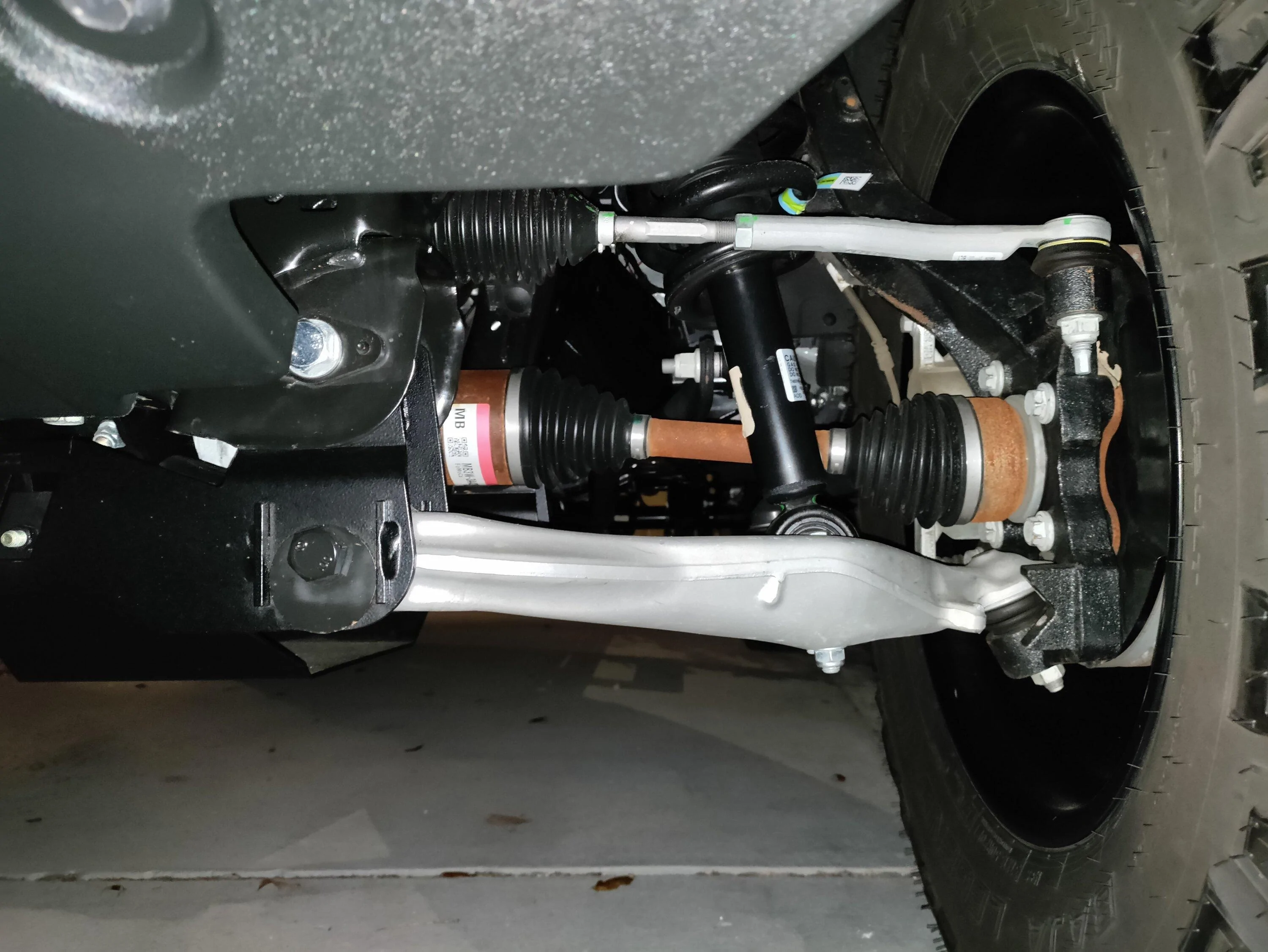

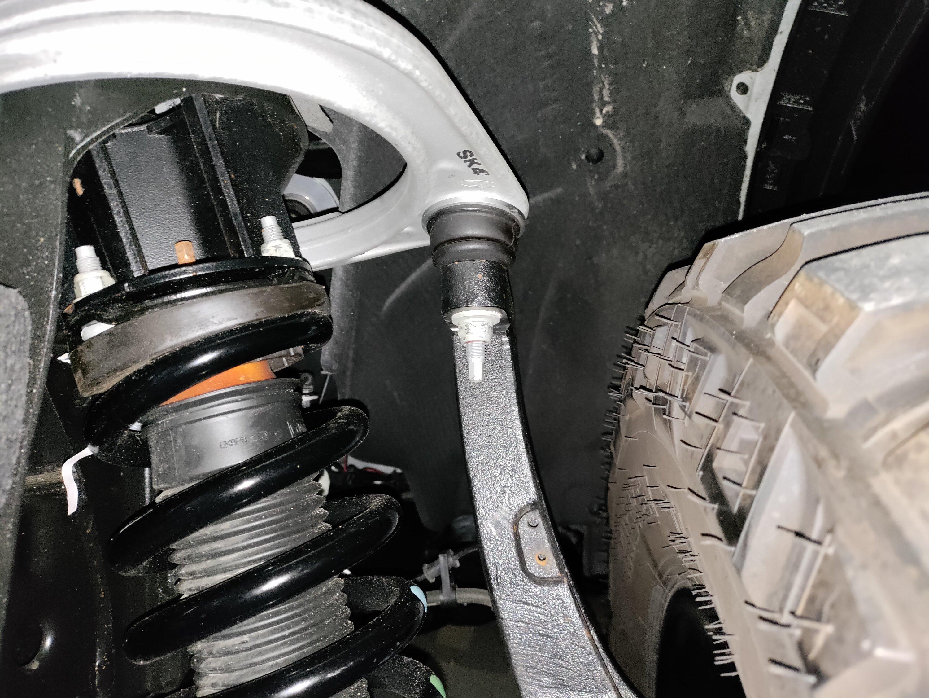

Gavin, I'm not bragging or anything, just proving my point. And hopefully help you in your future endeavor. Look at my front-end suspension components, axle shaft angle, tie rod angle, LCA angle and UCA/balljoint angles. Everything is in oem spec geometry. The balljoint are neutral center postion, nothing is binding. That's because I bought a complete 5" lift kit. Lowered front and rear cross members, lowered diff brackets, larger knuckles to raise the axle shaft hubs. All this gets my geometry perfect. The only thing I'm going to buy outside of this is proper coilovers. When I took delivery and bought my lift kit, there wasn't much out there for coilovers. Now there is, so that is my next task. But the most pleasurable part of all this is I have no concerns of something going to break because of stress. Sure my Bronco has its limitations, but I never exceed that limitation.
Those angles do look factory spec. Impressive. Are you running 37s?
