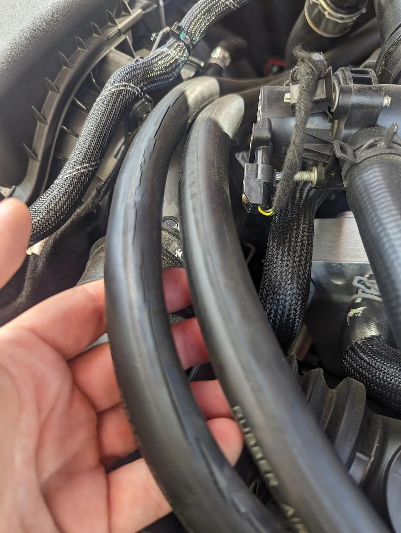

Six week follow up on this. The hoses that were included with the kit have started to crack, presumably due to heat in the engine bay.
Ford Bronco My DIY Oil Catch Can PXL_20230501_164946795
I'm going to reach out to American Muscle, because it doesn't look like C&L has their own website, just a lot of reseller touches. In any case, I'm going to discontinue use of this in the short term until I can find an appropriate solution for the hoses. It looks like high temp, oil resistant hose is like $40/foot for 5/8" ID, so I might end up paying more for the hose than I did for the catch can.

Hey @jacknifetoaswan - loving the creative solution! My recommendation would be to make sure you are using a hose with either SAE J30R7 or J30R9 spec. Like you mentioned, you need a hose which can withstand under-hood heat, pressure/flow through the hose, and have a good permeability rating (so oil/fuel vapors do not seep through the hose). While we don't have a 5/8" size in our catalog, we do have 1/2" and 3/4". The 1/2" might slip over your fittings with a little lubrication.

Thanks John. I figured I'd try to save myself a few bucks and it just ends up being more of a pain than getting an all in one kit. I really appreciate you providing the specs to look for in hoses! I'll see if I can find 5/8" hose elsewhere, but if not, I'll come back and grab the 1/2" hose and new fittings for the can. Hopefully I won't also have to order new PCV quick connectors.
