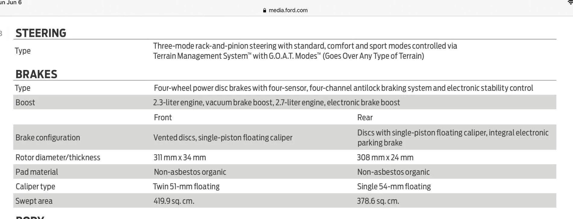

Well as far as I know the 2021 Ranger comes with a vacuum booster..they have the 2.3 engine.
depending on your Bronco engine..there will be 2 types of brake boosters.
2.3 engine - vacuum
2.7 engine - electronic
also appears Bronco has bigger caliper Swept area.
Ford Bronco Mushy brakes? 1512FF56-C177-468E-8BF6-32C09E4BEAA3
so if there are similarities will have to compare 2.3 engine Bronco to Ranger

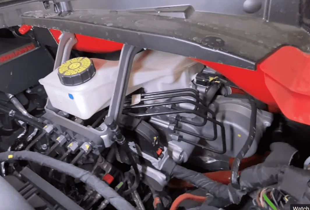

I have never had issues with my Raptor brakes but I have owned 3 BMW M cars and the Germans know how to do brakes. BTW .. the traditional master cylinder is gone on the GEN3 Raptor. It is now all electronic.
Ford Bronco Mushy brakes? 1623079925804
Ford is notorious for having a mushy brake pedal. Every new Ford I have owned has had a mushy brake pedal. My current Raptor has a mushy pedal. No issues with the actual function but they just do not feel right. When I switch vehicles to my wife's Audi I have to be very careful with the brakes.
