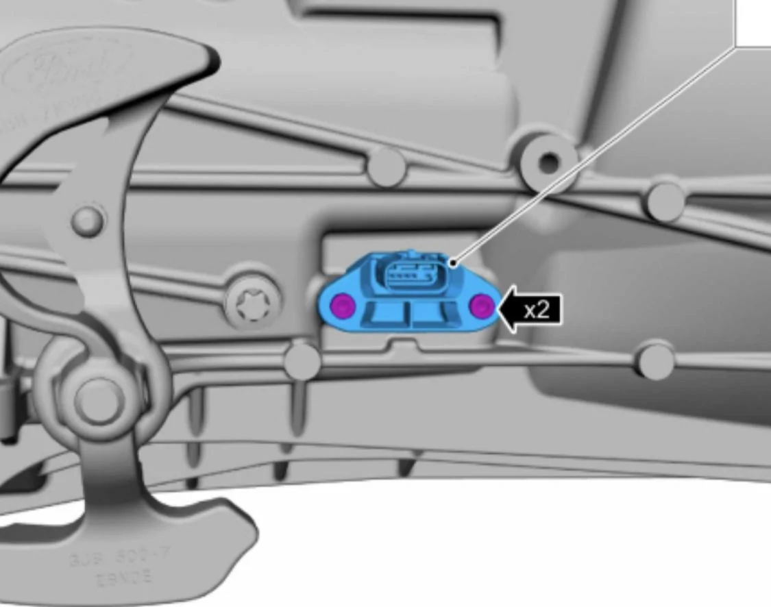

If you missed my post, there is a position sensor in the transmission on the right side.
Thank you. I DID miss your post... but still don't see it when I scroll up. Can you PM me the document where this came from? Assuming it's not some internal top secret doc.
