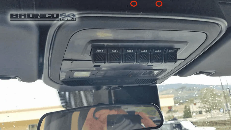

I'm hoping someone who has torn into the aux switch area can help me out here. I want to relocate my Yaesu 400 control panel up near the AUX switches using a 3D printed bracket a friend is willing to create for me. My though is to use a combination of 3M adhesive tape with adhesion promoter, and two self tapping screws into the plastic that aren't going to go very deep, just enough to bite with mostly the adhesive doing the work. I'm thinking the area behind the plastic I want to mount probably has nothing at all behind it, at least for about an inch or so since that space was more used when you don't have AUX switches.
Here is my prototype that I created just by taking a desktop mount and running it thru a slicer and adding some shape to it. This does work but I don't think the down angle will be good enough:
Ford Bronco Mounting Near AUX Switches IMG_2698
Here is where I want to mount it (credit to whoever's photo i stole):
Ford Bronco Mounting Near AUX Switches 1674754965683

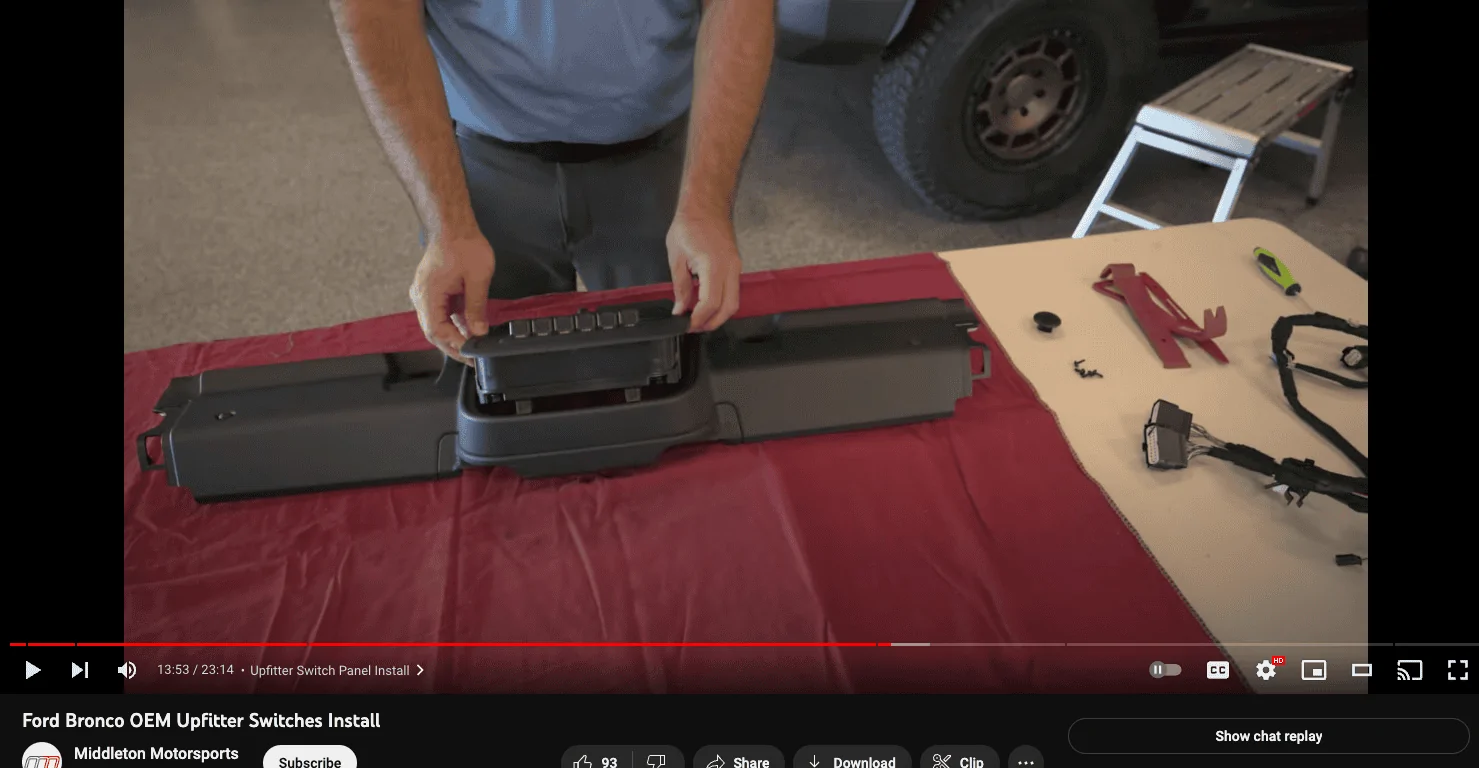

Perhaps I have my own answer, it looks like during this upgrade @Middleton Motorsports got a good shot of a significant gap between the outside of the trim piece and where the upfitter switch components are:
Ford Bronco Mounting Near AUX Switches 1674755896956

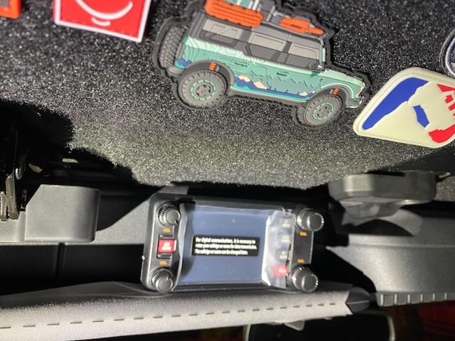

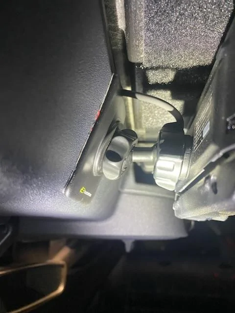

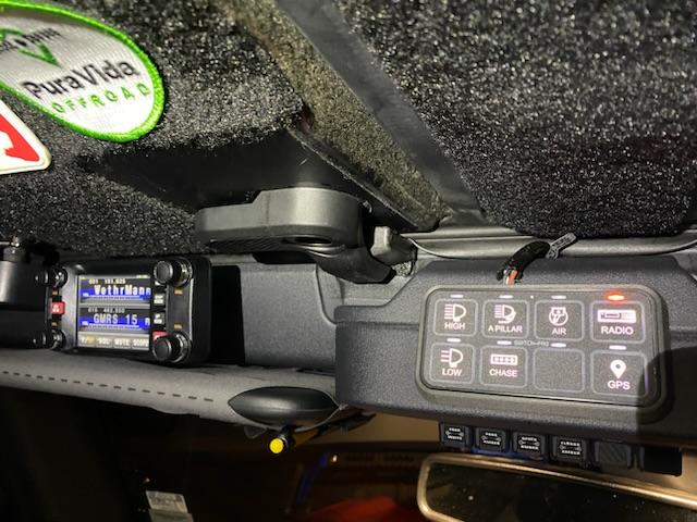

Sorry I’m so late to the party, but thanks to @0321_Bronco and @JediMcMuffin for the kind words on my install. I wanted the control head close but out of my line of sight so I mounted it above the driver’s side visor.
For anybody reading this that’s interested in buying and using the Yaesu 400 but doesn’t have soldering skills, check out the MARS mod from Gigaparts when you order the radio.
Here are a few pics of the mount.
Ford Bronco Mounting Near AUX Switches 94FF9E1B-5CDC-44EB-A53E-7F844C0AB0B2
Ford Bronco Mounting Near AUX Switches F0C6964D-F45A-4C18-8BED-45C0A7933D58
Ford Bronco Mounting Near AUX Switches 3EB2D21F-F39B-4447-9D6C-31FEAA867ACC
