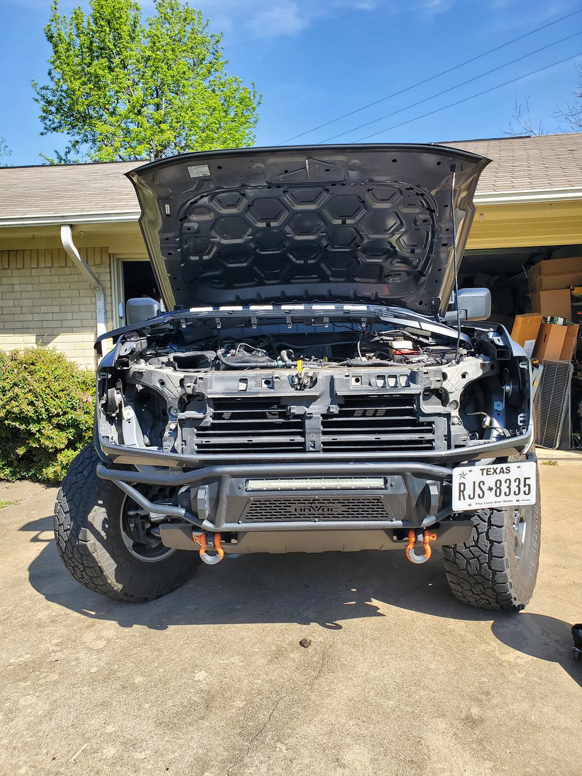

Noticed on Monday that one of my headlights had an issue. So I contacted Morimoto. They immediately processed my warranty claim and shipped the next day. They arrived the very next day and I replaced them this morning and shipped the old ones back. It only took me an hour to swap out the headlights this time. The first time I did it, it took like 3 hours. Lol, learned from my mistakes.
If you have to swap out headlights, I recommend not taking off the bottom painted trim panel like the instructions say and just remove the trail sights instead. SO MUCH EASIER!

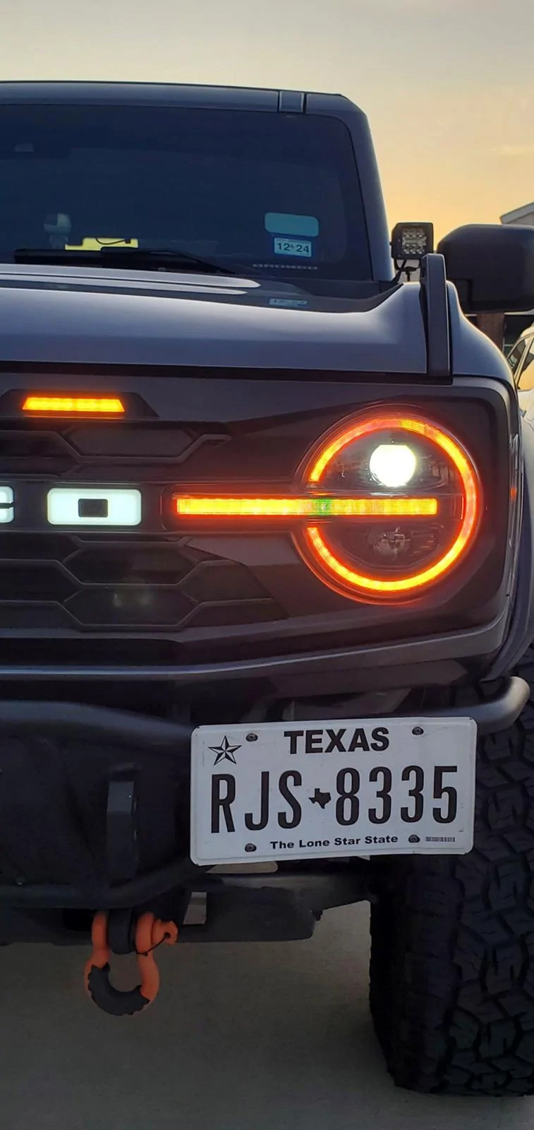

Ford Bronco Morimoto headlight warranty replacement experience. Screenshot_20240319-074235_Gallery

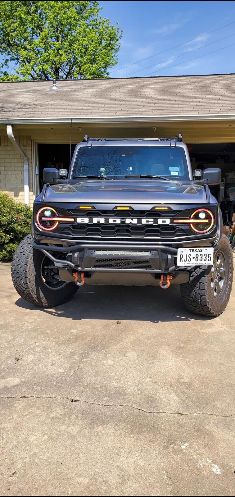

Ford Bronco Morimoto headlight warranty replacement experience. 20240323_110237
Ford Bronco Morimoto headlight warranty replacement experience. Screenshot_20240323-122545_Gallery

The first pic shows it. A green spot showed up on the driver's side DRL. Seems to be a common issue. I run mine on the a i installed thember color since that one is legal. Showed up 10 months after initial install.
