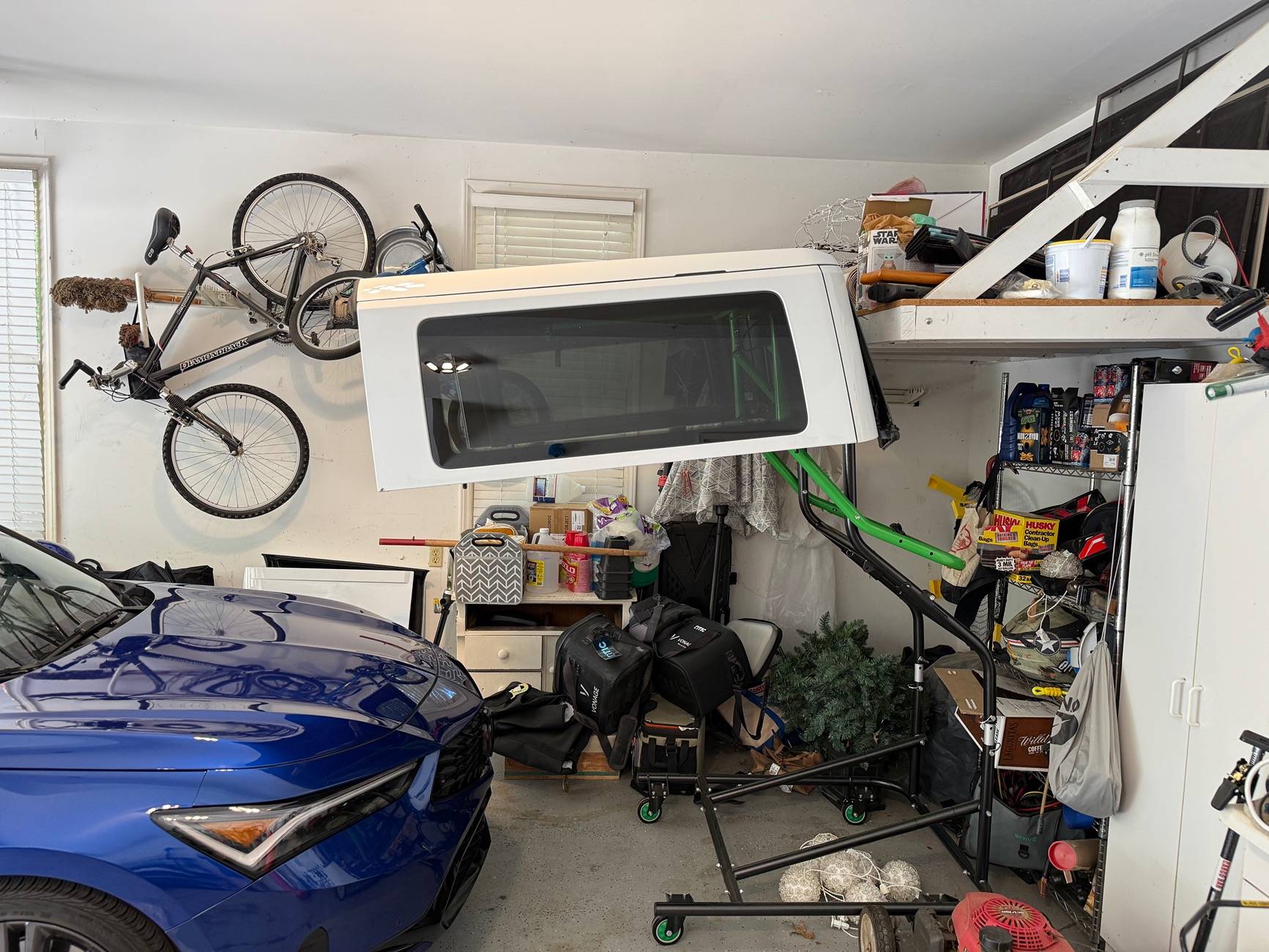

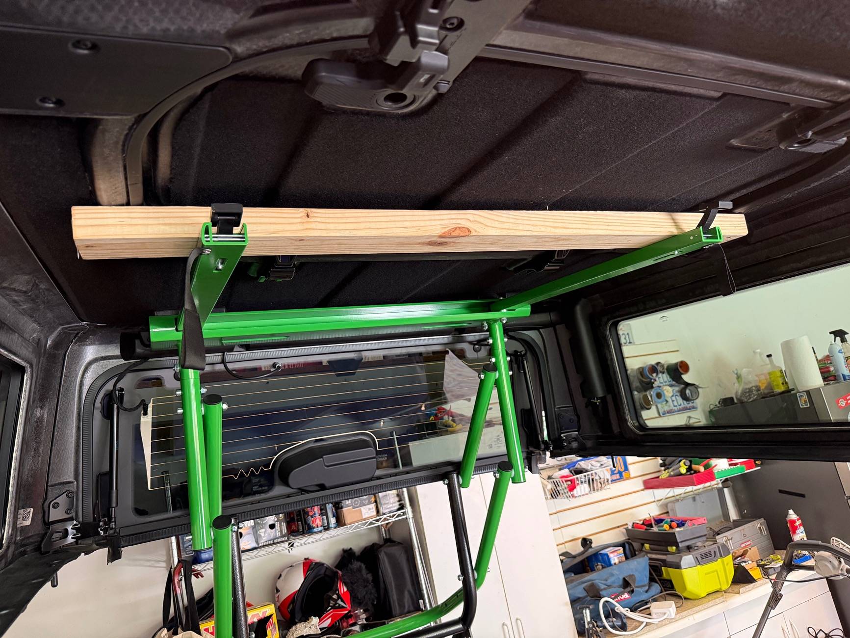

mine sags a bit as well, freaked me out at first... I agree the weight is in the back and I saw someone else on here recommend putting a piece of plywood across so the weight on the arms is on the edge of gunners hatch. Just goto Home Depot and have them cut you a 42 inch piece of 2x4. I flip up the ends just to make sure something would catch wood if it were to slide out (it won’t). FWIW. I added the ssx pods and they almost get in the way of the back of the lift I’ve leaned to pop it up 4-5 inches and then jump in the back and do the arms and so far haven’t scratched the roll bar.

That looks like mine too. What are the ssx pods? I think the metal plate for the screws on top of the rollbar scratched it. My jack gets to a point the higher I go the.ore severe the angle/sag
