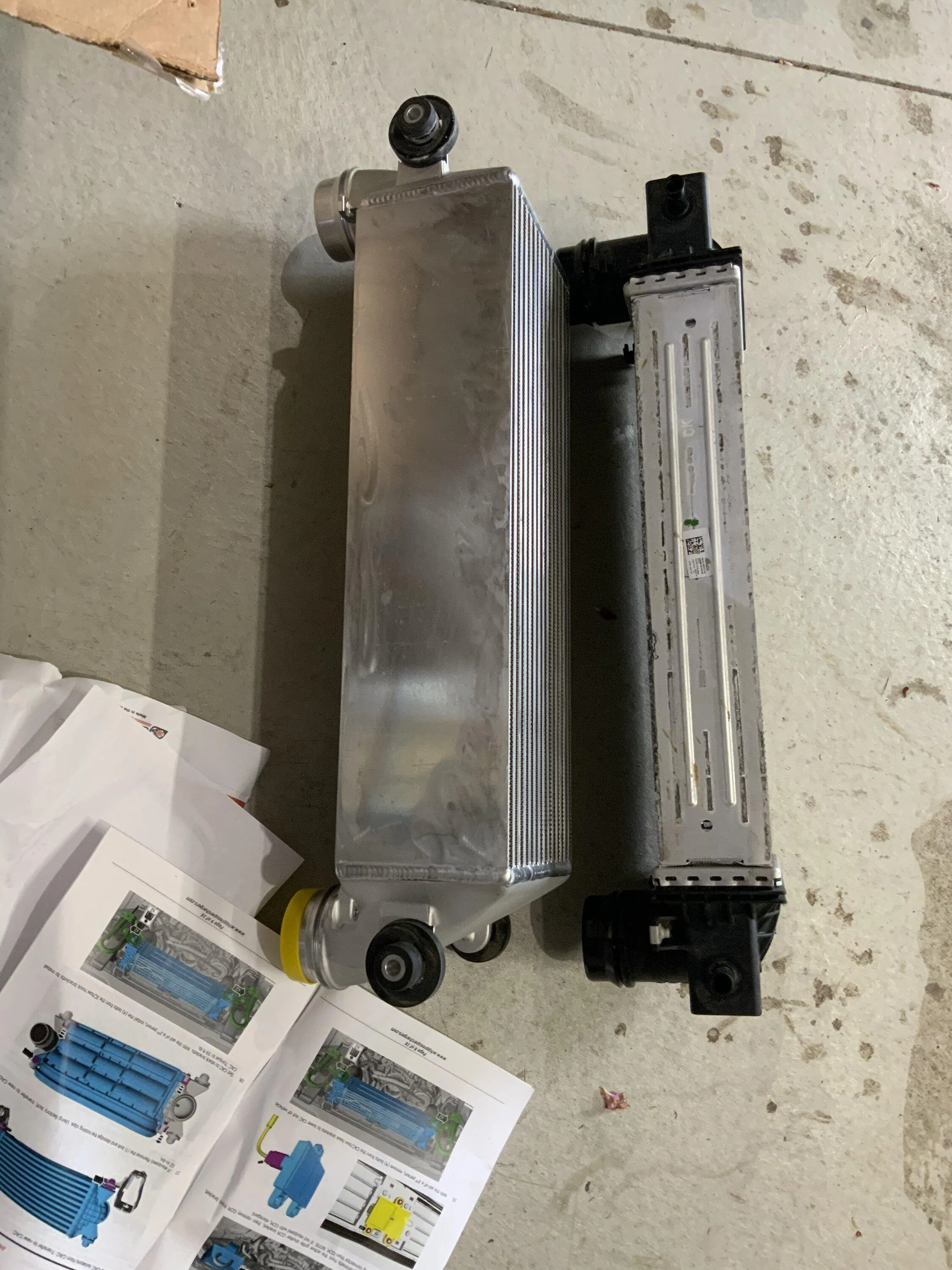

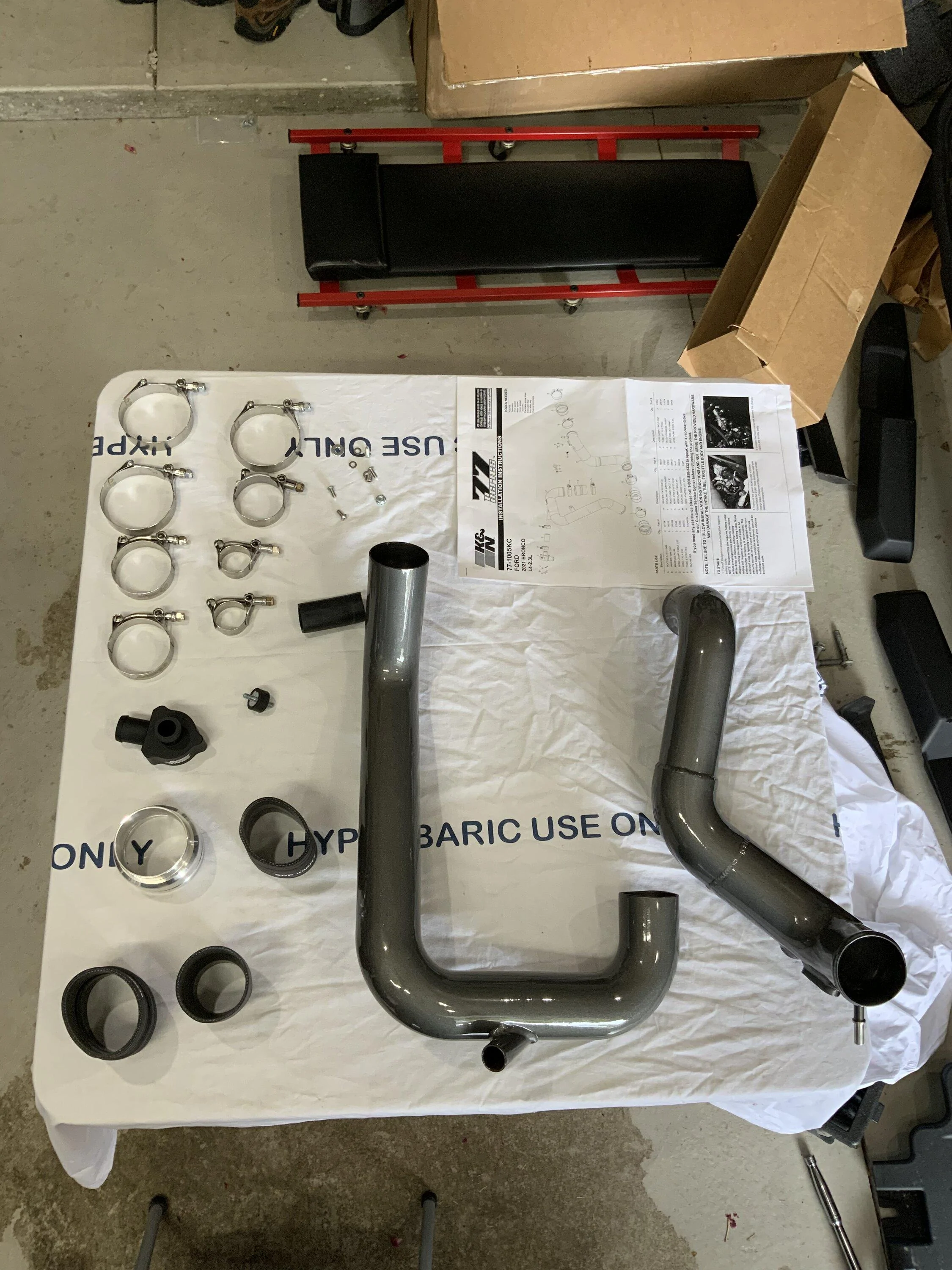

K & N intake, just got a Whipple Intercooler, waiting on charge pipes from K&N

@Dmorty217
waiting on pipes to arrive, they’re scheduled for delivery on Saturday.
if all goes to plan, Intercooler and charge pipes will go in on Sunday.

@JoeSpeed
Whipple IC:
very solid, easy install. Kit eliminates the shutters over the IC,
K&N Charge Pipes;
Do not recommend. The coupler for the cold side piping does not fit on aftermarket Intercooler, more than half of the clamps are the wrong size and don’t match part numbers on the paperwork, pipes are not flanged leading to pop offs, one pipe deformed with flat spot.
