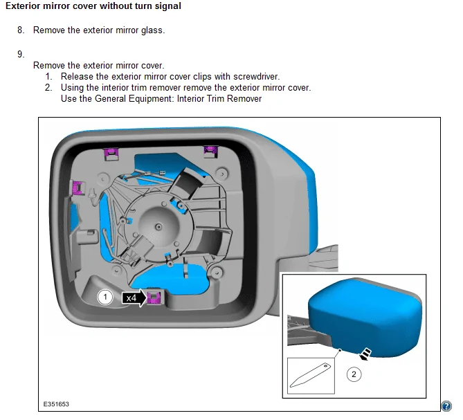

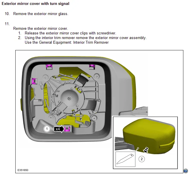

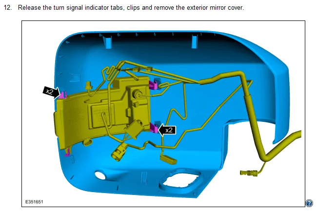

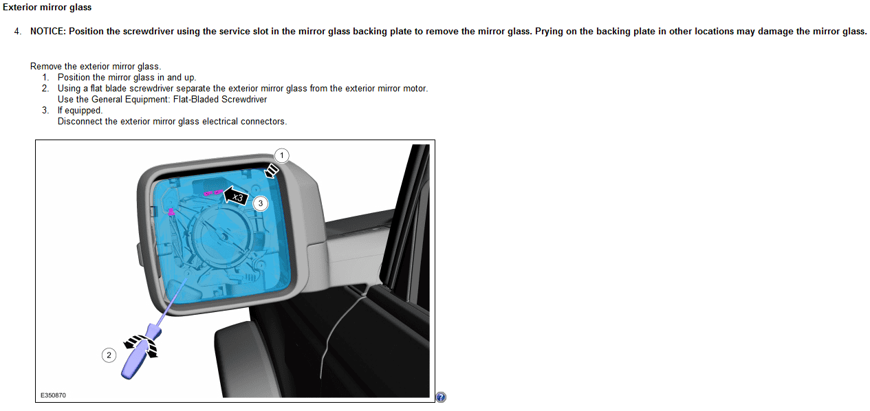

Anyone find a good video to remove the mirror caps for painting?

Ford Bronco Mirror cap removal? 1647289076507
Ford Bronco Mirror cap removal? 1647289019110
Ford Bronco Mirror cap removal? 1647289041968
Ford Bronco Mirror cap removal? 1647289261141
