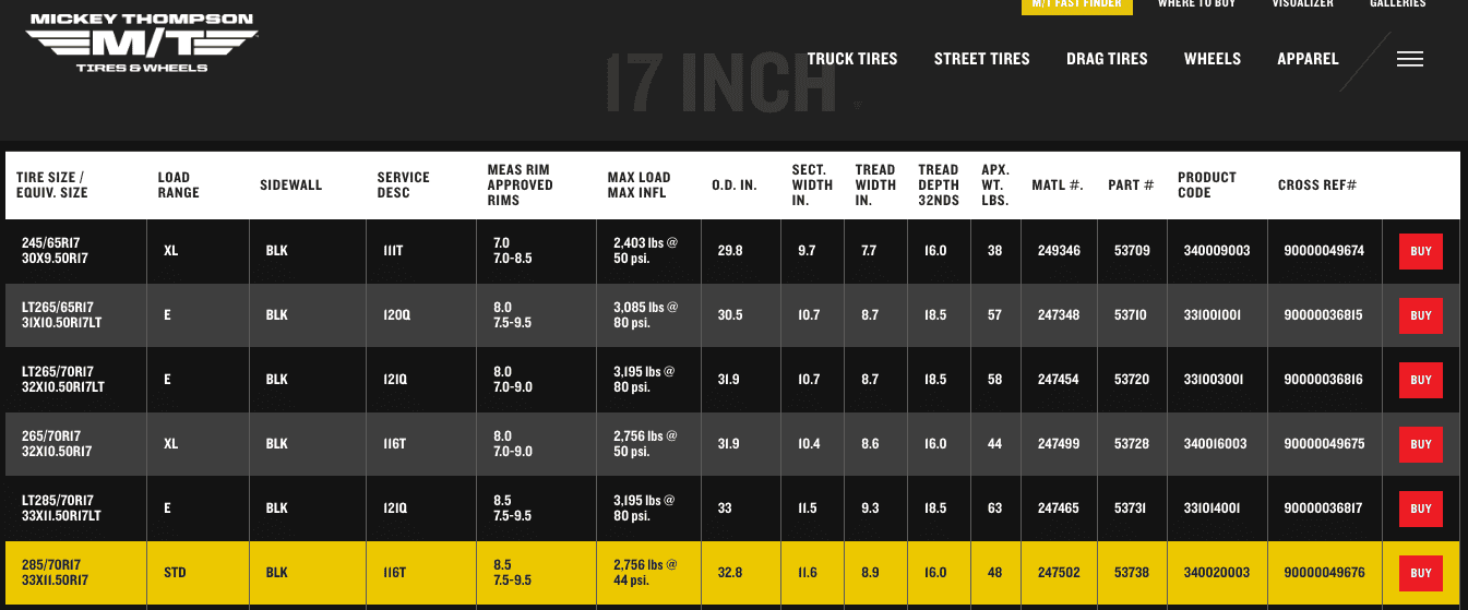

Can anyone help me out here, this Baja Boss Tire 285/70/17 has a STD rating. Use is Big Bend non-sas daily driver, with some beach driving. Want to replace Duellers with 33s that look a bit more substantial. I like that the STD weight is 48lbs, vs 63lbs for the LT version. Is there any downfalls to going with the STD rating?
1: Do Not go rock crawling with these tires as they are only 4 ply and probably have really thin sidewalls.
2: I don't think you want to tow anything with these tires either.
3: Those seem like the perfect tire for cruising the beach with.
Just remember to keep your tire pressures low. The Bronco was factory set to read 39 psi, and these tires Max out at 44 psi, so I would run them around 35 psi and make a FORScan adjustment if needed to get the TPMS light out (if it comes on).

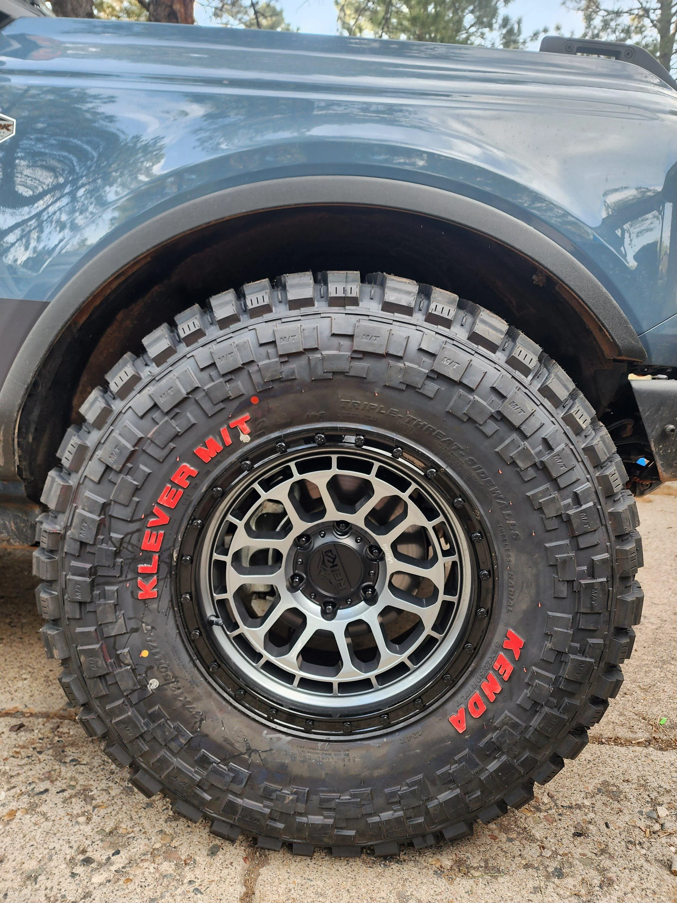

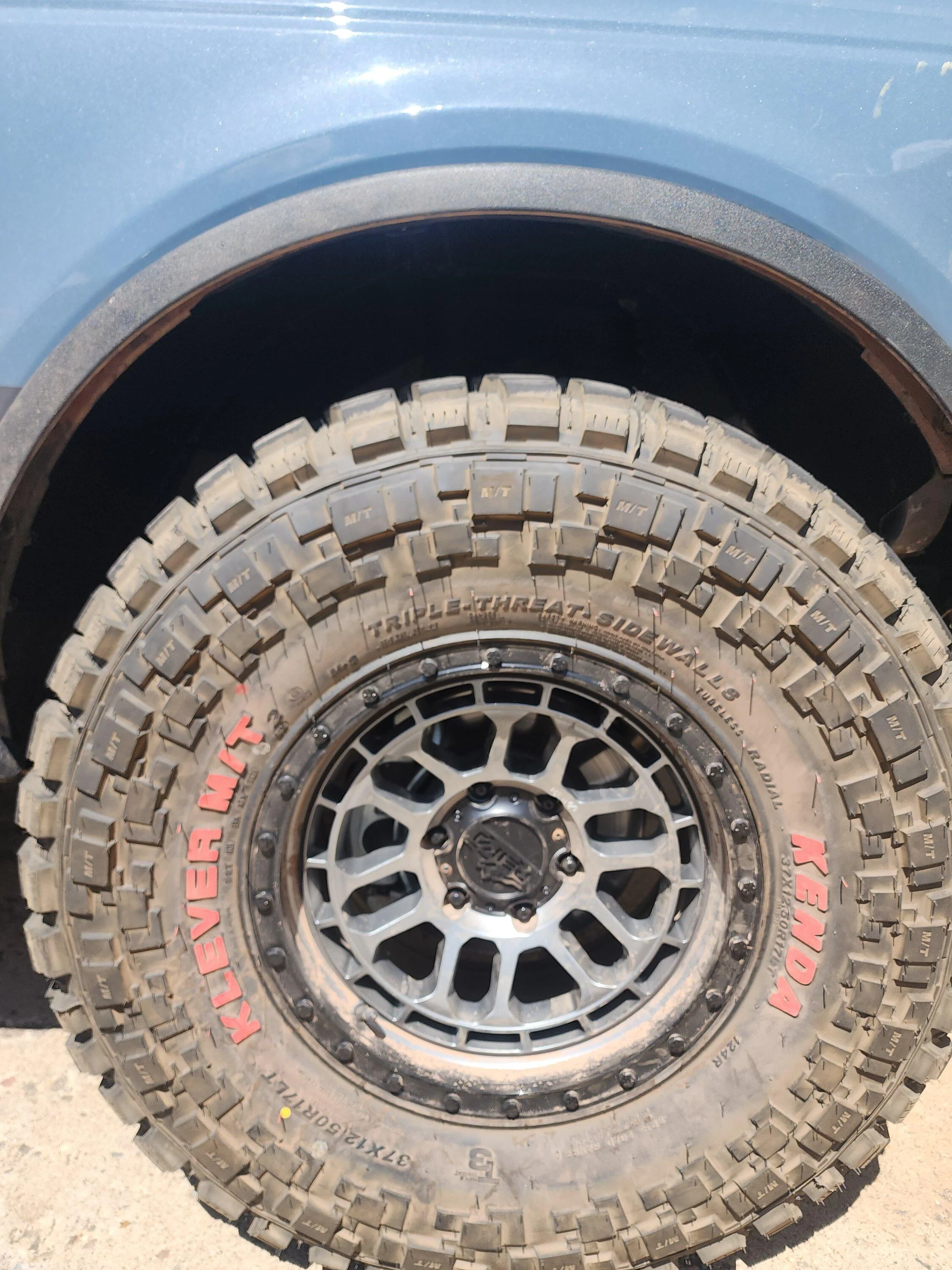

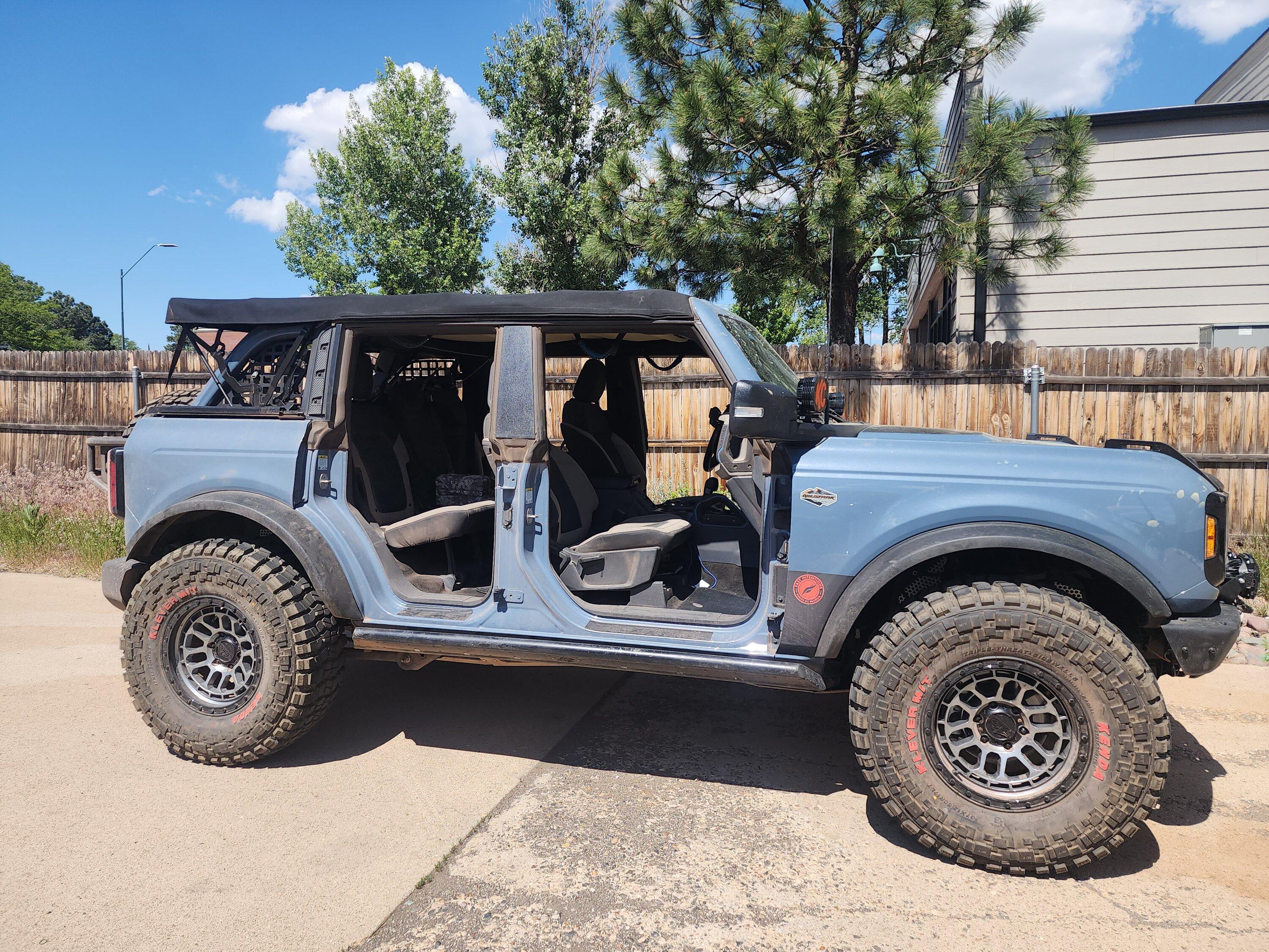

Thanks so much @Bikeric I was also considering the Kenda Klever, which I think is 10ply and a similar weight so I may go that route, many people on here seem to like them
I don't know if I'm Klever but the tires are. So far so good for me. Also the red letter ones are DOT compliant if you want that look. i don't believe most red letter sidewalls are DOT compliant as it's usually a racing only compound.
They stay relatively quiet on asphalt So Klever is aptly named. I met their Sales Manager once or twice great guy and happy to support them.
Ford Bronco Mickey Thompson Tires question 20230614_100823
Ford Bronco Mickey Thompson Tires question 20230614_100812 (1)
Ford Bronco Mickey Thompson Tires question 20230601_180802

OP: Did you end up going with the Mickey Thompson Baja Boss? The difference I see from MT’s website is the STD rated ties are not 3PMS rated and have a 60k mile tread warranty, whereas the LT rated tires are 3PMS rated and have a 50k mile tread warranty. Also, both STD and LT rim width for 285/70/17 show as 8.57 - 9.5” and I’m wondering if these will mount up to the Big Bend rims since they are 7.5”. MT does list a LT255/85/17 and shows rim width to be 7.06 - 8.0”, however a slight lift/level may be required for that height, not sure. I have narrowed my choices down to BF Goodrich KO/2 and the Baja Boss, and would prefer the Baja Boss for their rain performance advantage over the KO/2. Thanks!
