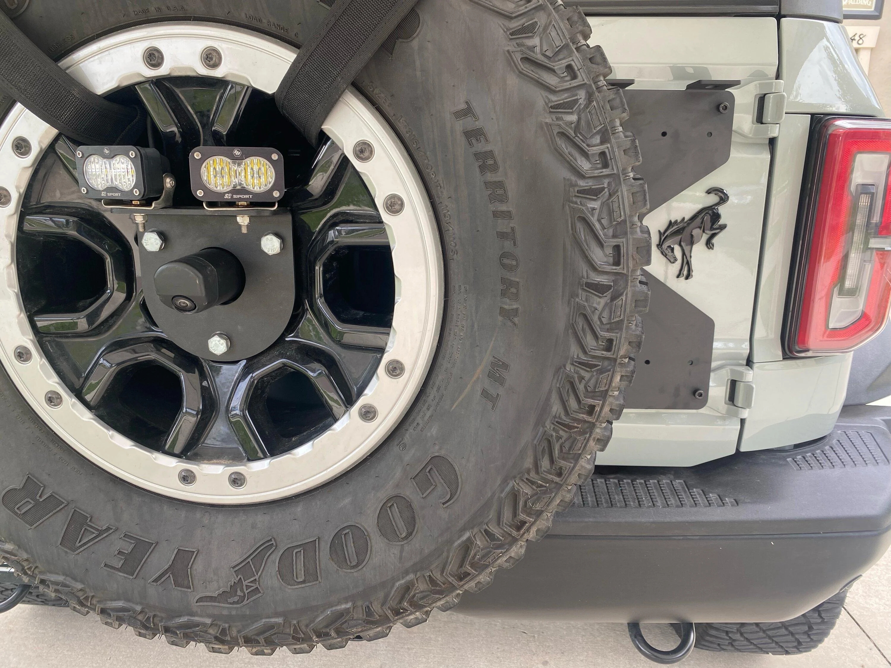

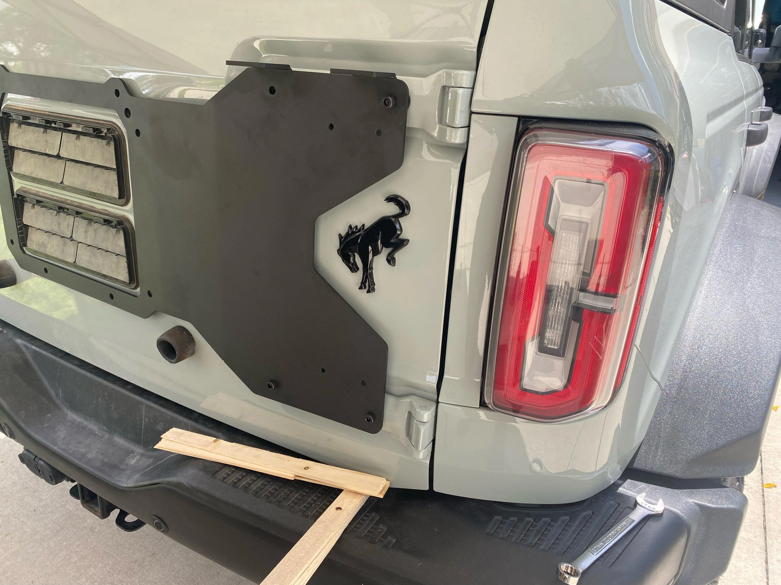

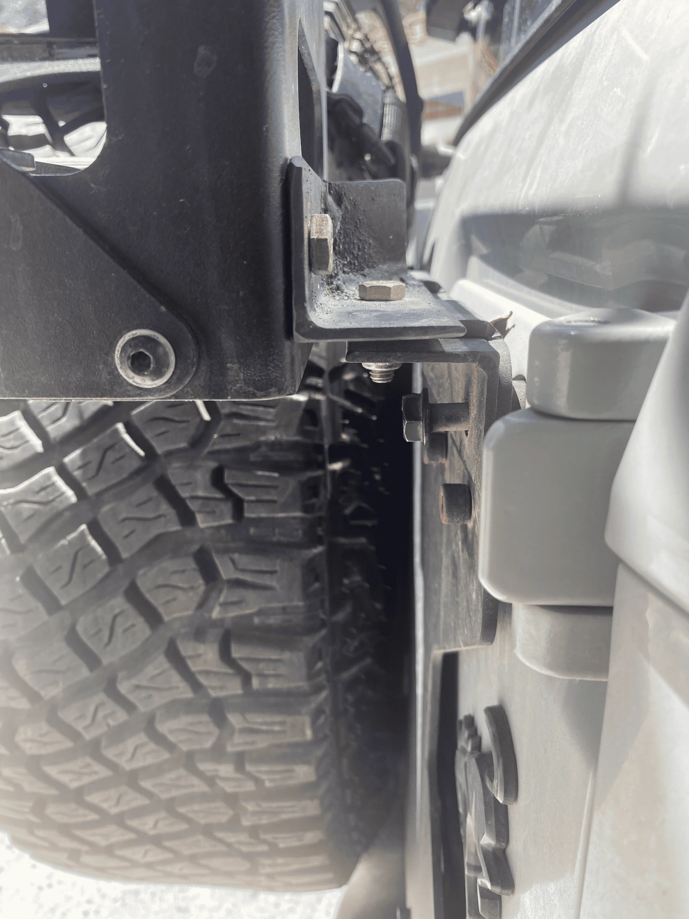

Been awhile since my last update. Will do a few posts with some of the previous projects.
Just mounted the Allied Expedition tire reinforcement bracket.
Ford Bronco Meet MOON IMG_1029
Ford Bronco Meet MOON IMG_1030

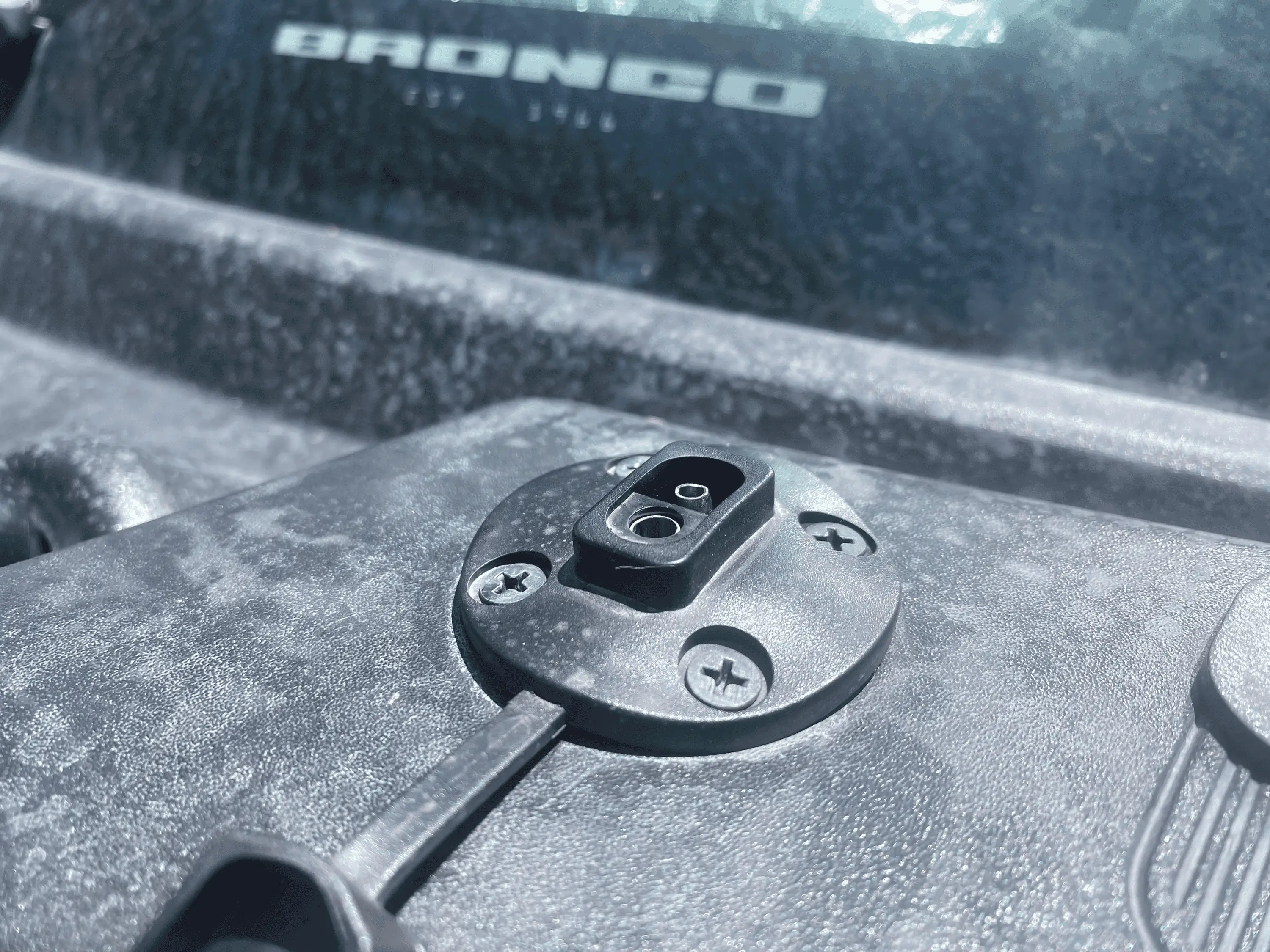

SAE Solar Input
I installed an SAE plug near my mirrors so I can easily plug in a solar panel without having to crack a window or open the door. This is wired in to run directly into my Bluetti EB55 battery which powers my fridge. So when at camp I can set the 200w Bluetti panel on the roof or off to the side depending and get power into my system.

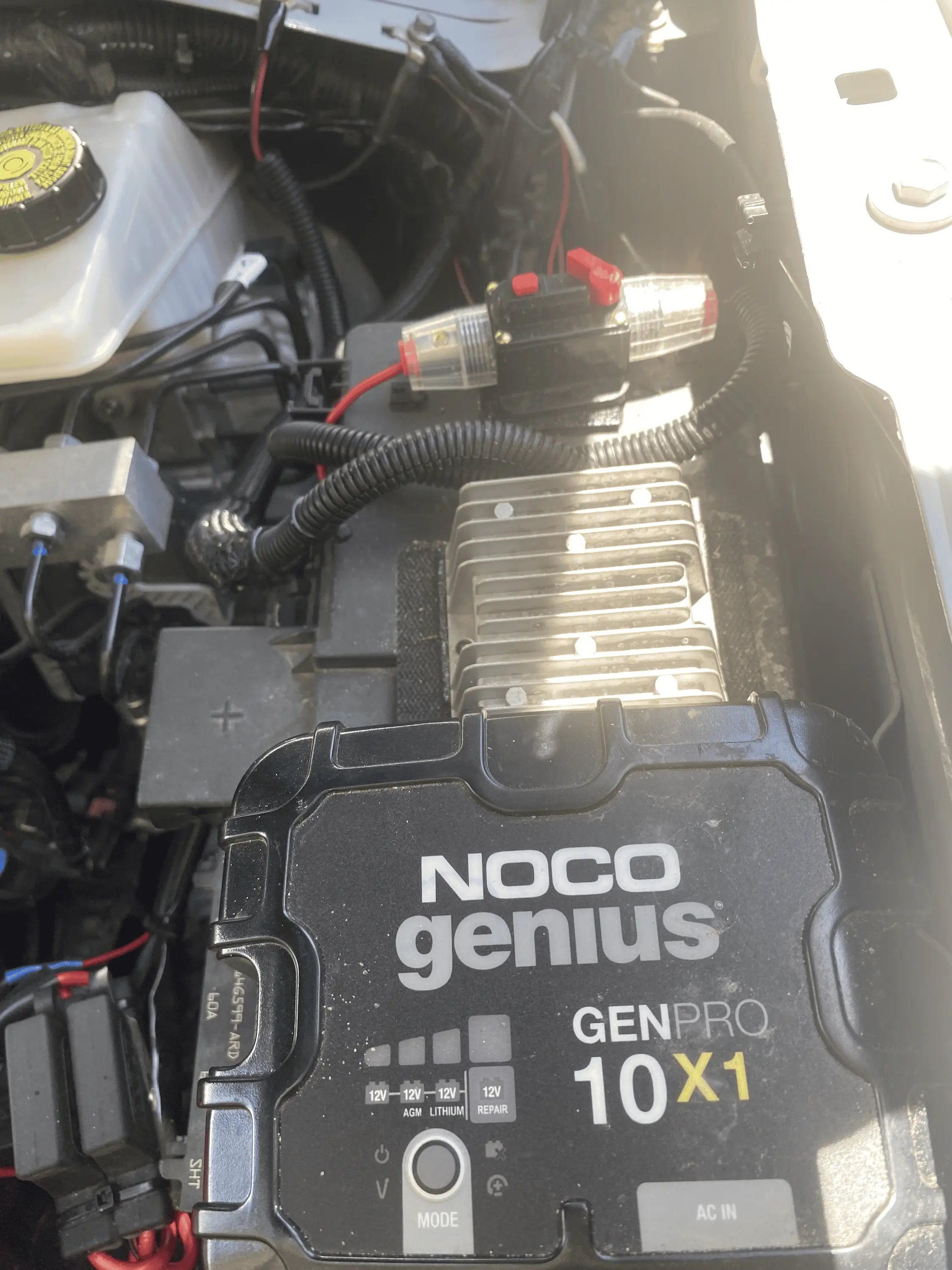

24V Booster
I installed a 12v to 24v 10amp booster. This is also wired into my Bluetti EB55 so I can duel charge the battery with both AC and DC power at the same time and getting a combined 380watts into the battery. Compare that to maybe just 60 watts input that most people get from only charging their battery from their cigarette plug.

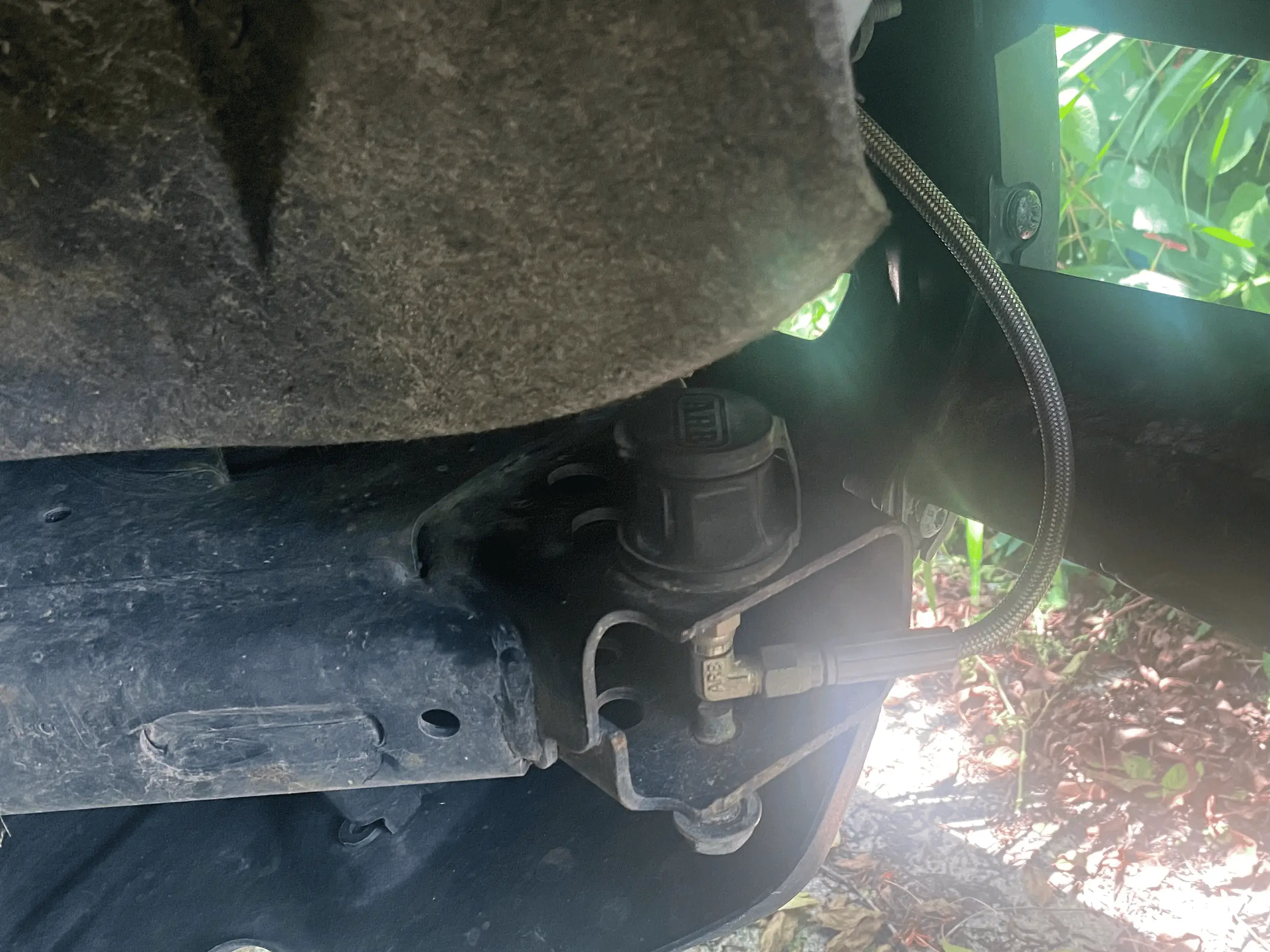

ARB Air Chuck
I relocated the air chuck from directly on the compressor which I learned you shouldn’t plug directly into it and should have at least 12 or so inches of metal braided line to cool the air off first.
I moved it down behind the grill on to one of the crash bars. There was already a hole there but had to enlarge it a bit. It’s somewhat of a tight fit to plug the line in but it works for now and is tucked up out of the way.
I also relocated the switch inside so now I can turn on and off the compressor and plug the air line in without having to pop the hood.

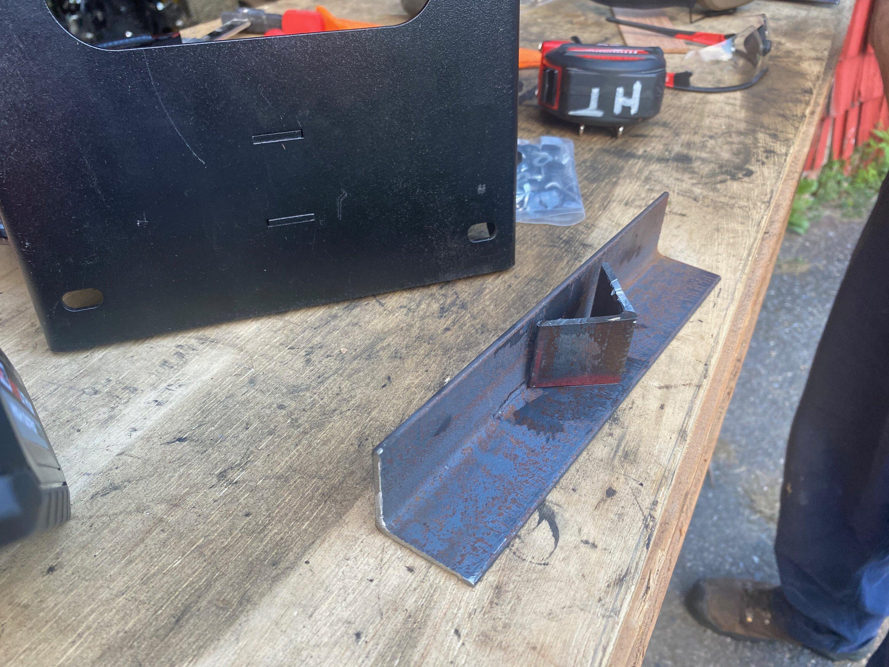

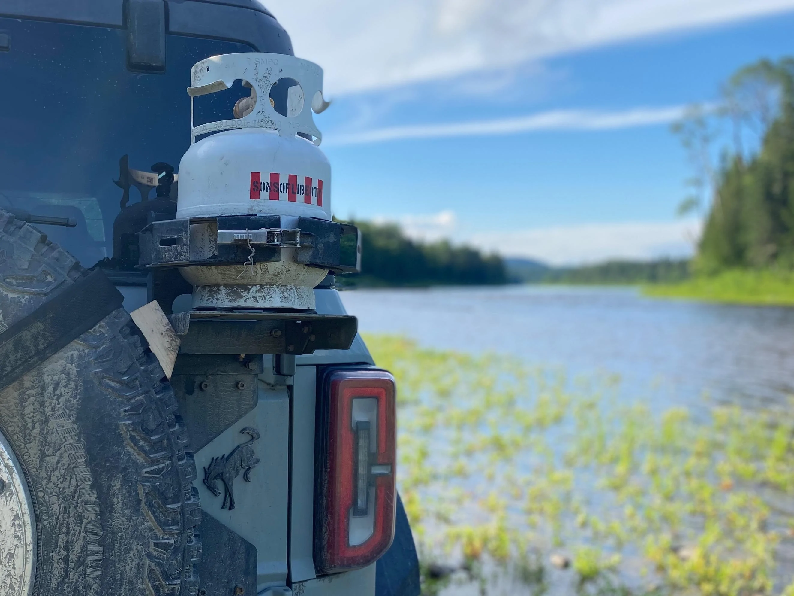

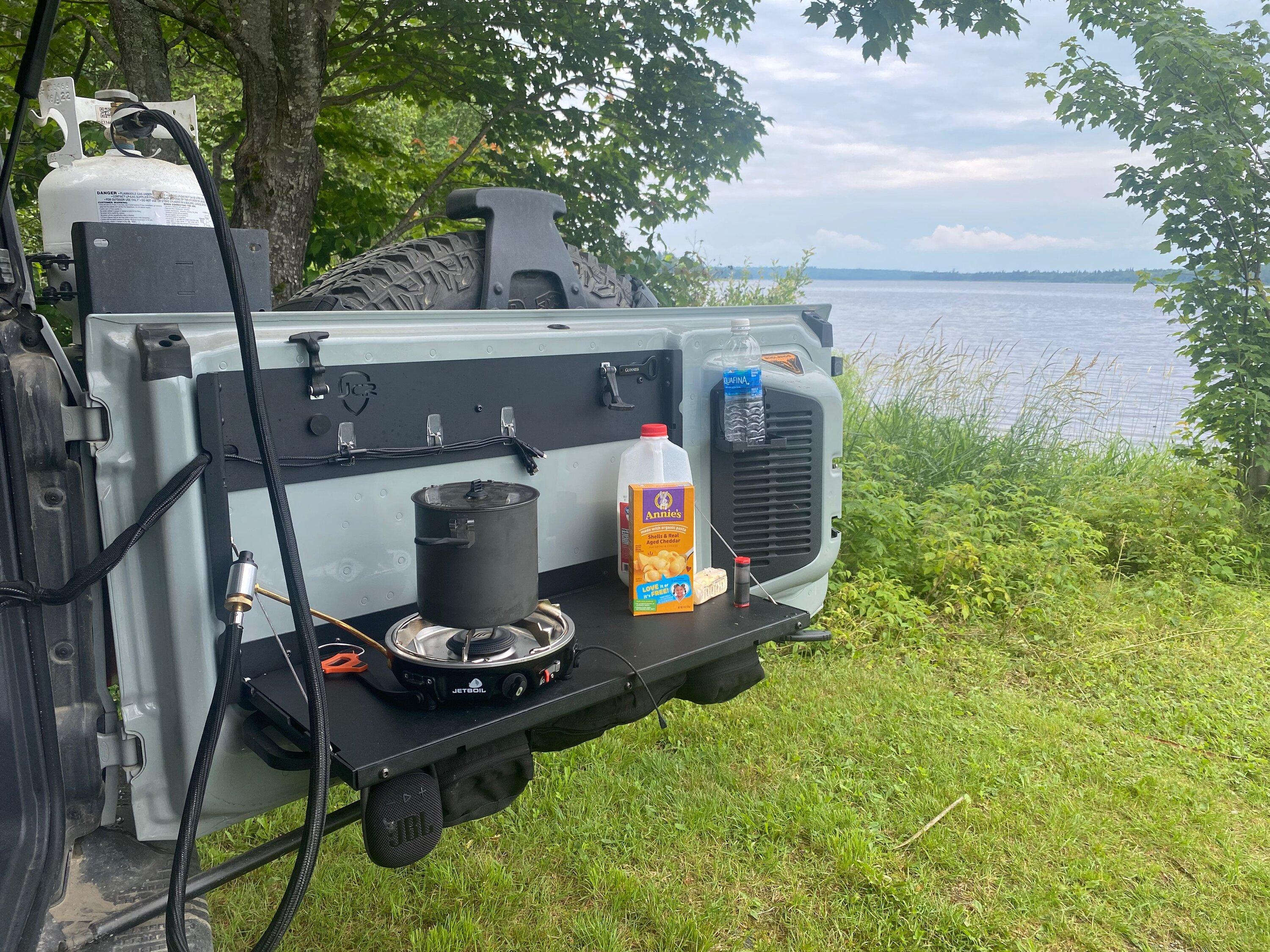

Propane Tank Mount
This was one of those projects that kind of just came together and everything seemed to work out and fit perfectly.
I was planning to get a propane tank mount and attach it to the side of my tire with a bracket. I decided to randomly check Craigslist to see if anyone had something used for sale. Thinking this was an absolute one in a million chance. I came across the Front Runner propane tank mount locally in the same town my buddy lives in. I didn’t even know they made one. So I picked that up for 1/3 of what it costs new.
On the Allied Expedition tire reinforcement bracket there are two tabs at the top for antennas. My dad suggested I place the propane tank on it to see if it fit and sure enough it was perfect! I sat perfectly across the two tabs. So all I needed to do was come up with some way to attach it.
When I was in Maine my uncle and cousin helped come up with a design. They created a custom bracket and then bolted everything together. I picked up a little rubber stopper and attached that so if the tailgate swings out past 90 degrees it will stop it from smashing into the body.
The mount is removable if I ever so choose. This frees up a lot of room in the interior from not having to have the tank inside. It also allows me to run a gas line from it to my Jetboil Half Gen and cook on my fold down table and not have to waste space with a 1lb tank.
For this trip I wedged a little block of wood between the tire and the mount to keep it from bouncing on dirt roads. This trip was 250 plus miles on logging roads in Maine so it was a smart move.
