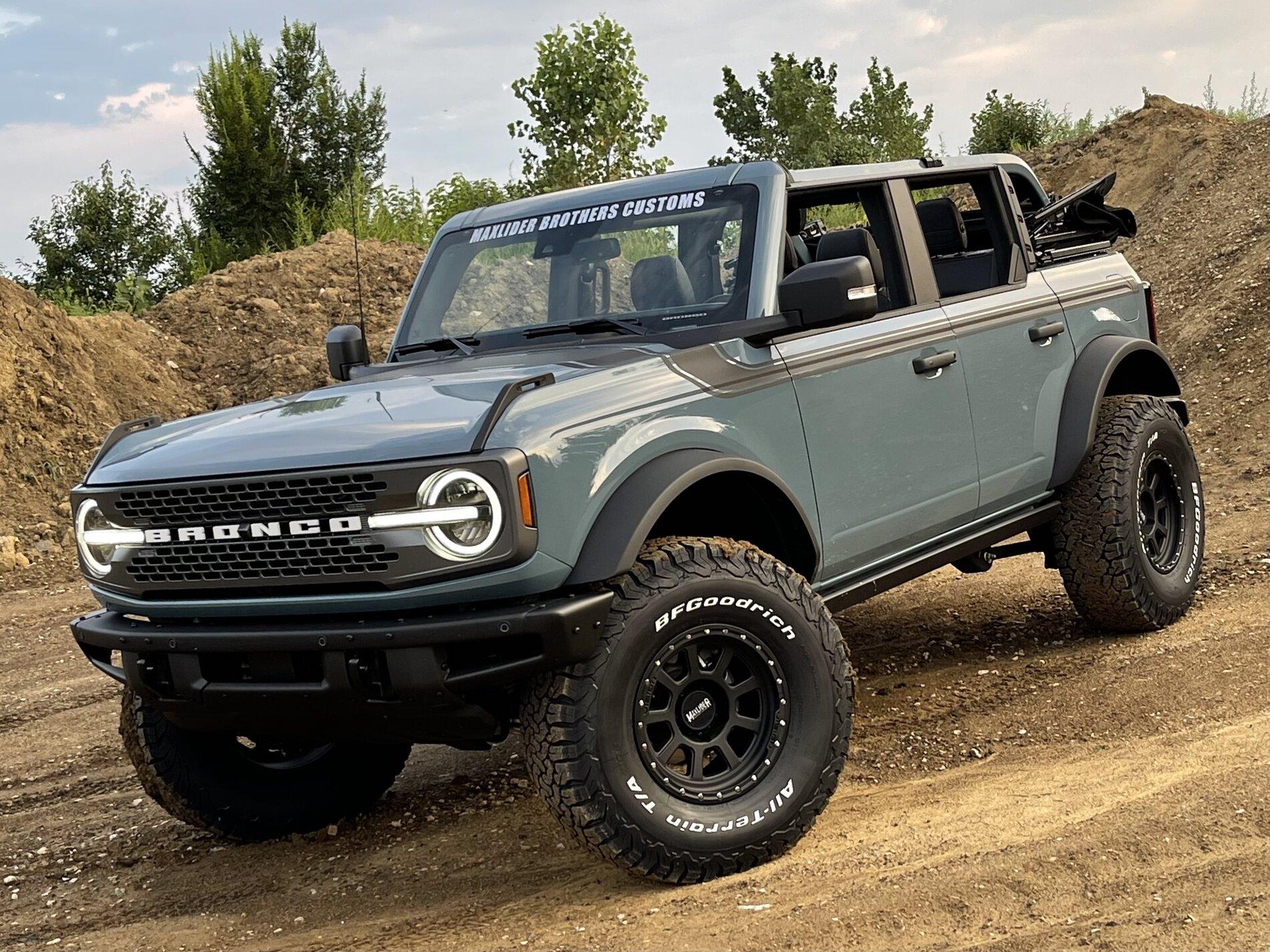

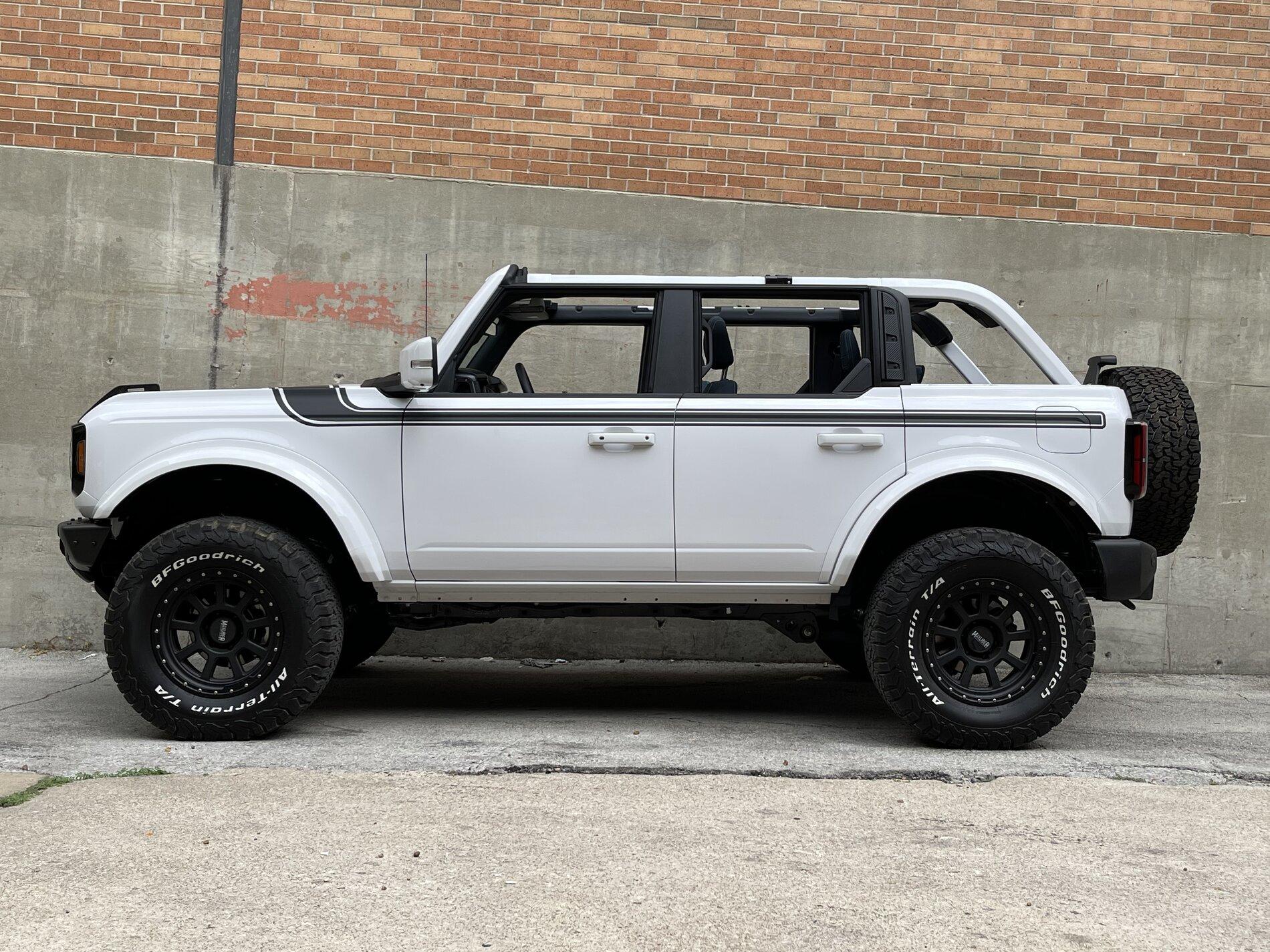

Our MaxliderBros Stage 1 lift kit is now AVAILABLE TO PREORDER!
2 versions of the Stage 1 lift kit will be available:
- Sasquatch
- Non-Sasquatch
Both kits provide about 4” of total lift and allow you to clear 37x12.5” tires even with -12 offset (on 9” wide wheel). Upper control arms with strut spacers use your factory struts…made by our friends at BDS/Zone!
Price is $1,299 which includes shipping inside the continental U.S.
Get on the preorder list by emailing: [email protected]!
Kit should be ready to ship in next 7-10 days!!! SUPPLIES ARE LIMITED FOR THIS FIRST ROUND!
Stage 2 kit with Fox coilovers on all corners will be available in a few months.
NOTE: 37” on Area 51 and 35” on White below.

Wow, that white one looks dope. So this is a spacer AND an UCA setup?
